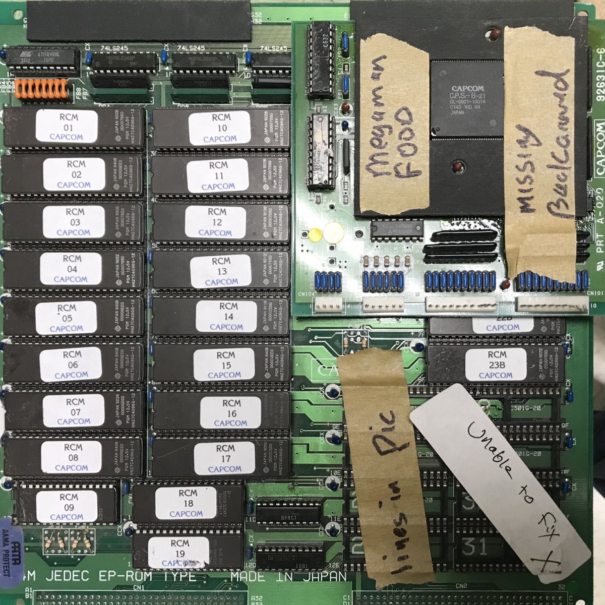

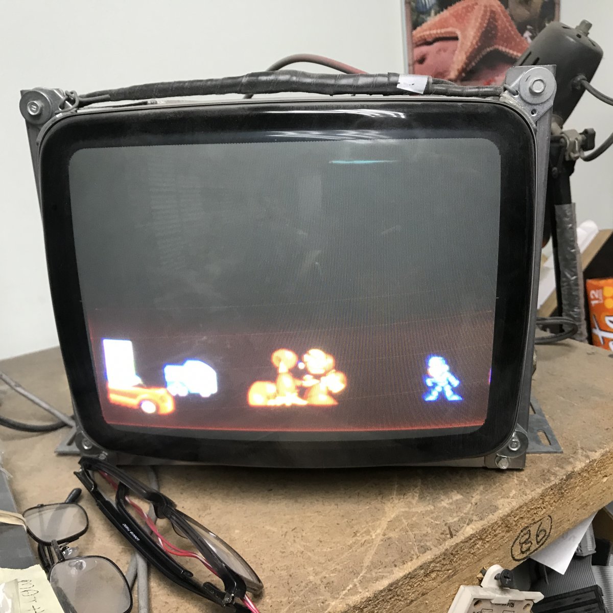

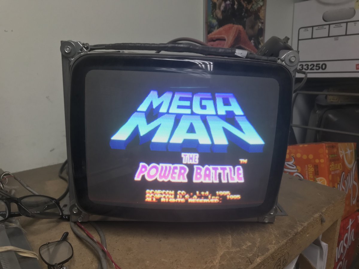

Hi, I know someone who is selling this MegaMan the power Battle board and Im not sure what’s wrong with it or how to fix it. There are lines going horizontal across the screen and there is no background. The audio seems to be good but I’m new to arcades and am not sure where the problem is in the board or how to fix it. Thanks for any help you can give me. I’ve added some pictures of the board and it playing on a monitor.

Part of the problem could be the chunk missing off the corner of the C board custom. And/or whatever forceful impact caused that damage likely caused other damage
But, as with every other thread on here asking about graphical problems, the most likely culprits are one or all of the following: faulty C board custom (seen in pic), faulty A board custom, faulty mask roms.
Yep, very likely it’s the damaged B21 on the C board pictured. Fortunately the B21 is the most common C board to find a replacement for.
