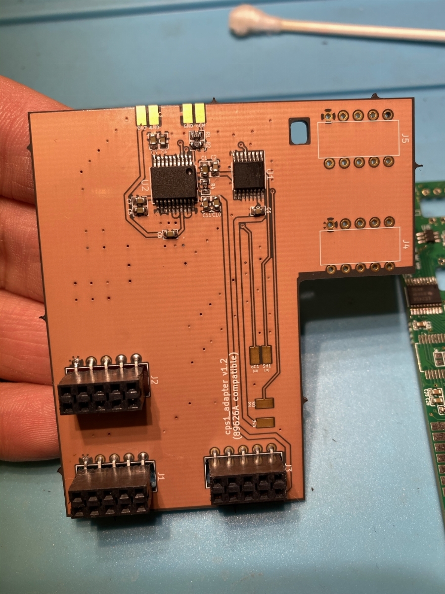

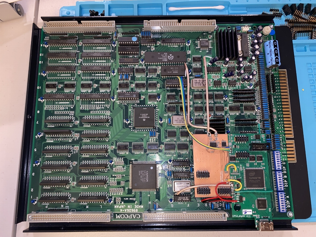

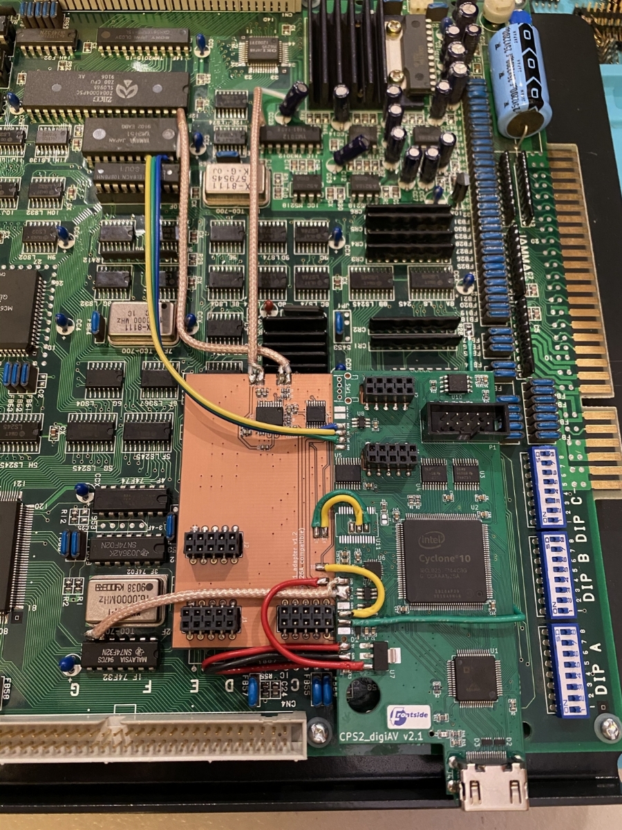

I built the daughterboard from the files, and have everything connected. Once I realized I had the CSYNC(HS) wire on the wrong side of the resistor video came up working great. I noticed an issue with Audio though. Music and some sound effects work, but I think that samples aren't coming through.
Does anyone have an idea of what wire/pin could be an issue to make it so that JUST the samples weren't coming through HDMI? They come through the JAMMA edge just fine.
