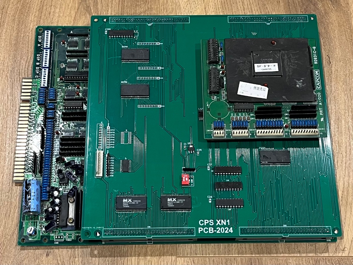

Well I got exactly what I deserved :D looked promising on first inspection:
But when I fired it up the video was rolling, and half the sound / music was missing.

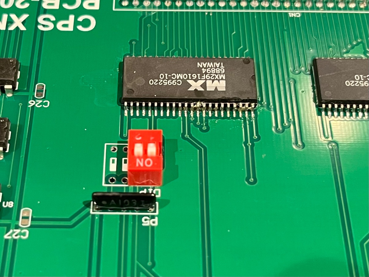

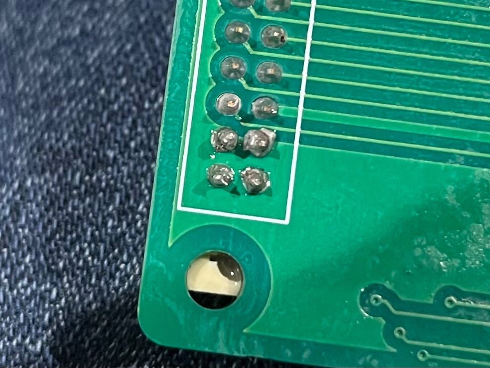

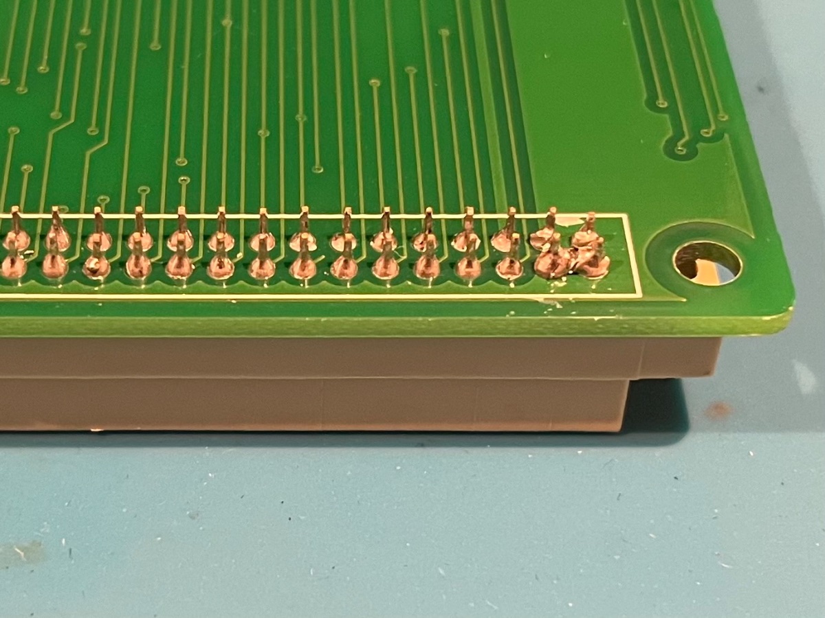

Upon closer inspection, some classic Ali Express soldering:
X( I managed to sort out the connector using some flux, but the chip is out of my skill range.

Ugh, the soldering job on the MX flash chip is awful with all the bridged pins. Did he even test it to see if it works before shipping it out? That's likely the cause of your missing sound and music. I wouldn't expect it to cause your picture to roll, but if the solder bridges are sending cross-signals to the video processors, then a rolling picture could be a side-effect of that.
