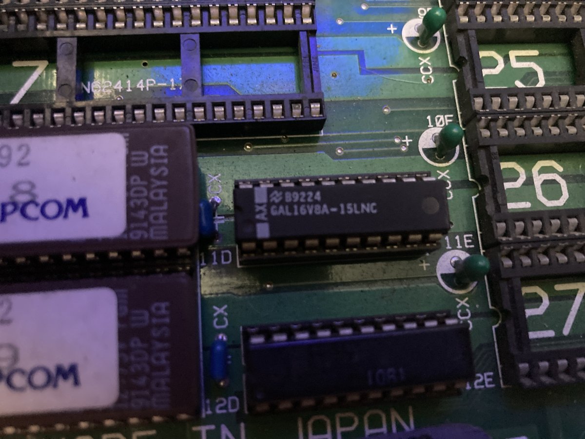

So i just recently picked up a CPS1 board that had the rainbow roms in place. It worked just fine, but I had no desire to keep rainbow edition on this board. So I decided to convert rom 21-23 into Hyper fighting. In order to change those roms I had to remove the C-board. This C-board was quite difficult to removed, almost like it hasn't been removed since 1993. After a little bit of force I got it off and replaced the roms. Assemble it all back together, but now the board does not boot, just a black screen with red squiggly vertical lines. I thought maybe I burned the roms incorrectly (27c4096), so I re-burned them using a different rom chip (27c4002). Still no difference. So then I tried putting back the rainbow roms, but I am getting the same thing now...black screen w/ red squiggly vertical lines. My initial thought is I flexed the C-board, causing some broken traces or solder joints, but I can't seem to find any. Kind of sucks, thought this was gonna be such a simple swap
Anyone got any ideas?
