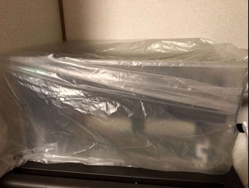

How do you go about ensuring the vinegar doesn't get all over everything? Trying to figure out some kind of contraption with a garbage bag that will work in my apartment lol.
Edit: I just realized I have a ton of PCB feet. I suppose I can put them on and then have the board sit above a small pool of vinegar. I'll go grab a plastic container to make the pool, close the lid, then bag it. That may work.

The experiment begins! I’ll open this on Christmas. 12 days will hopefully take care of it.
Result: failure. The vinegar ruined the board. Condensation went to town and ate away damn near half the JAMMA edge along with a whole lot of wonderful black stuff all over various places on the board. It was in for one week. Cleaned it real good and then tested, made a sound I didn't like followed by a voltage drop on my harness display. No B-board was plugged in at the time. I decided to re-tin the entire JAMMA edge with the soldering iron. The sound was gone, so I decided to test out a B-board. Green screen. Another B-board same result. I really don't have the patience to mess with it right now so I ordered a new one. I'd like to see if it's salvageable later, but yeah, don't do vinegar in a bag......
Rice vinegar. I didn't dilute. Didn't know I needed to. In any case, the boards fucked. Moving on.
