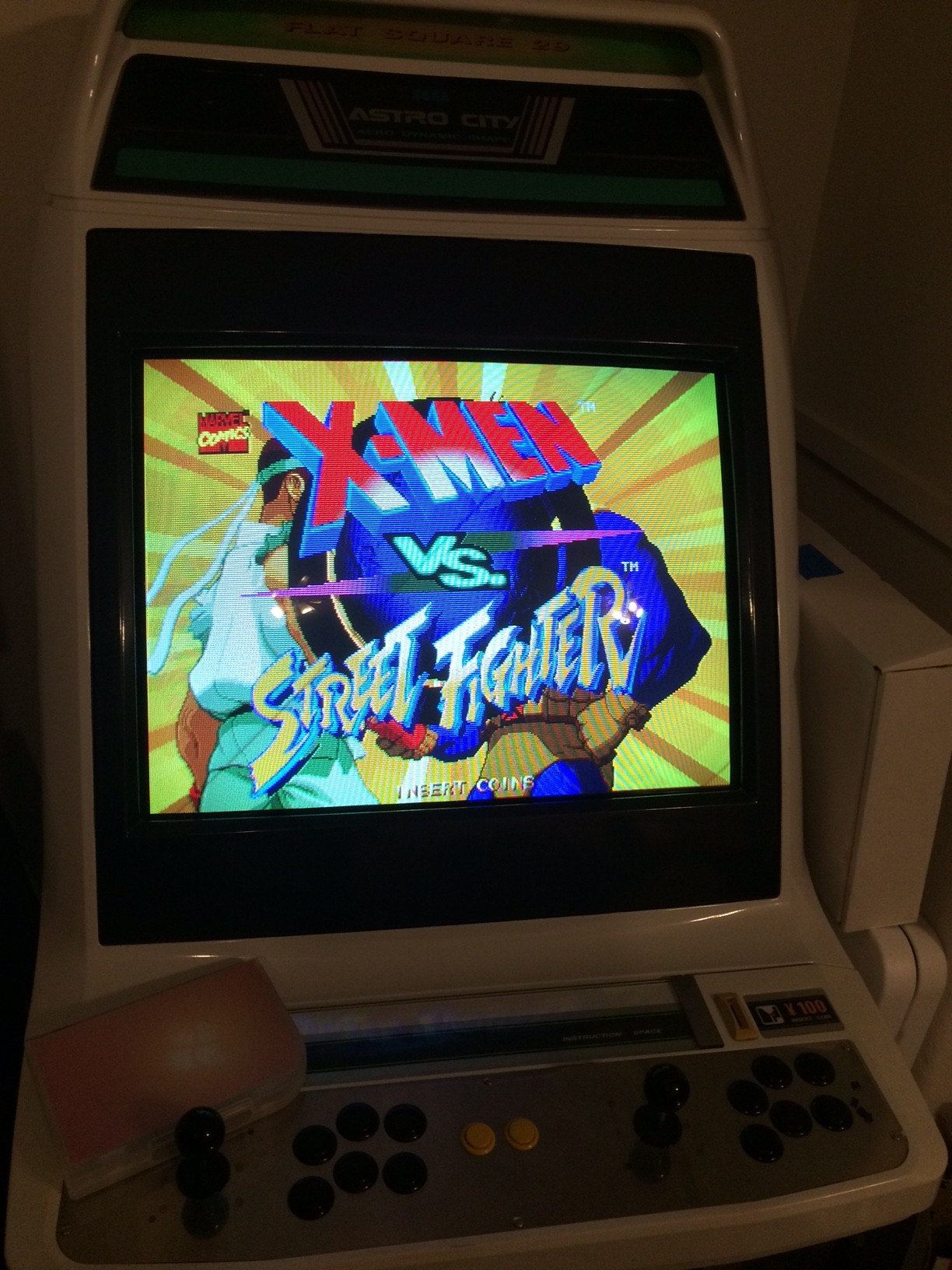

Red screen can also be a seating issue between A and B
You sir, are a genius! I decased the B-board so I could insure the connection to the A-board was secure. Thumbed down the EPROM's again while I was in there. And viola!!
Messed around and resurrected my first ever B-board! It's been a pretty frustrating week with this nasty heat wave and issues with AW2Naomi games booting to a black screens, nasty sounds coming from my CPS2 multi. Nice to have a breakthrough for once. Many thanks to Team Avalaunch for their pro bono work and to @Dr. Willy for the deal and superfast shipping on the A+B boards. Now that I know the B-board works, time to move it to the highest config first to test if my CPS2 multi is defective, then on off to its new life as HSF2A!
