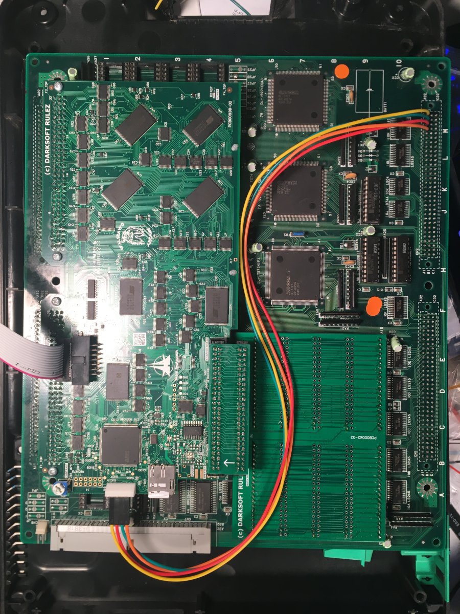

I've spent some time trying to have my CPS2 working properly, but I can't find what is the issue preventing some games to work properly. It can range from missing sound, garbled graphics, crashes and so on...
I bought separately an A board, a B board (blue case, X-Men: Children of the Atom) and a Darksoft CPS2 multi.
It seemed to work without the CPS2 multi (but I've played the game only for a few minutes, so I'm not totally sure).
Then I installed the multi kit, soldered the key writing wires and tried to run some games. Some of them work (those with the smallest ROMs). Some of them seem to launch properly but then crash when you try to play (it always crashes at the same moment though). Some others don't even launch properly.
For example, if I try running SSFII X, I get this:

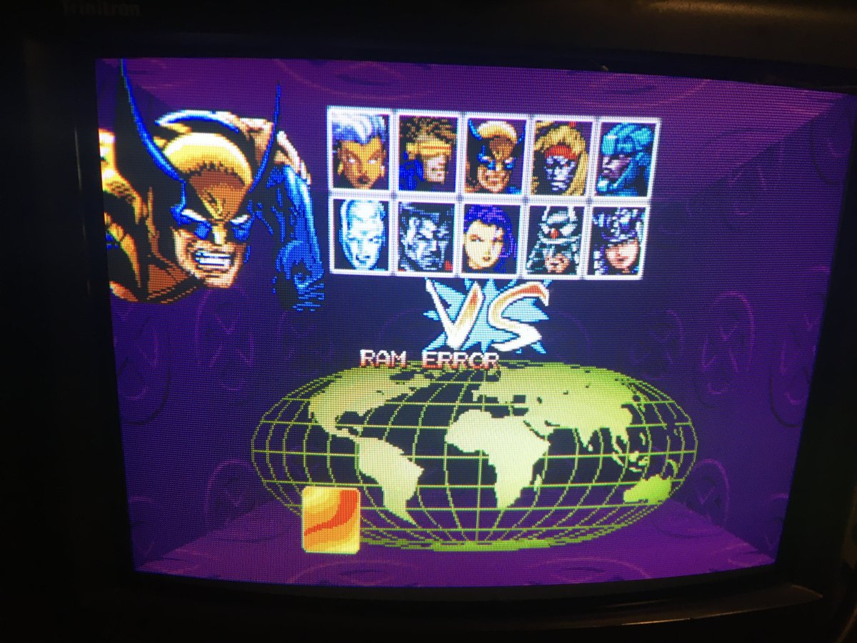

I've also tried to run the original game of the B board from the multi kit, but I get this after pressing start:
I've run the flash tests for the multi kit and it was successful.
I've checked for bent pins on all connectors.
I've tried electronics contact cleaning spray on all connectors.
I've checked if all the connectors solder joints are ok, then I resoldered everything anyway.
Nothing has changed.
I've concentrated mainly on the connectors because this feels like some of the connections between the multi kit and the B board or between the A and B board are not working.
I'm posting this because I don't really know what I should be checking for next to find the source of these issues. I don't have access to another A or B board.
Could someone help me please? Thanks.
