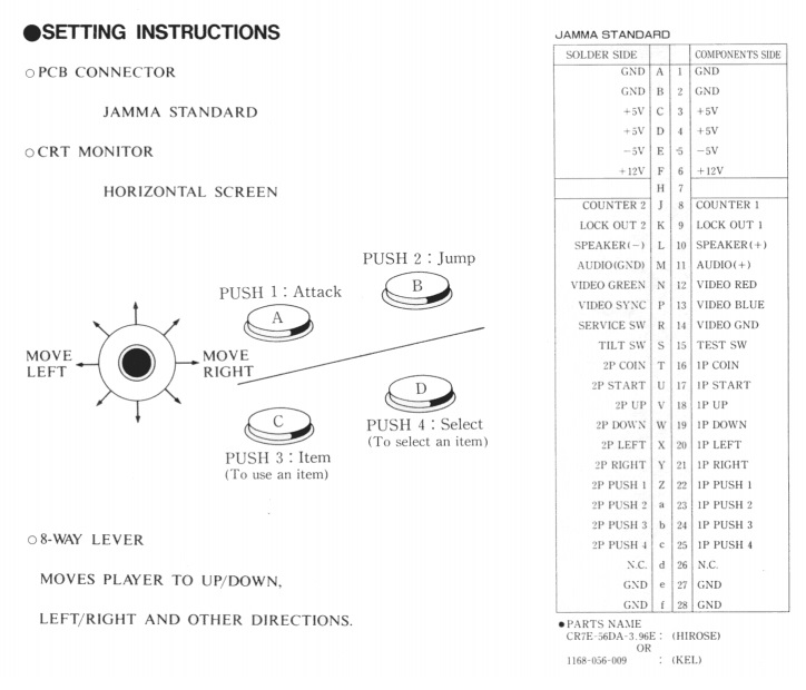

ok I have a blast with a cps2 kick to blast io

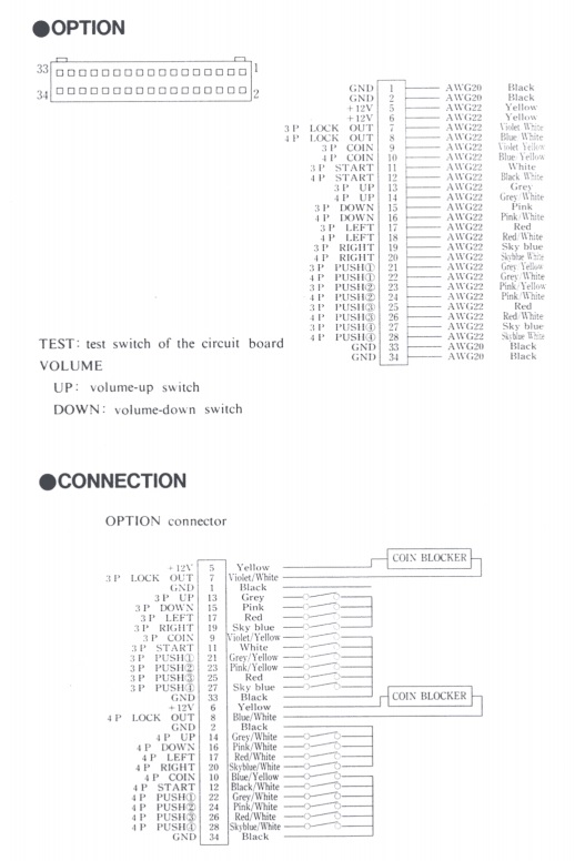

Every game work except dndtod my 4 5 6 are going to 3rd player
well yes, that is because DND is a 3 player game.
Button 4 for both P1 and P2 are on the Jamma edge
Jamma connector
3/4p connector
yes you should, just connect your kick connector to the Atlas and you have button 4 on the Jamma edge :)
