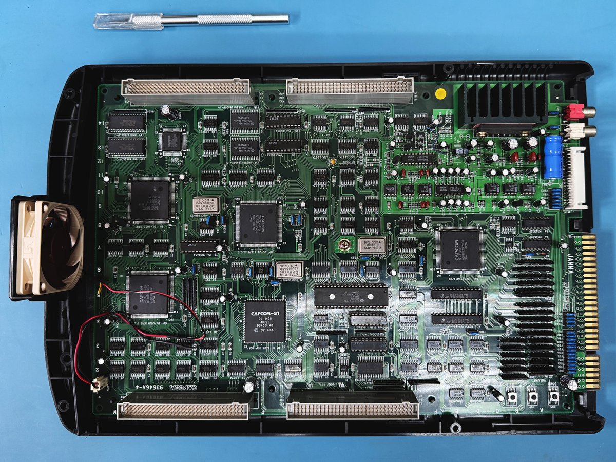

I recently got my hands on a Japanese A board and a Japanese B board for the Street Fighter Zero 3 game. I don't believe either has been recapped but the B board has had the original battery removed and replaced with a battery holder and a new battery inserted in 2020. I have an appropriate Jamma harness and for video I am using a VGA converter and outputting to an 1280x1024 LCD panel. For audio, I am using the L/R audio connectors on the A board and sending it to an amplifier with two speakers attached.
On a cold boot, everything seems to work fine. The game boots, I get video and audio, picture looks great and the game seems to work.
On a subsequent power cycle, the system will not boot. Fan goes on but no video and no audio. It doesn't seem to be booting. I have to pull power and leave it for 3-5 minutes and then if I power up it works again.
This doesn't seem normal to me but since this is my first foray into these old arcade games, I thought I'd ask. Given the symptoms, I'm assuming it might be capacitor related but normally I see issues with cold boots, not warm boots when it comes to capacitor issues. Anyhow, I know my way around replacing capacitors/fixing PCBs as I have spent time restoring vintage computers. I have replacement caps/super cap for the A board and will be replacing those soon.
For recapping the B board, any extra precautions given the suicide battery? If I leave the battery alone while I'm removing/replacing the caps on the B board, should everything go ok? Just want to ensure I don't brick the B board.
