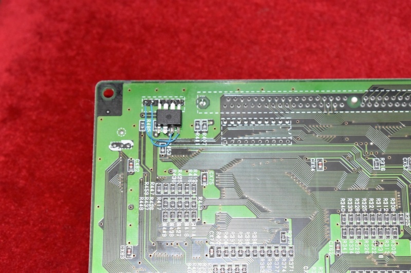

For those who are interested, I just upload hex files for pic12f675 allowing you to revive your CPS2 game
One hex for each game. Check the listing on the back of the page to know wich one to use.
Only 6 wires to solder !
Link :
https://github.com/ajefr/CPS2_Modchip
Check Eduardo Cruz blog for solder point on your game :
http://arcadehacker.blogspot.com/2016/09/capcom-cps2-security-programming-guide.html
Example of installation on a blackboard :
Have fun !

Can a PIC12F629 be use?
The only difference between 12F675 and 12F629, is that the former has ADC suport. I don't know if it is needed as the source code not available, so the only way to know is trying (they are rewritable PICS), or an aswer from @aje_fr. I would also like to know, as the 12F629 is cheaper, more available, and is the same PIC used to make Modchips for PlayStation, and Sega Genesis, so i have a buch of them around :P
