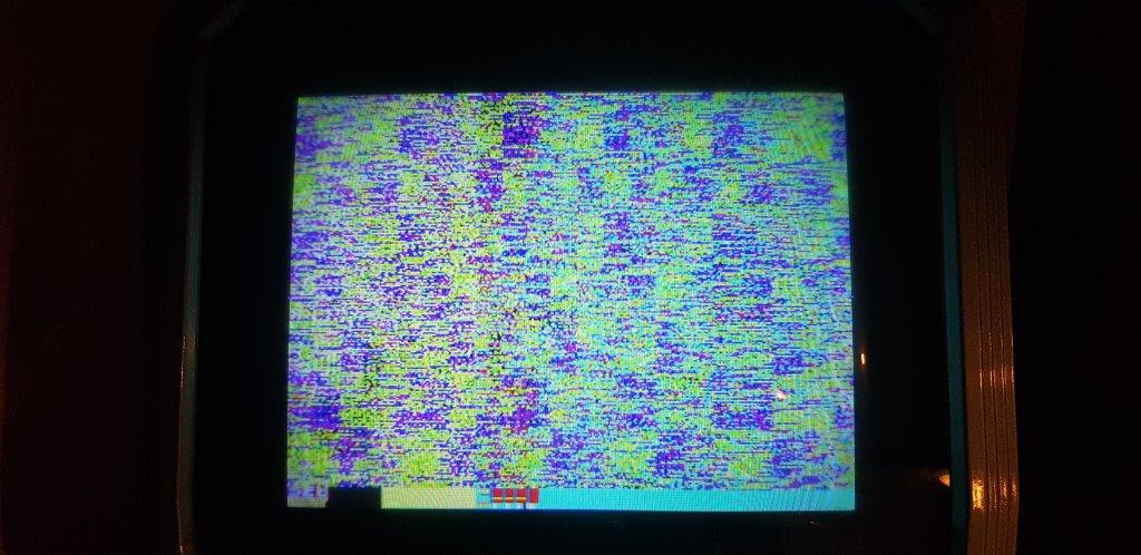

I have a Street Fighter III new Generation Cartridge that stopped working, Now it present a messed up screen:
Dead Battery??? Faulty Cartridge?
AS note the Board is working good with the SuperBios
likely a dead battery/cartridge. do you know when it was changed? Now is the point where a lot of these old games are dying. They say to change the batteries every 5 years to be safe, but i've changed games on 20+ year old batteries. There's a lot of variables I guess.
Time to convert it to SuperBios, cuz that battery is dead. There are instances where the cart will suicide if the cart is bumped while the board is on too. That's why some boards have the bracket that holds the cart down with force to prevent it from moving.
