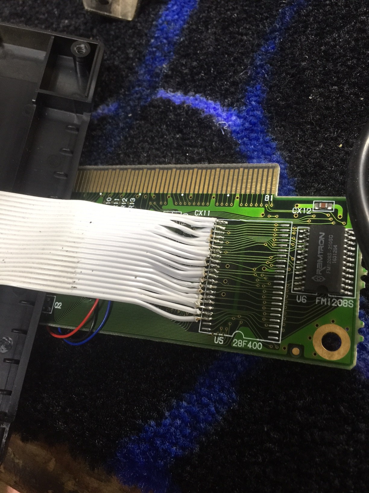

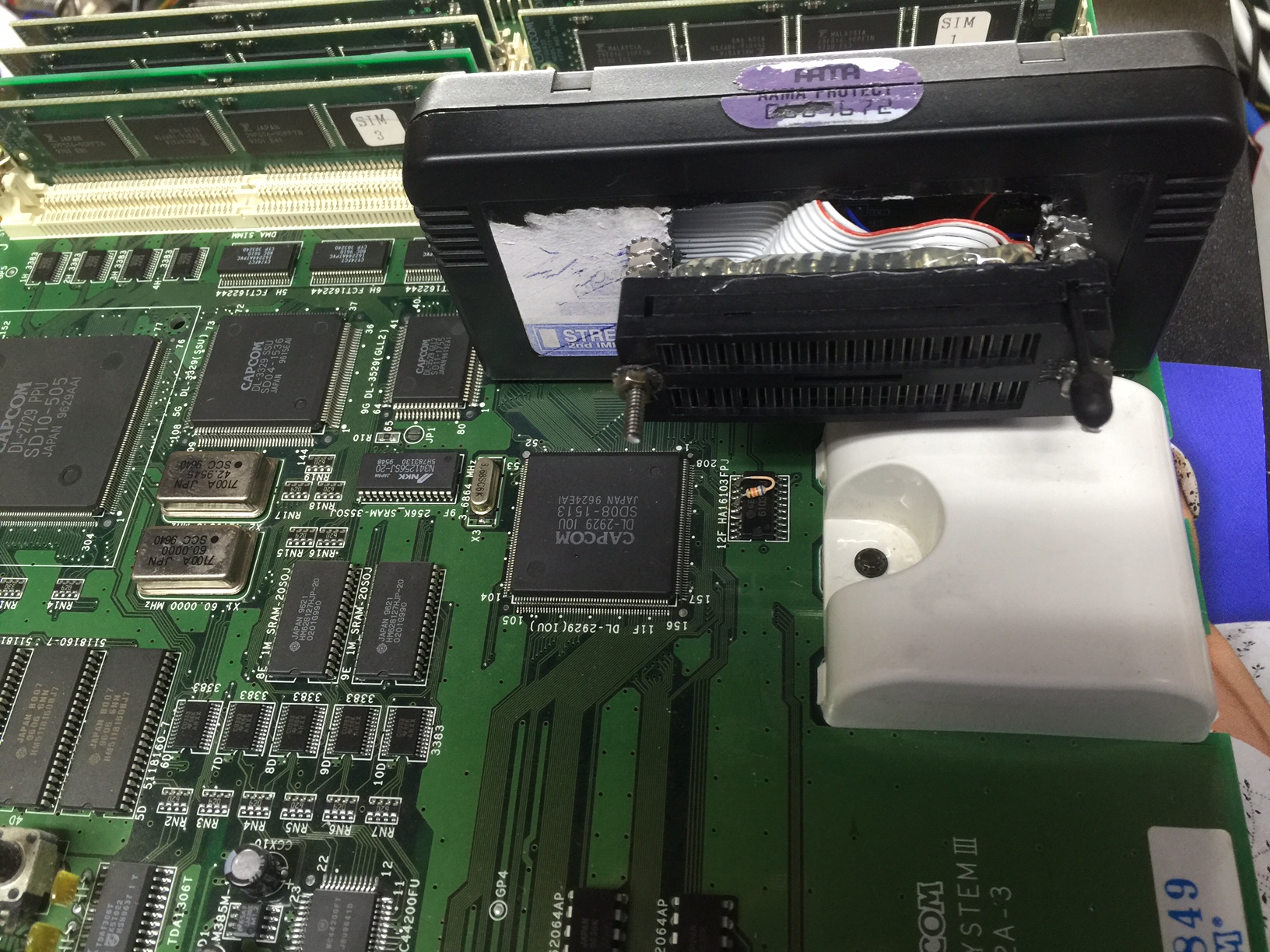

I was lucky enough to have an A cart that can take a 28f400. Seeing as I wanted to have easy bios swapping I went with the 40pin zif as a 27c4100 is pin for pin compatible with the 28f400 it was a simple task.
I wanted to post this to show it works with an eprom(I used a 120ns same speed as the original bios). Also to say that I can test new software with little effort and would love to help out.

A little ugly, but works.
