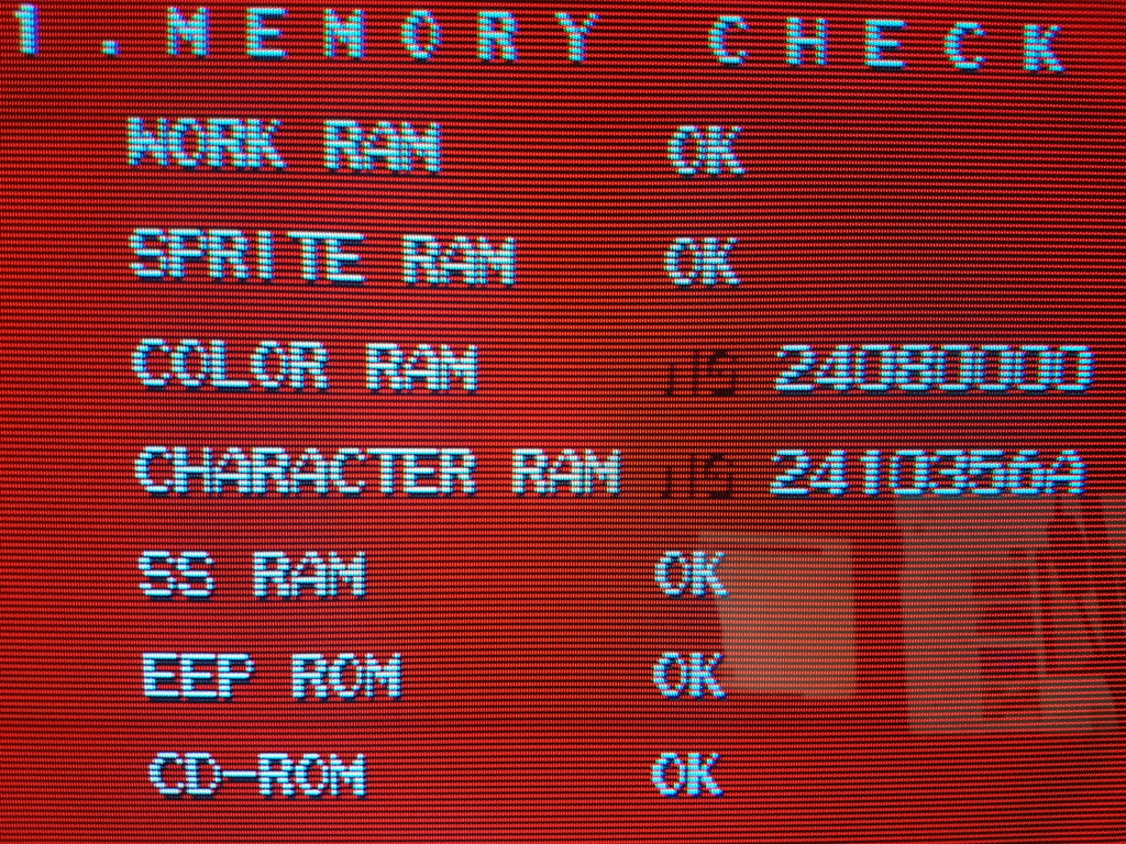

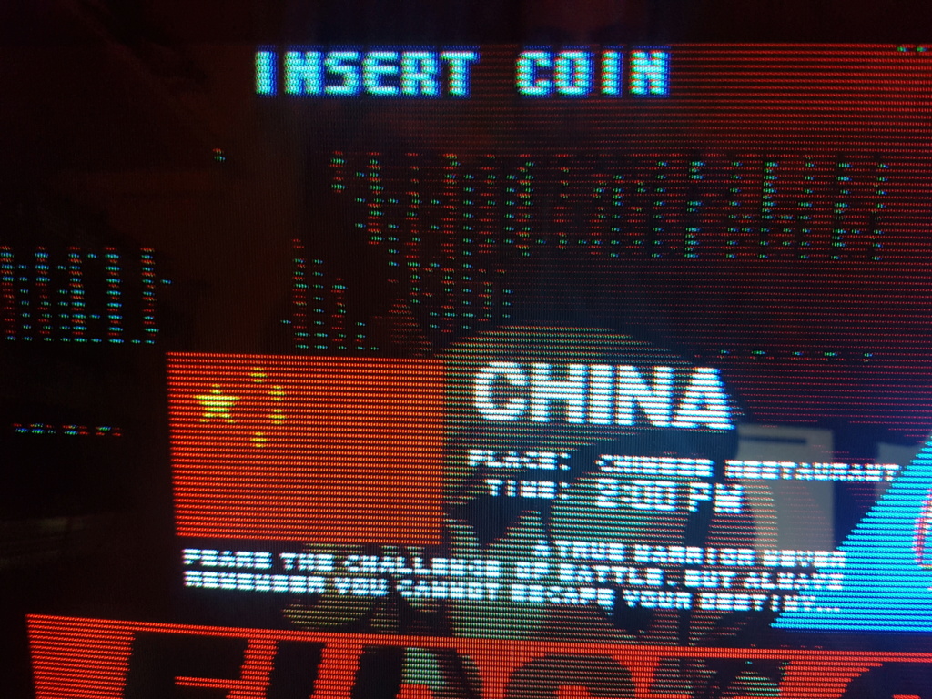

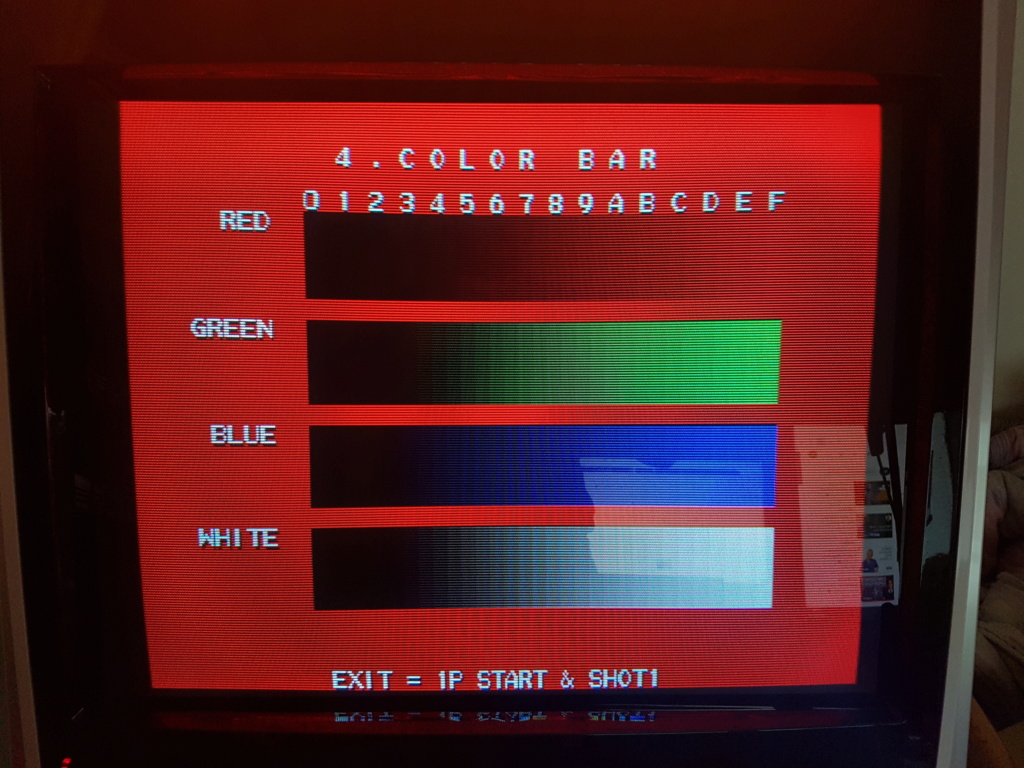

I have some of graphic glitch and colour issue with a CPS3 95682A-3 rev:
check's log:
It's seem a ram issue, is it fixable where find ram for cps3. last thing a little oxydation ppu side here:
