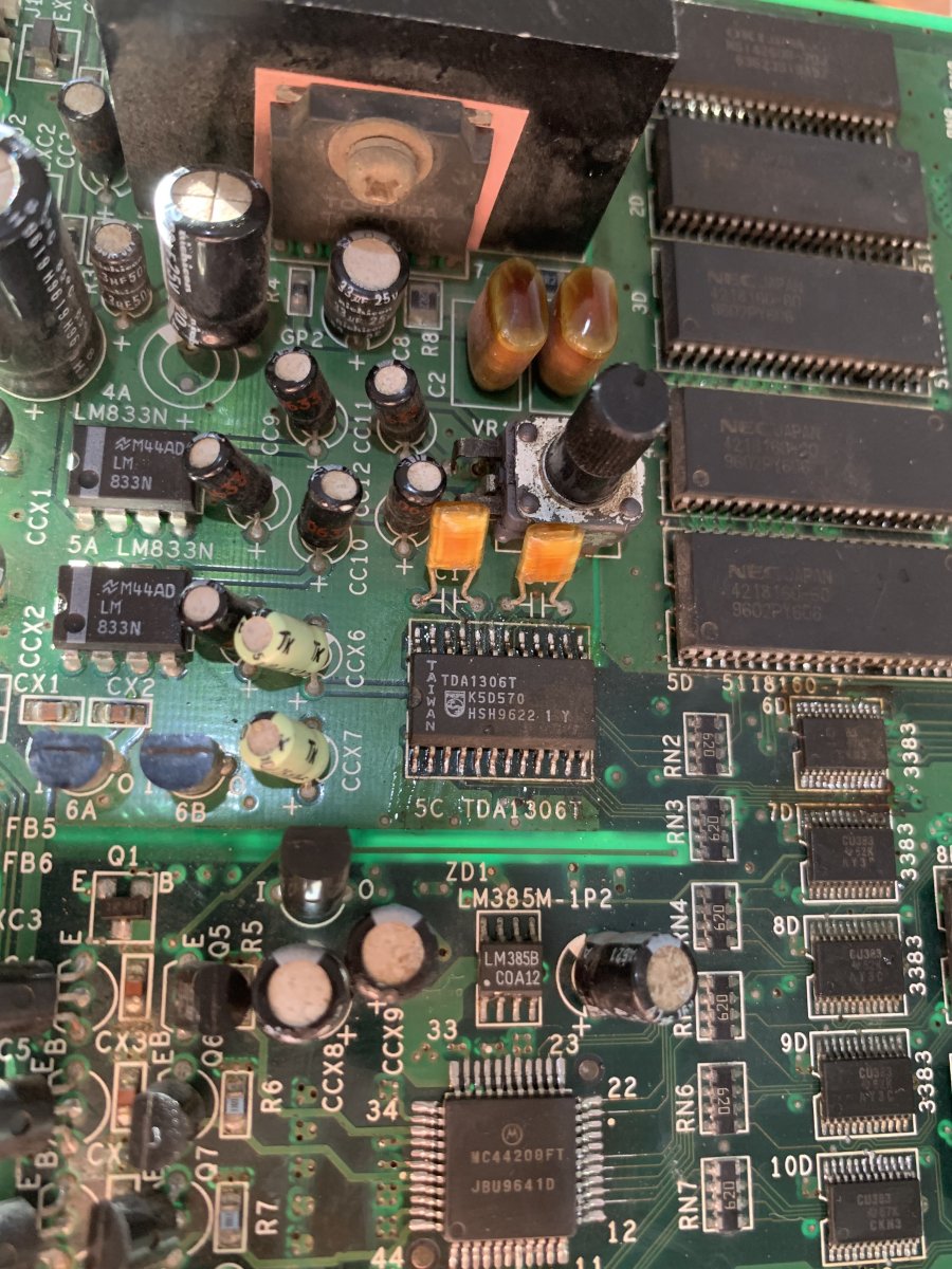

The sound repair :
1- replaced the potentiometer all tho i tested it with the multimeter and it checked fine but i wanted to rule it out
Result : no sound
2- replaced the TDA1306T
Result : Again no sound

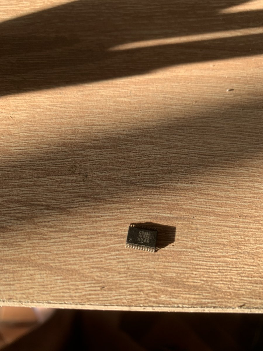

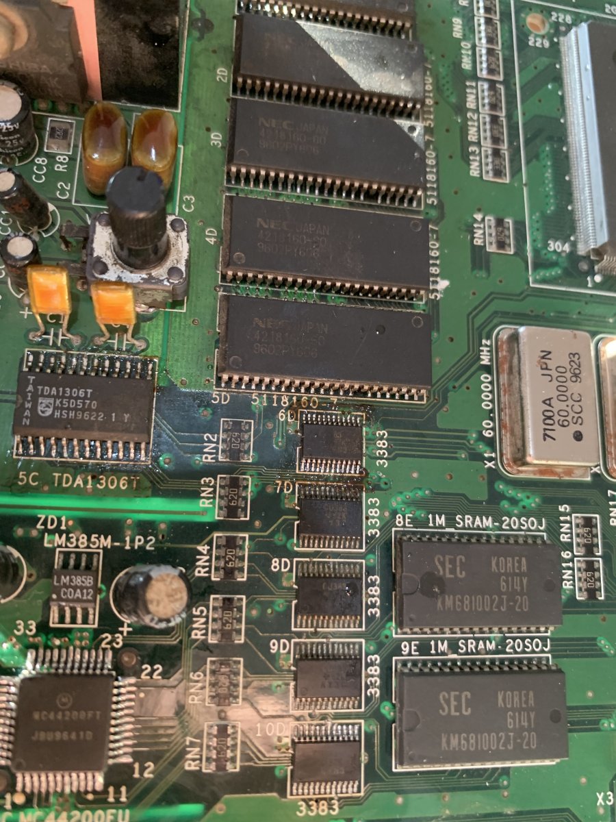

3- like the previous repair for the red color , i put my finger on the resistor array and it made some crackling noice , i didn’t replace the array because it checks good but i replaced the 3383 (6D) that’s connected to
Result: the sound is back
