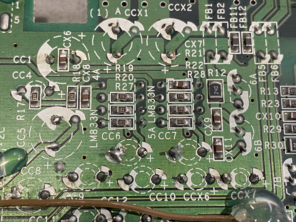

Ended up changing ALL the caps, the sound amp IC AND the alps rk09 pot with a brand new one and still no change. Still sounds scratchy.

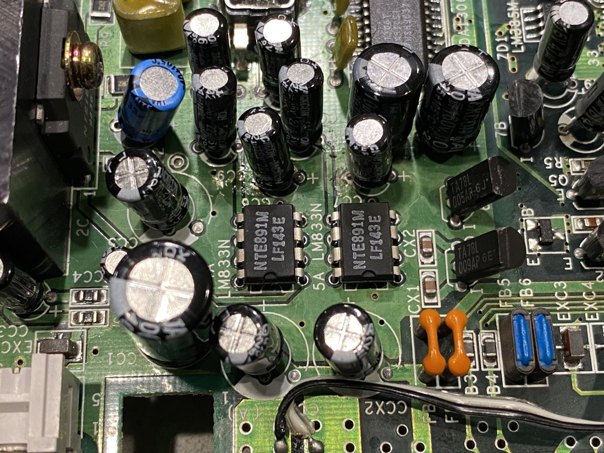

So this is a very weird case. Ended up replacing both LM833N chips after replacing all the caps, sound amp IC AND alps rk09 pot. Unfortunately, the cracking still persists.

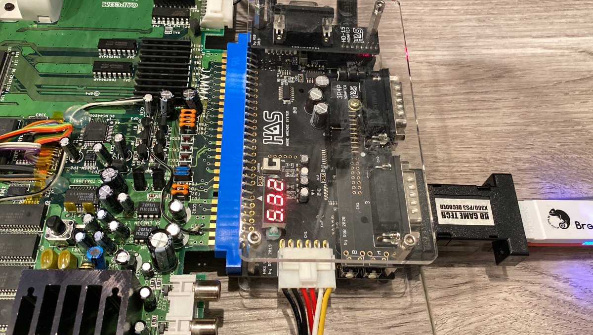

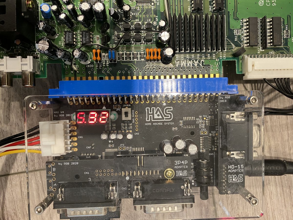

However, I accidentally increased the voltage on my power supply and notices the audio cracking was mostly gone!
Based off the HAS, the cracking disappeared past 5.30v:
Anything under that you will hear some static. Anything under 4.90v starts to crackle a bunch.
This worries me because this should be running at 5v.

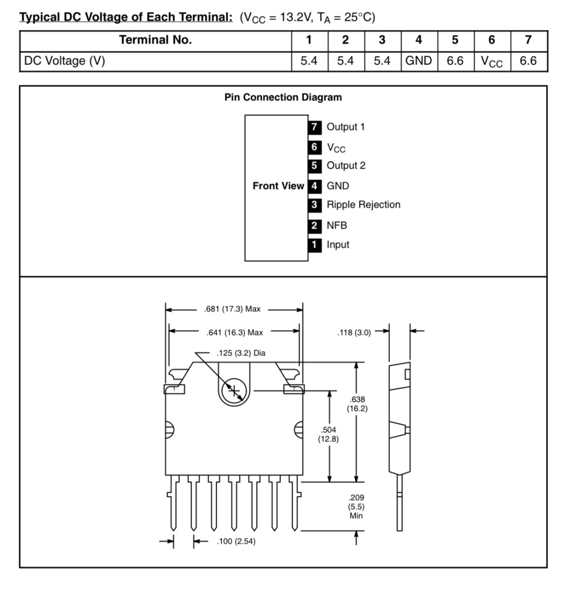

On the Toshiba TA8201AK equivalent (NTE1832) I measured 4.84 on pins 1-3, 6.19 on 5 & 7 and 12.86 on pin 6 VCC at 5.32v on the power supply!
There is barely any audio cracking but it happens rarely. This worries me because of how hot it is and yet not powering up thr sound amp to spec. What is causing this chip to be under powered?

Use a multimeter to measure the voltage at the JAMMA edge and adjust the power supply so that the JAMMA edge reads 5V.
This matches the multimeter. It’s 5.3v at the jamma edge unfortunately
