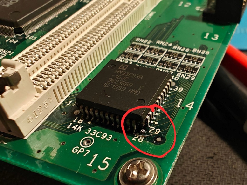

Hello
I have error on my cps3, disc dont read properly. It's seems the mobo side circuit does not work. Is it a know issue? kow fix? chip contoller change required?
Thanks
My buddy find solution and fix it. A cut track close to the SCSI bus control.
Ah never saw this thread, I had a similar issue previous where that cheap had taken a bump by a pcb standoff when stacked on top. I recall googling the chip part number and seeing it was a scsi controller so reflowed it and sorted.
