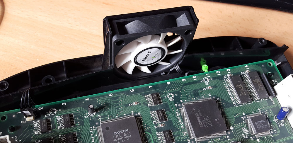

Just got this fan installed. It was a bit snug, but I got everything in place, and I am very happy with the noise levels. It now a soothing sound, not an irritating one.
Just to be sure, is the fan supposed to be blowing air into or out of the unit?

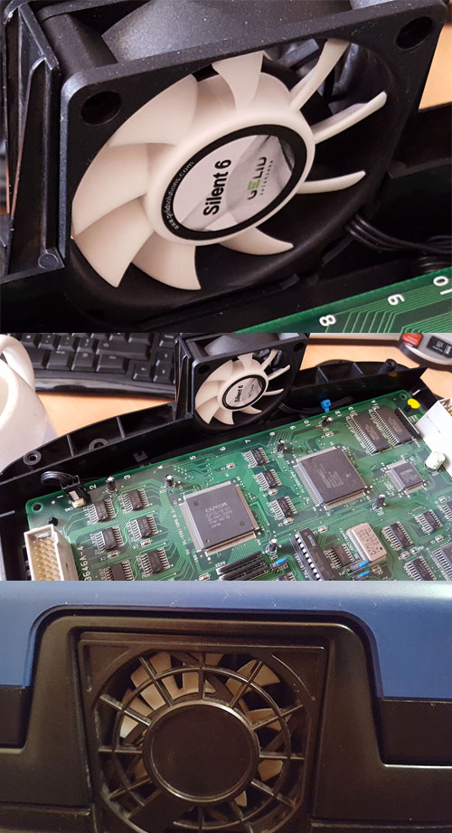

I've now installed a couple of these and have a final one for my last A-board. They are nice and quiet, even when outside the cab. And a damned sight cheaper than a Papst!
(and yes, gentle airflow OUT of the unit!)
