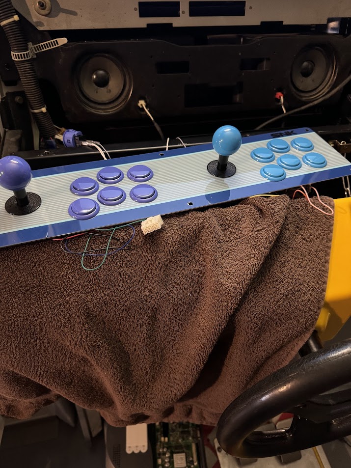

So, lets say you are one of the MANY owners of a Crazy Taxi Naomi Universal upright cabinet and you're thinking to yourself "Crazy Taxi is great, but I wish I could play other JVS driving games too without missing out on anything and I don't want to cut any original wiring or re-pin anything". Oh and you happen to have a Naomi with netboot or own a bunch of games somehow. I know, I know the amount of people this applies to is overwhelming, how will I ever clear up my inbox?
Anyway this is a little project I wrapped up recently to do that and I thought I'd share some links and details in case anyone else wanted to do the same. In case you don't care about the sausage making but like watching short videos of things here you go:
So yeah, I set out with the following goals:

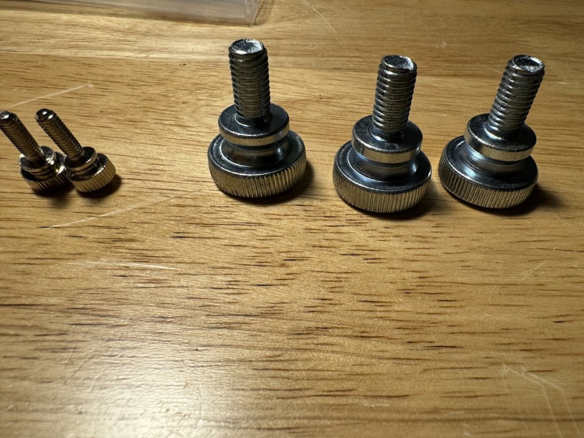

  • Ability to access easily with thumb screws to switch quickly (at the speed of screwing anyway)
  • Ability to switch easily with just a couple AMP connectors
  • Ability use missing buttons not on the Crazy Taxi control panel
  • Have the buttons light up according to the game logic
  • Have the panels blend in relatively well
So to meet the above I needed to make some wiring harness adapters, a 3D printed swappable panel for auxiliary buttons, a master harness to get the output lamp signals from the Sega IO to the auxiliary panel and button presses to the 1p/2p panel connectors via the harness adapters. Here's all the bits piled together:
So it amounts to 3 harnesses and two panels that combine to cover the Naomi games and OutrunSP on Chihiro. It would be easy to expand this to Triforce but I don't own a Triforce so you know if you've got an extra Triforce type 3 lying around let me know. eyebrows eyebrows. Anyway the flow looks like:

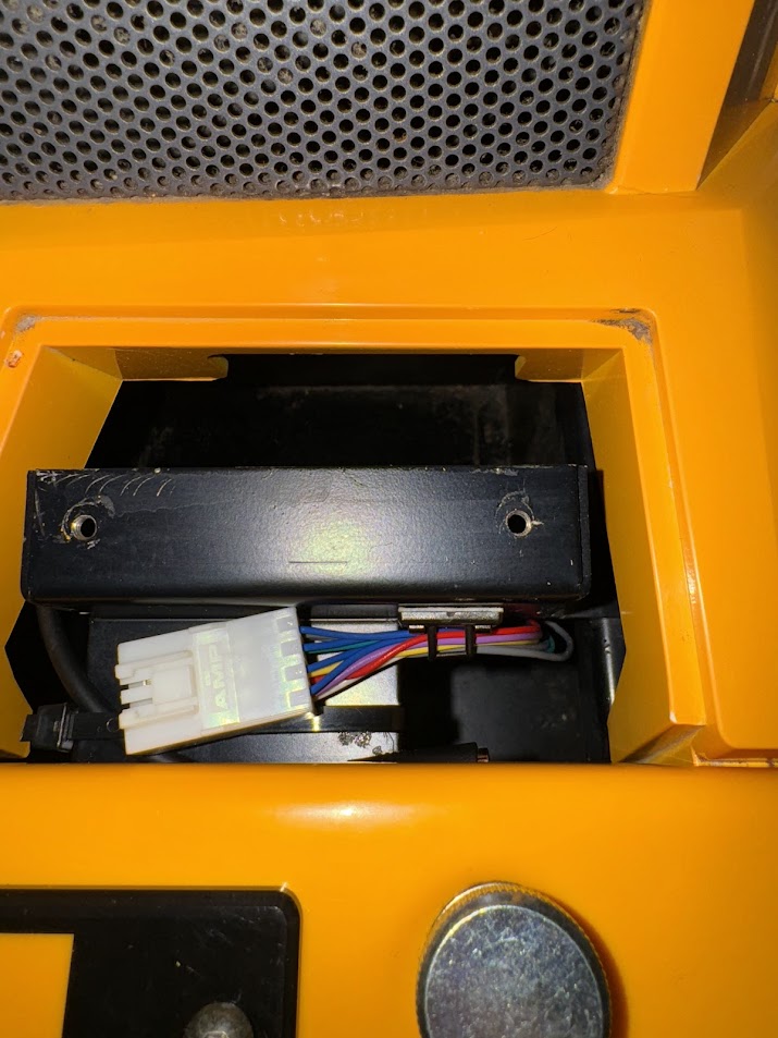

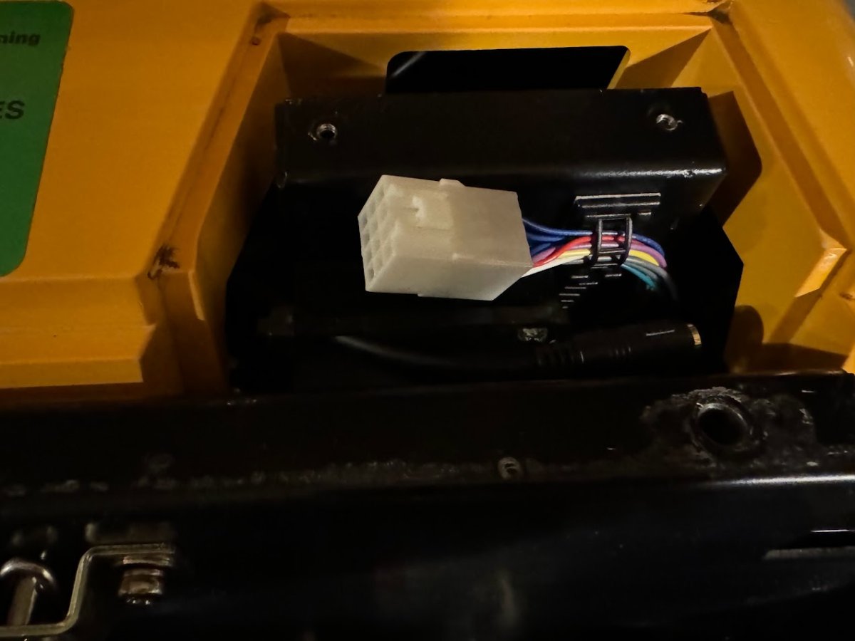

Unscrew theseOpen thisStick one of these ingrab one of these guysGoes hereyay

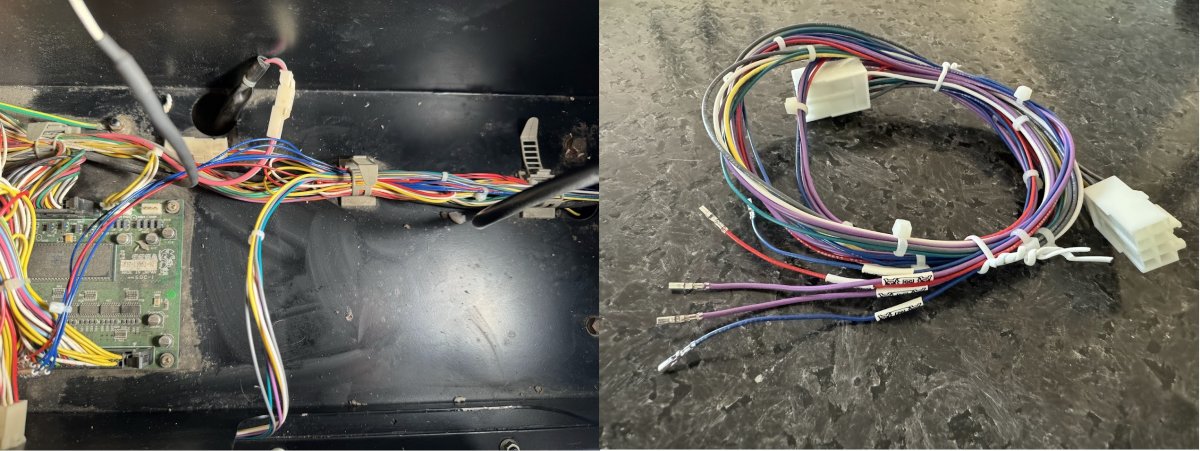

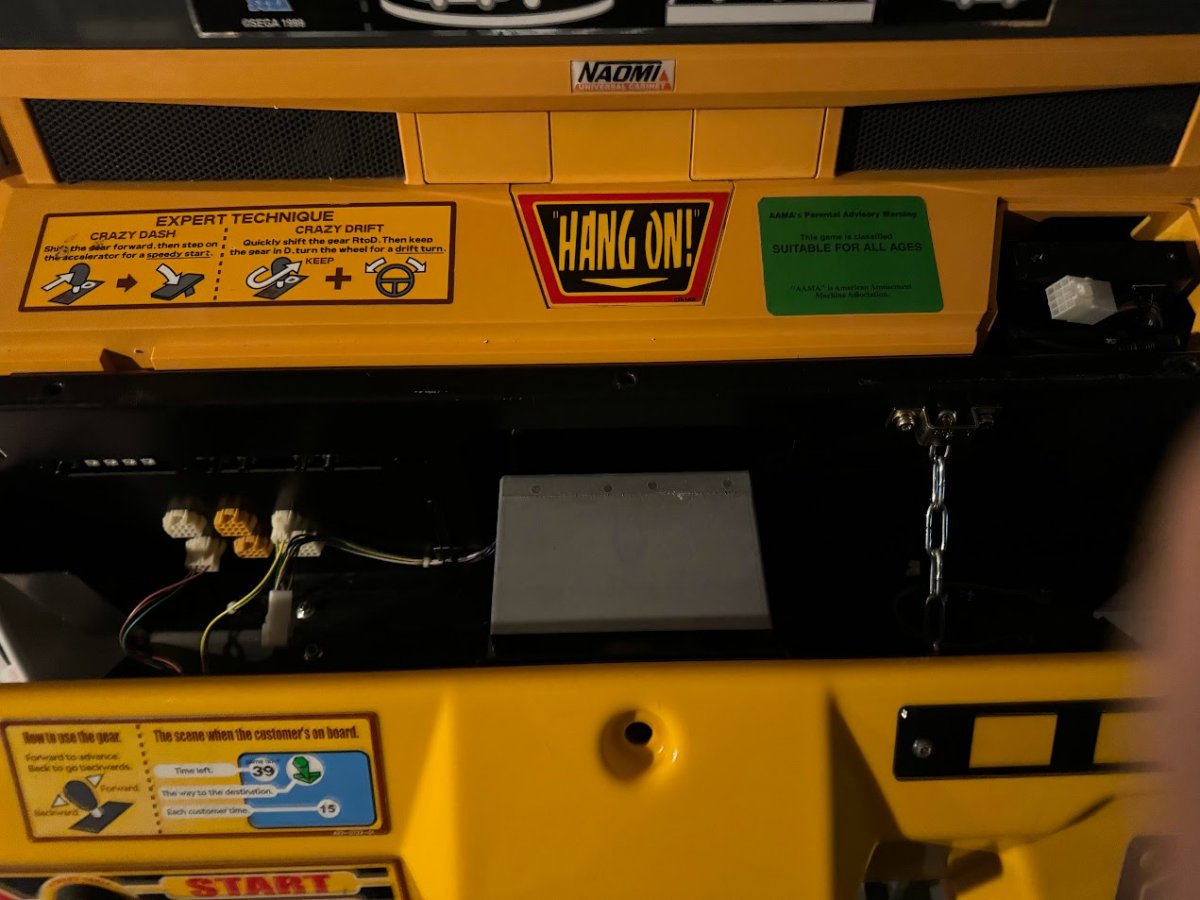

Making Stuff Part 1 - Wiring

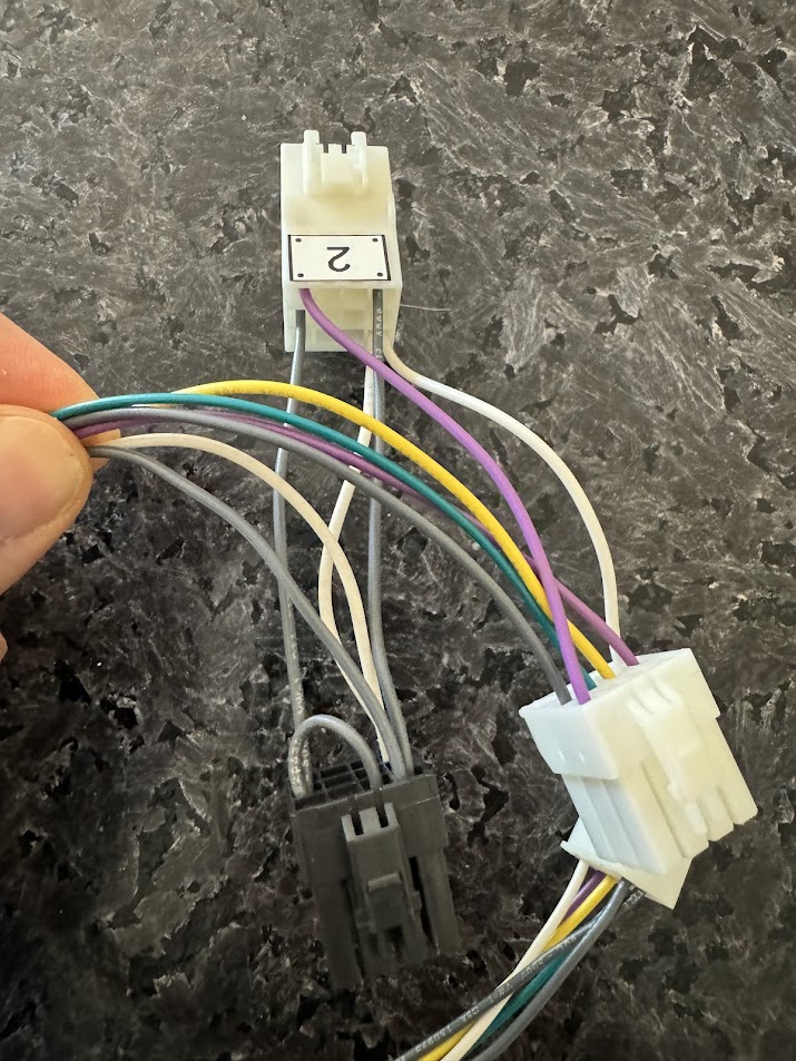

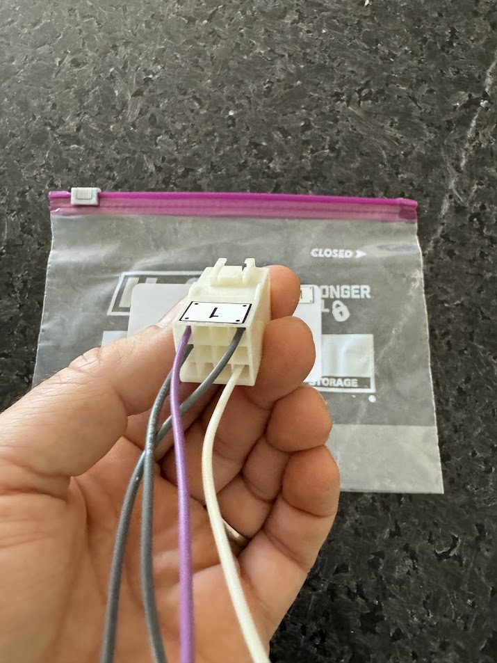

So you're in luck if you have one of these, the Sega IO board is already fully populated such that the Player1, Player2 and Analog connectors inside the panel have everything it needs for CT and everything else. The only parts of the Sega IO that aren't pinned are mostly the output lamps for buttons that are never used. But now we will be using them so we need to get with making a master harness that will run from Sega IO board to the little cutout we are using for the auxiliary button panel, and through to the main control panel that we can open with thumb screws to access the Player1/Player2. By making the auxiliary panel use a 12 position AMP connector and split off to the Sega IO and the front control panel compartment to another 8 position AMP connector you can swap button panels and swap control harnesses without needing to take the face off.
The process of figuring out what mapped to what and confirming the output lamp switches was to leverage a sheet Chunksin had made and to confirm/update it from the CT perspective just using a regular control panel and some VERY fancy paper clips jammed into the 60pin jst connector of the sega IO
For the harnesses themselves, I'm just using 12 position AMP connectors for the Player1 & Player2 connections in the panel and a female connector to accept the existing Crazy Taxi connector which normally plugs into P1. Finally for harnesses with auxiliary buttons, those are connecting to the master harness via an 8 position connector
12 position AMP (1P)

The details of how each harnesses is mapped to the existing P1 & P2 connectors can be found in this google sheet:
https://docs.google.com/spreadsheet...Bks6oRMujqdP3EsHK9HqRcr_8/edit?usp=drive_link

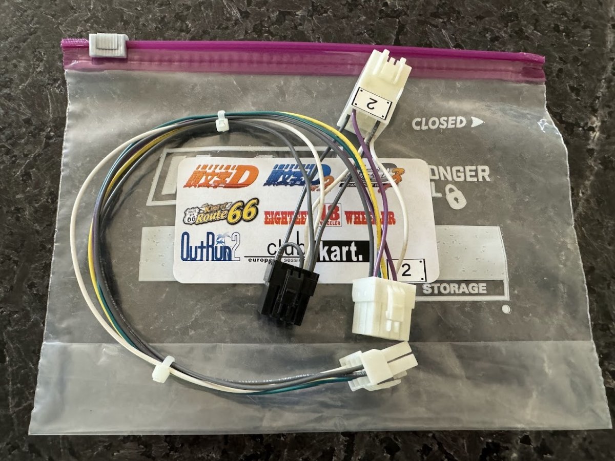

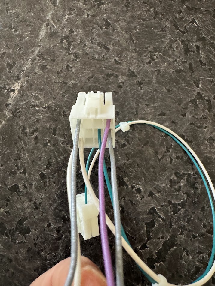

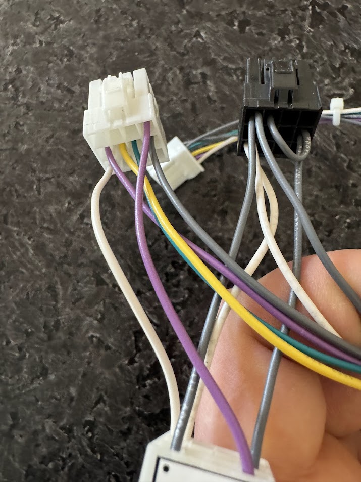

More detailed pics of each harness in case you like pictures and hate Excel
harness1 (CT acceptor side)harness1 (adapter to panel side)harness2 (CT acceptor side)harness2 (adapter to panel side)harness3 (CT acceptor side)harness3 (adapter to panel side)
Game to Harness Mapping
GameHarnessPanelComment
Jambo SafariHarness 1N/ANo extra buttons
Initial D 1/2/3Harness 2AView change
King of Route 66Harness 2BView/Cruise/Horn/Wipers/Mic
18 WheelerHarness 2BView/Cruise/Horn
Outrun2/Outrun2SPHarness 2AView change
Club KartHarness 2AView change
Faster than speedHarness 3ABoost

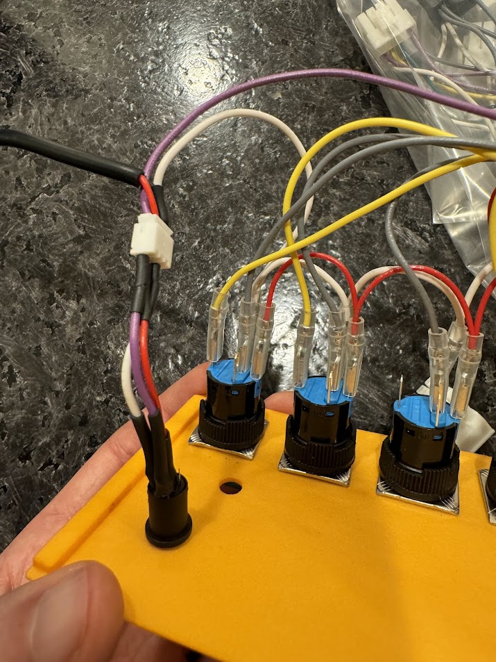

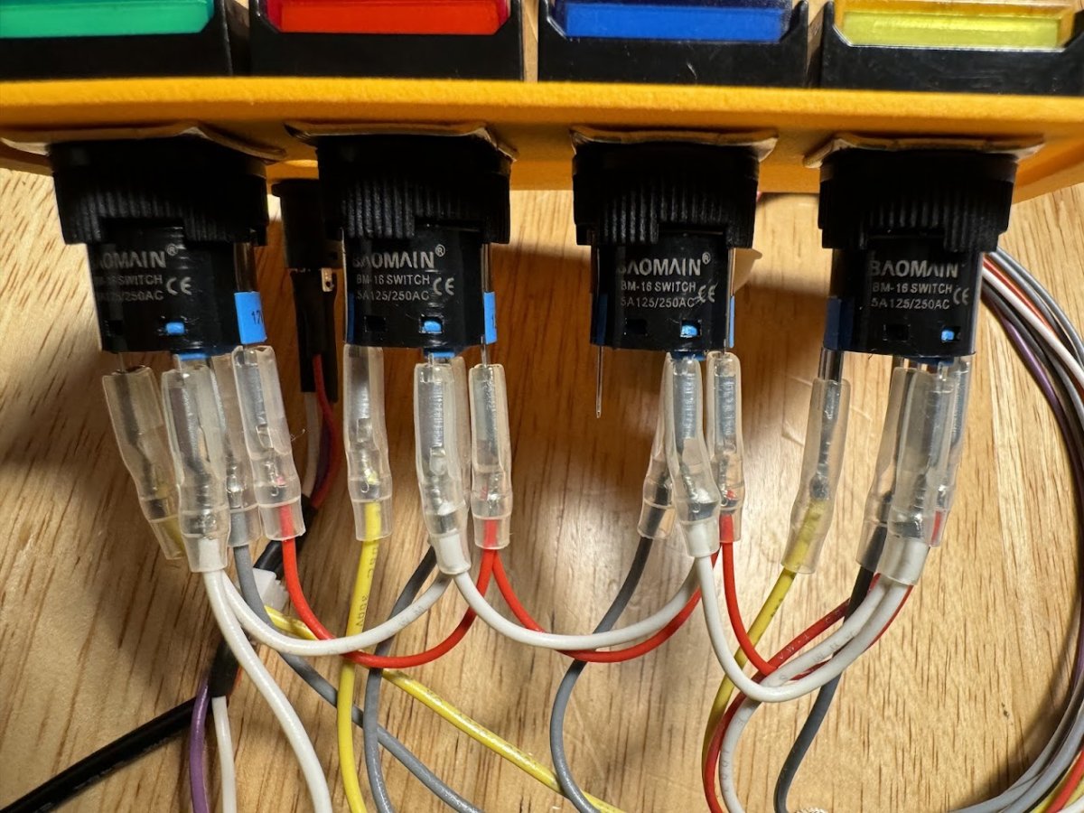

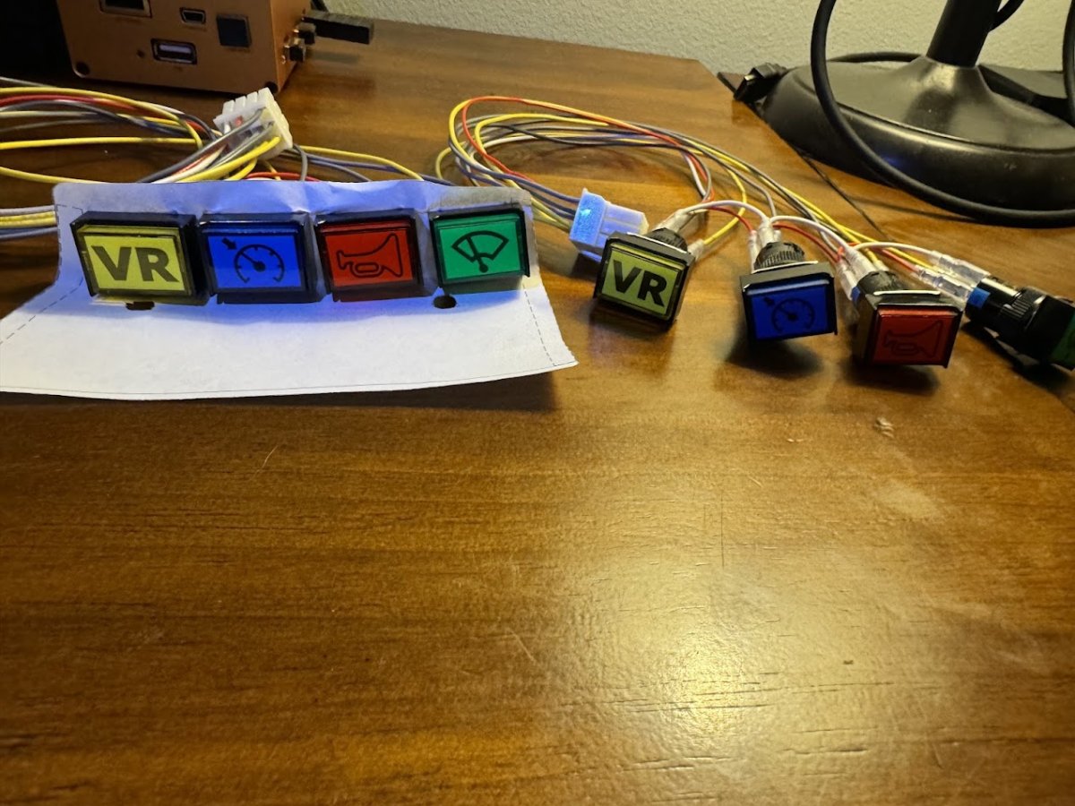

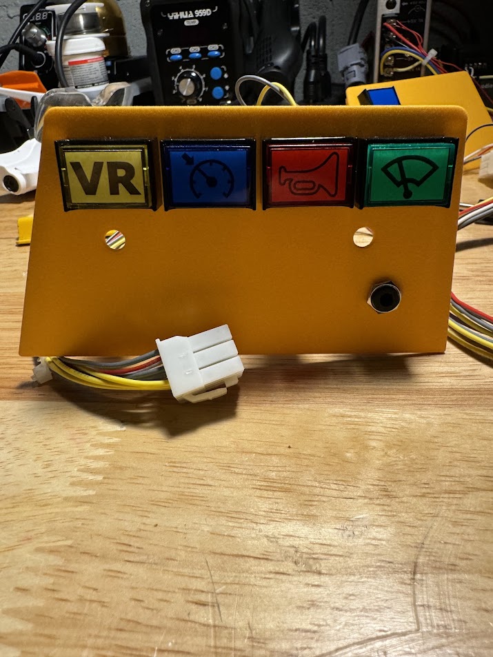

Button Panels

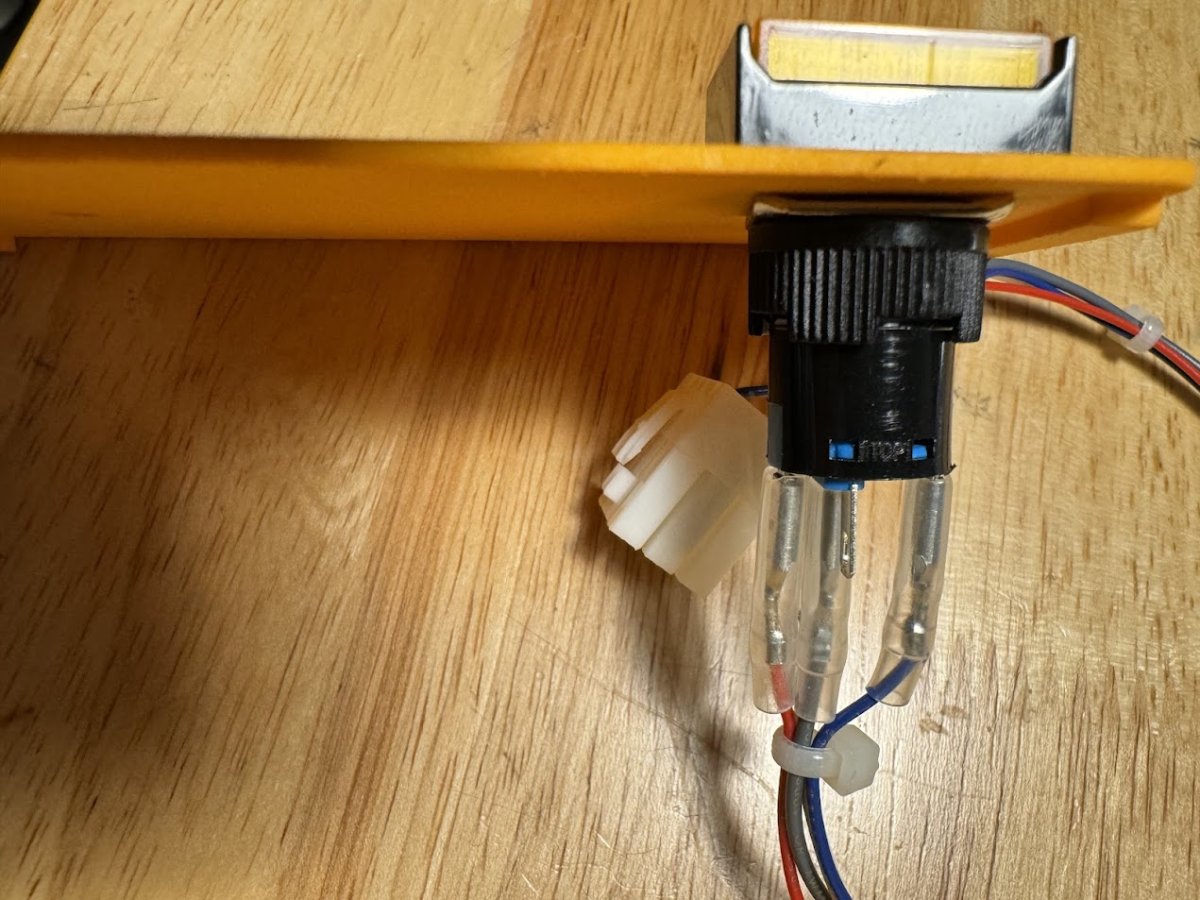

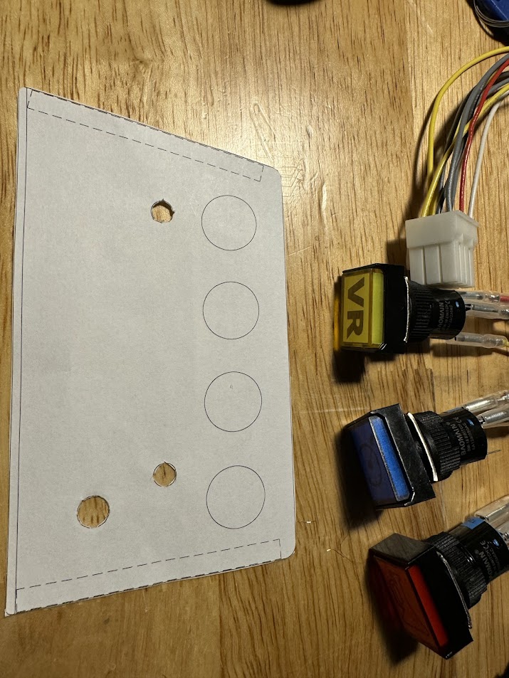

For the auxiliary button panels, I used 12V light up buttons I bought from Amazon. These were mainly used because we have 12V easily accessible off the Sega IO and because they fit the space available above the large metal mounting post that the panel sits atop of. Also they were inexpensive.
momentary buttons:
https://a.co/d/fcOfbOb
latching buttons:
https://a.co/d/aMcPKI6
spade terminals with insulators:
https://a.co/d/bE4pnuC
So its important to use insulated terminals here. Why? Because you've got 12V you're sliding past a large chunk of metal so you don't want to short the IO boards 12V against the cabinet frame.
Why the latching buttons you ask? Well the blue button on the 18 wheeler/KOR66 panel is a "cruise control" button I added which latches. This keeps it in high gear because otherwise you have to hold the shifter up on those games and that's annoying. This is due to a design difference in the physical shifter used for Crazy Taxi and those games. See the google sheet for details on how this is wired.

The game King Of Route 66 is responsible for most of the buttons on the shared panel between it and 18 Wheeler as well as a microphone jack. In the game you can press a button on the CB to talk to other players on the real cabs, or to request a Boost by saying "Boost" as well as responding to in-game characters. The CB radio in general is unfortunately an expensive endeavor if you want to add support for it because there are a couple things required that come from everyone's favorite gouge eBay. First the cheap stuff:
CB style walkie
https://a.co/d/aWnfR85
Panel mount microphone jack
https://a.co/d/euRwCMf
JST PH connectors (I happened to have these, not strictly required)
https://a.co/d/0SbaHNl
3.5mm mic jack (mono)
https://a.co/d/iqx6TNm
12ft mono audio cable
https://a.co/d/iuH3Os5
To get this wired it isn't too bad, you just need to wire up the mic jack to a mono audio cable through the panel, and one of the button signals on the master harness so it can trigger a button press on the right IO. (see the google sheet for details on button for the mic)
You don't have to do it like this, I just made mine with a little JST PH connector and a separate detachable 3.5mm jack to make it easy to take things apart if there is some issue in the future (and the detachable 3.5mm jack so the panel can be pulled out but the long run of mono microphone audio cable can be left in place. (photo 2 above you can see its strapped to the mount toward the bottom)

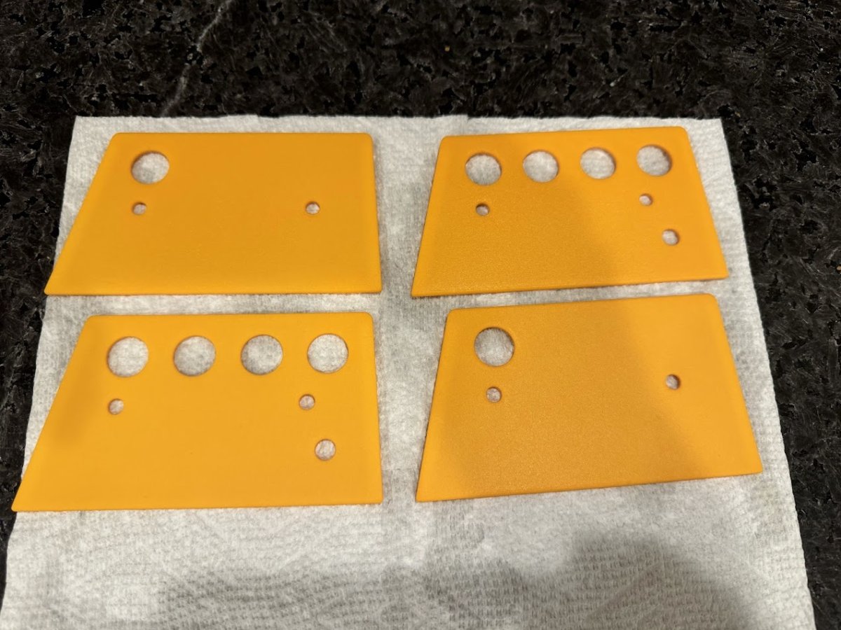

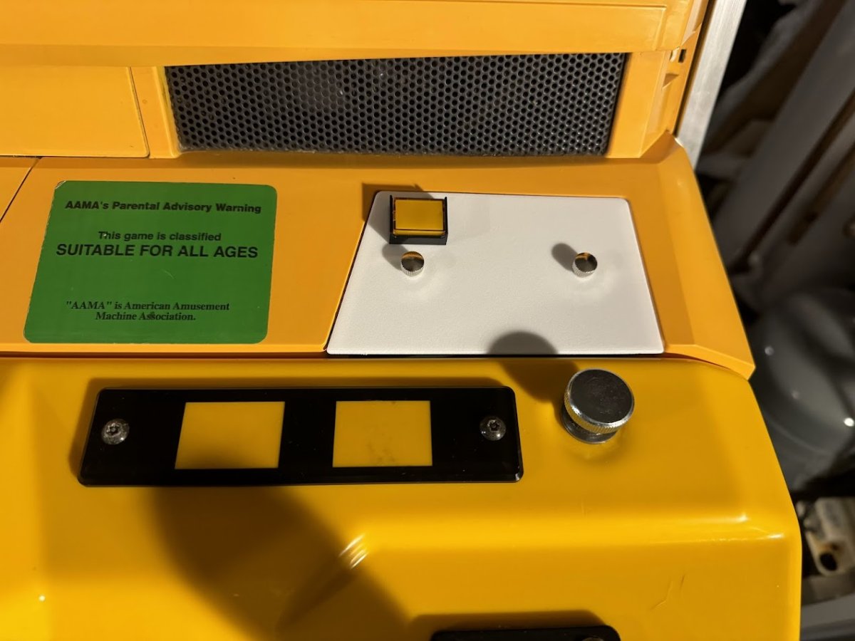

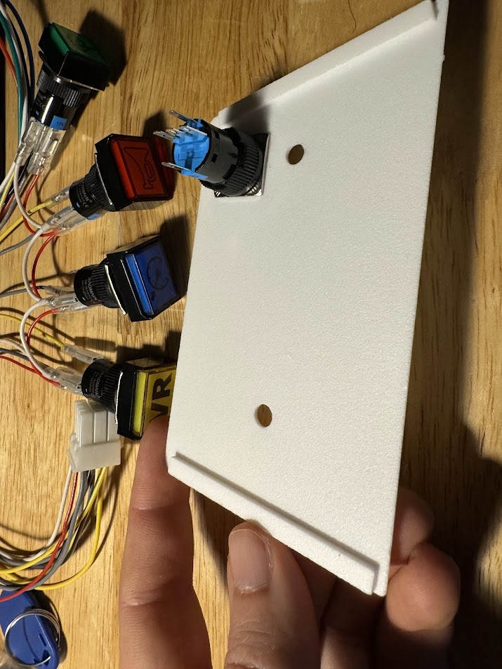

Making Stuff Part III: 3D Printed Aux Button Panels
This part was completely new to me, I had never designed a 3D Printed thing before, I don't own a 3D printer and I hadn't used any of the 3D modeling software people use for these tasks. So that made it pretty fun to work on. Anyway here's what I did:
1. Bought some cheap calipers off Amazon:
https://a.co/d/2xh7aqw
2. Got a free personal copy of AutoDesk Fusion360:
https://www.autodesk.com/products/fusion-360/personal
3. Used the calipers and a protractor and did my best to recreate the panel in 3D using the software
4. Printed 1:1 printouts of the 3D modeled object so I could line it up and compare it with the real deal
5. Sent it off to print using Craftcloud:
https://craftcloud3d.com/
6. Test fit the singleton print and ordered the rest
Fancy paper prototypes
Test fit of the real deal
Overall this process was very smooth and had good results. For the 3D prints I went with nylon because I read it was a tougher material than pla and because I knew I wanted to try dyeing it rather than painting.

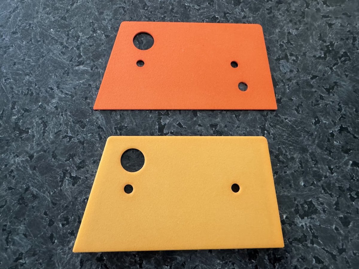

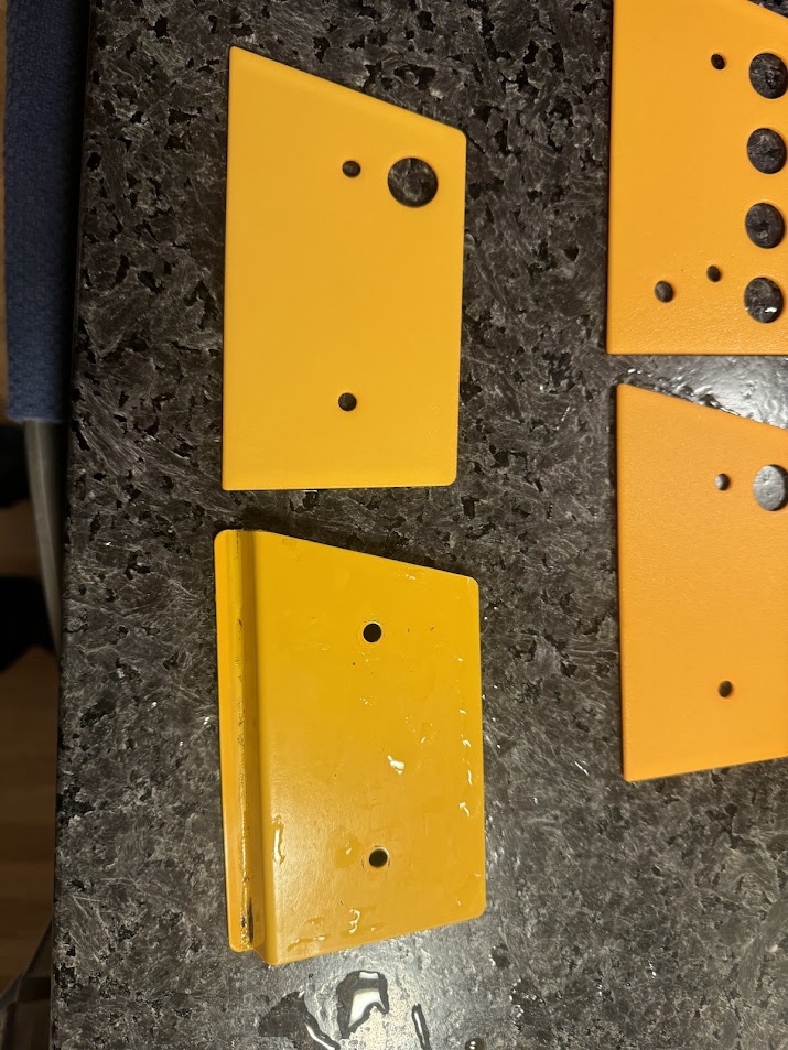

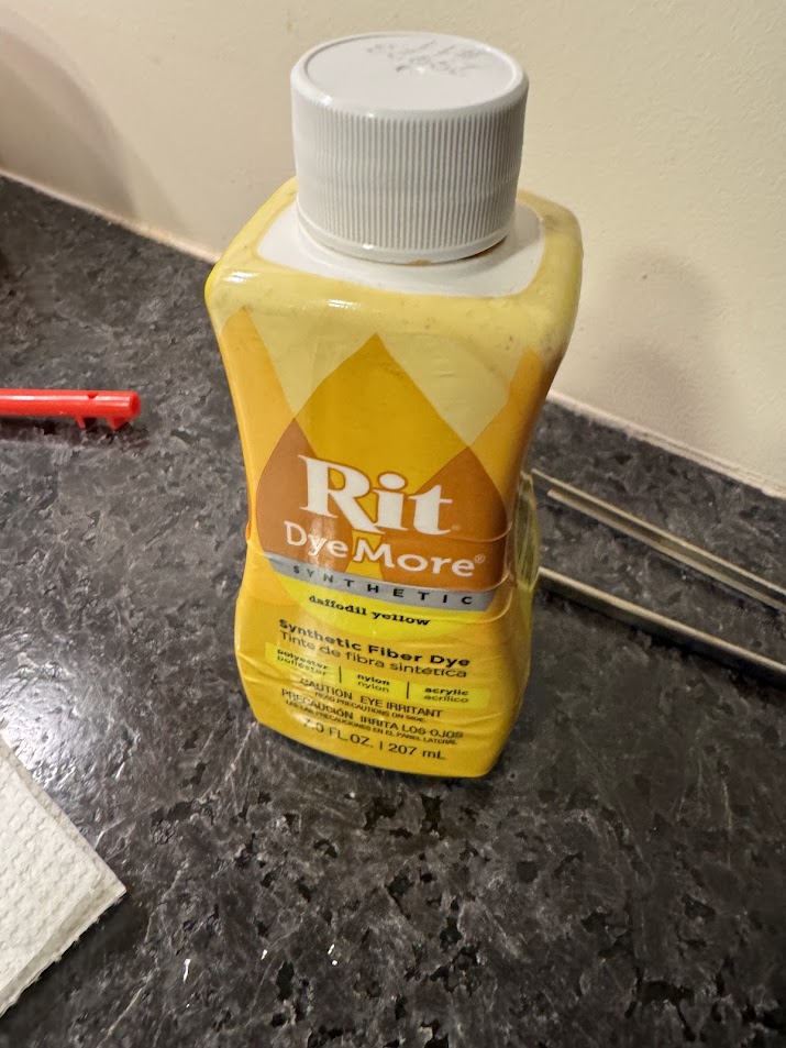

Making Stuff Part IV: WELCOME TO DYE
This part was again way outside my wheelhouse and definitely more into the realm of arts and crafts than I'm used to. It took me a couple rounds of trying and sacrificing a few pieces before I got it to look how I wanted. First off, the 3D print material is Nylon as I mentioned above. That means you can dye it with nylon dye just like fabrics or backpacks or shoes or whatever that are nylon or nylon adjacent synthetic based. To do that you can use a line of products specifically for nylon dyeing from a company called RIT
In the case of the Crazy Taxi panels, I tried two different types of dye, RIT synthetic daffodil yellow, and sunshine orange. The first attempt was not good. The method I tried this first time was microwaving the water to about 200F and then submerging the items to be dyed.
The top here is sunshine orange, I tried it on pieces of another print and different ratios always yielded a deep orange. The bottom one is daffodil yellow but the camera makes it look better than it is here, its actually more like peach or apricot in real life
So with that failure out of the way, I did some googling and youtubing and found people recommending adding soap, adding vinegar etc. Tried a couple experiments with my cut ups with that but these also failed. Finally I decided to try the recommendations of boiling it continuously. So its not at a full boil but still at around 200F but kept pegged at that. This was a much better result!!
So at 200F for 5minutes with about 6 cups of water to 3 tablespoons of the RIT daffodil yellow synthetic dye you get a yellow that matches the stock blank panel pretty well:
So I let it boil another 1-2 minutes to get a color more like the dark two on the top of the last photo since my Crazy Taxi shroud is a darker color than the stock panel. Overall its not 100% perfect but I'm very happy with the result! I think with more accessibility to a 3D printer and more practice with the dye you could get a pretty exact color match but it was definitely at a good enough level for me at this point.
