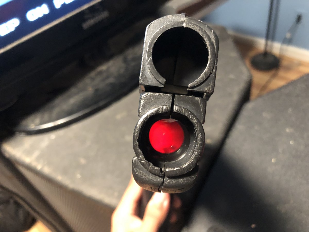

Hello, I want to show everyone something and hopefully help some people who want to have or fix a Crisis Zone, Vampire Night, or Time Crisis 3 CCD Camera setup. I wanted to test some of these games for myself but the most expensive part was the Gun Sensors themselves. I went ahead and tested a cheap simple IR led circuit and it worked. I’m not sure if it’s common knowledge but it turns out that you don’t need a specific led. It just needs to be bright enough for the CCD camera to pick it up. I tested this with both the Namco Rays JVS pcb and the Namco V221 MIU pcb. Any CCD camera (Color or Black and white) seems to work as well. What you do need is a good piece of IR filter. I did also notice that the black and white camera picked up the led much better than the color camera. Hope this helps anyone out there. This is just a fun experiment that I did :)
Edit: I was able to play the whole game like this without any issues. Works fine, I will test with the other games and with other monitors.
The circuit I used: MagicW Digital 38khz Ir Receiver 38khz Ir Transmitter Sensor Module Kit for Arduino Compatible https://www.amazon.com/dp/B01E20VQD...abc_G9F975EBV75HKK6M6J30?_encoding=UTF8&psc=1

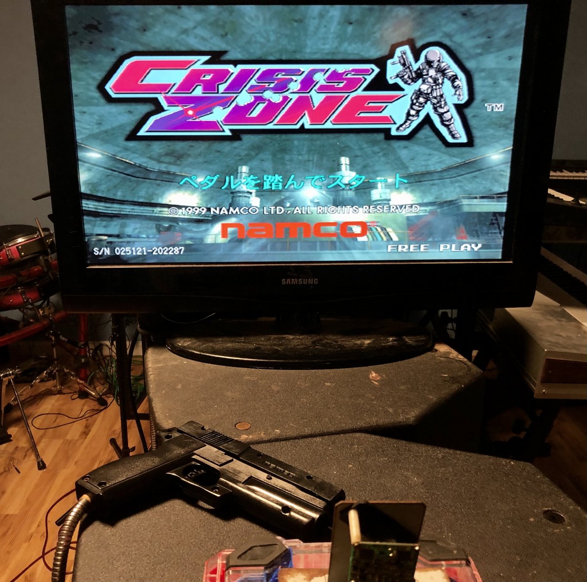

Here is some gameplay on a 32” Samsung flatscreen LCD. Works extremely well. I wish I had the real gun but this substitute works fine for now. I will do some further explanation on how to build your own gun. On another post, I showed that Time Crisis 3 works. Vampire night works, but with mixed results. Need to do further testing with that game. (Edit 07/12/2021: the gun works perfectly fine with Vampire Night)

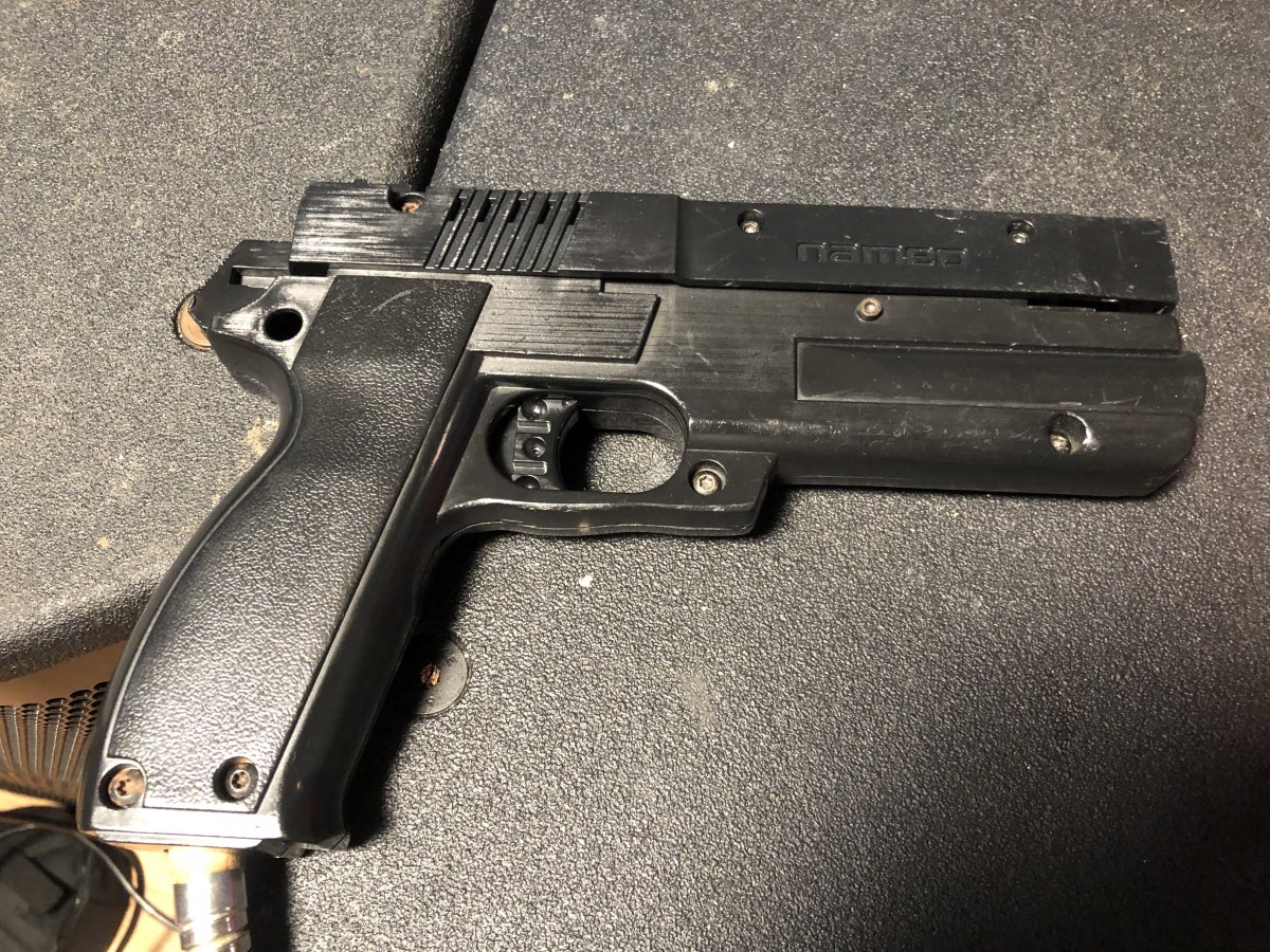

I see the gun in the picture isn't a original Namco gun but instead that "named/nameo chinese aftermarket gun. It looks all used as opposed to new. I wonder where you got that gun from? What you did would be beneficial to any Japanese Time Crisis 3 owners that have trouble finding those original Namco gun shells.
The nature of that game is the fact it uses two IR guns but only one camera unlike the other games which had only one IR gun to begin with. An earlier thread mentioned the LED pulses differently depending on which player connector it's plugged in to. Idk if you were able to get player 2's side working on Vampire Night and on both I/O boards. The MIU board has its PLD labeled different implying that board is probably not intended for use with the two IR emitter setup.
I got the gun from a Chinese seller that I usually buy my stuff from. Really good price as well. It’s not in the best condition but it works for my purposes. I plan on mainly making these for people who would like play these types of games at home, specifically Crisis Zone. I might actually mold and cast some repro shells from a good shell I have (blocking out NAMCO for obvious reasons) but using a standard PlayStation Guncon 1/2 or a toy sub machine gun will work as well. I do have some experience casting plastic parts because I used to customize action figures. I did try vampire night with two IR led sensors. It worked but the player one gun had an issue registering on the bottom left. Vampires night uses one I/O pcb. I sadly have booting issues with both of my rays pcbs. If I remember correctly, @bobbydilley did some test and say that the player 2 gun on vampire night pulses the led while player 1 stays on. I did do some extra digging around and I might have a solid idea on how the IR gun sensors for both Crisis Zone and VN/TC3 work. Right now the IR led pcb is using uses 2 pins (5v DC and Ground) which means the gun will be constantly on which isn’t good for long term arcade use. There is a third pin that both pcbs use called “led on” which seems to control when the led should turn on or in the case with vampire night, what the led should do (pulse?)
