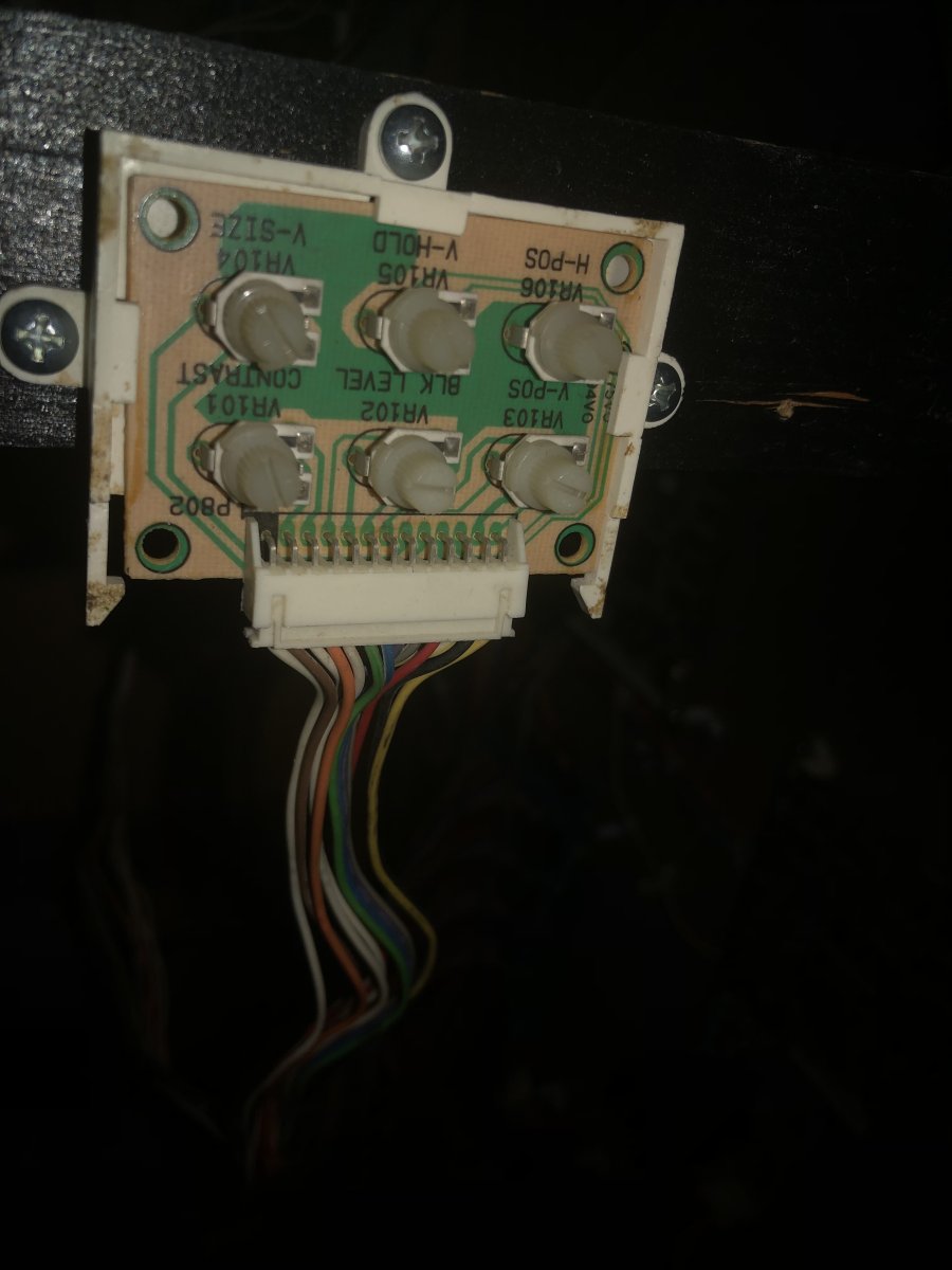

Hi is there a remote board for this i can buy to adjust horz/vertical width of the monitor to set right for games?
There is. I assume yours is plugged into the chassis, but many of them came with a holder and cable so the board could be fit inside the service/coin door for example.
I can't seem to find one online, you can always buy a broken 25k714 chassis and borrow the cable from that, there's some on Ebay.
With some luck this is a generic cable used between a whole series of chassis like K7000 k7100 , and somebody has a better suggestion, i mainly deal with Japanese stuff these days.
On the back there is a cardboard peace with white knobs not sure if thats it

That's the neck board and those pots are for adjusting color.
Look below it.

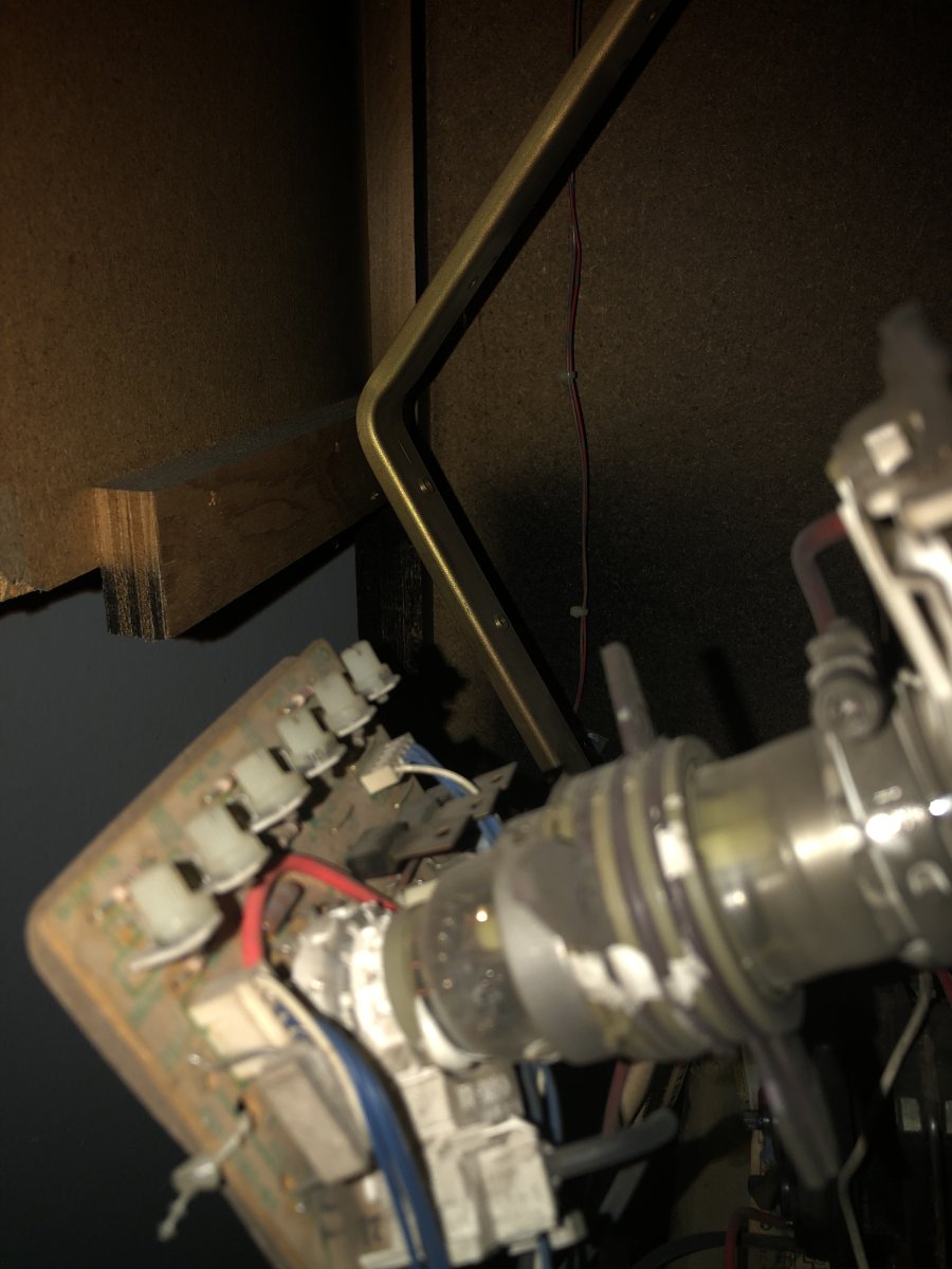

Ok i will post more pics later i was wondering is it just the cup you can touch and you will be shocked is there another part is it safe to touch the knobs?

I found the is after i opened up the front control panel..
