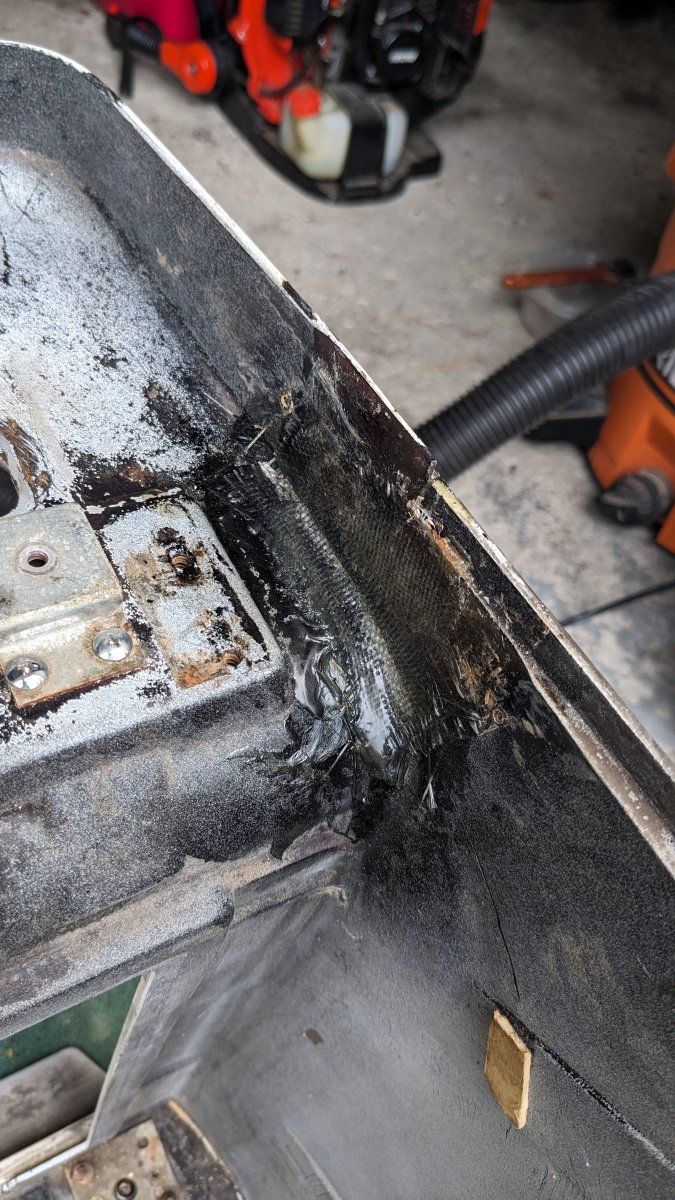

As the title states, picked up a very beat up/rundown/smoke stained astro city, about a month ago. At some point it was exported from japan to china and spent the end of its life at a City Hero arcade. So to start, here is what i'm working with:
They tried to repair the crack on this side but not the other...

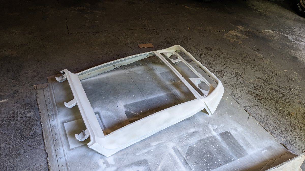

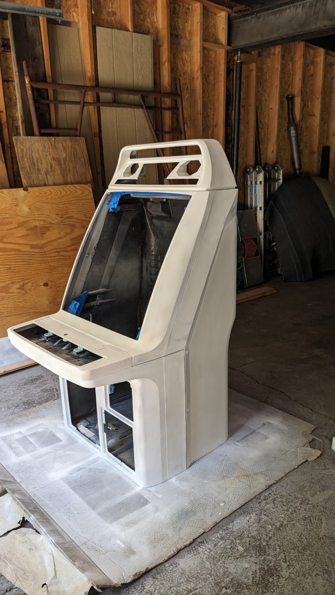

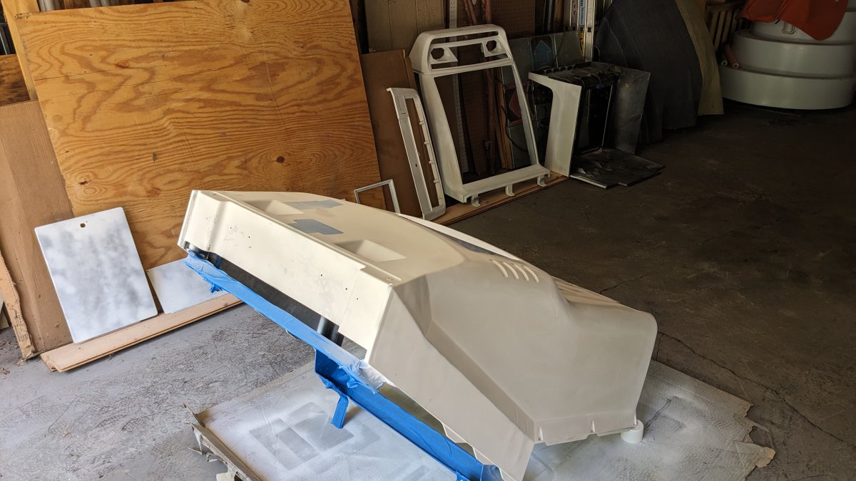

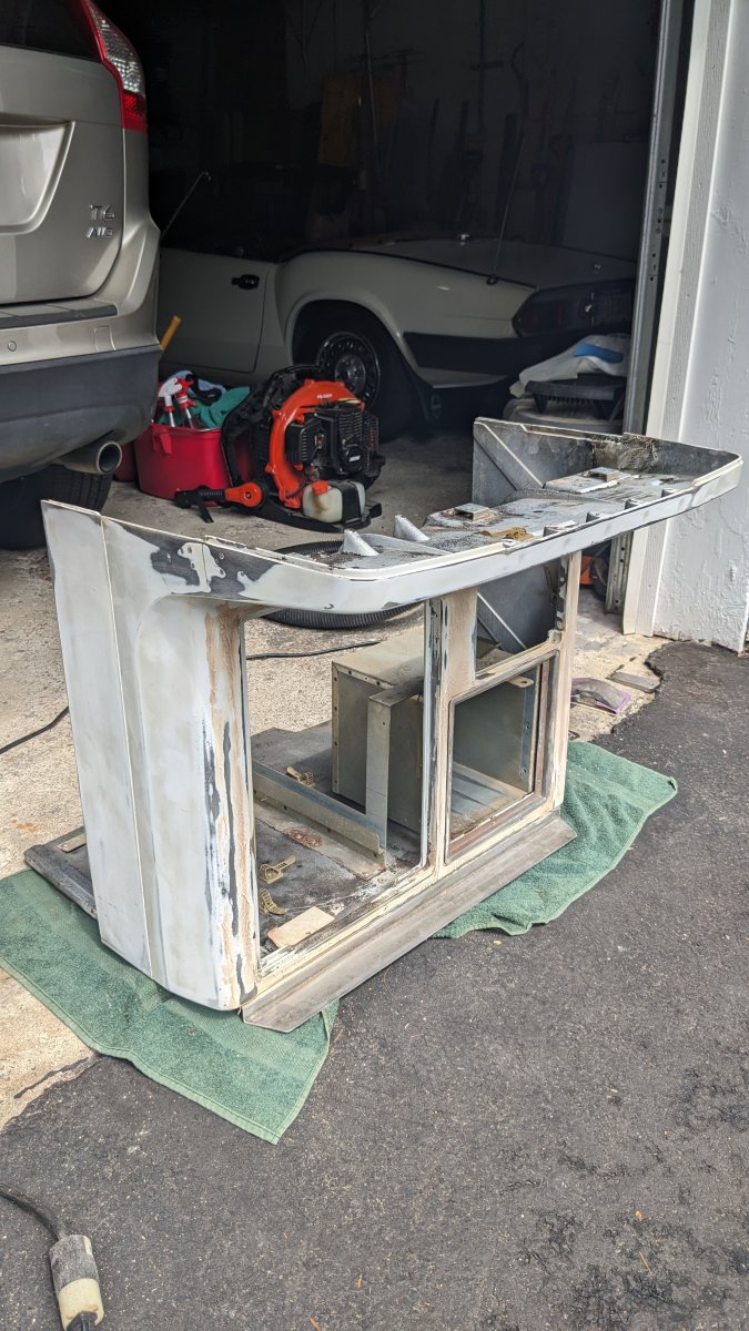

cleaned up the shell with super clean and a garden hose and now i know what i'm working with.
The back is good enough so wont need to respray that. With some repro side graphics it should be good to go. plus i do want to leave the original stickers intact. so i was happy it cleaned up as nicely as it did on the first pass.
The front half of the shell is a different story. I confirmed whatever paint/color is on the front will not come off with a simple clean, so clearly this is going to need to be resprayed in its entirety after the fiberglass fixes are done.

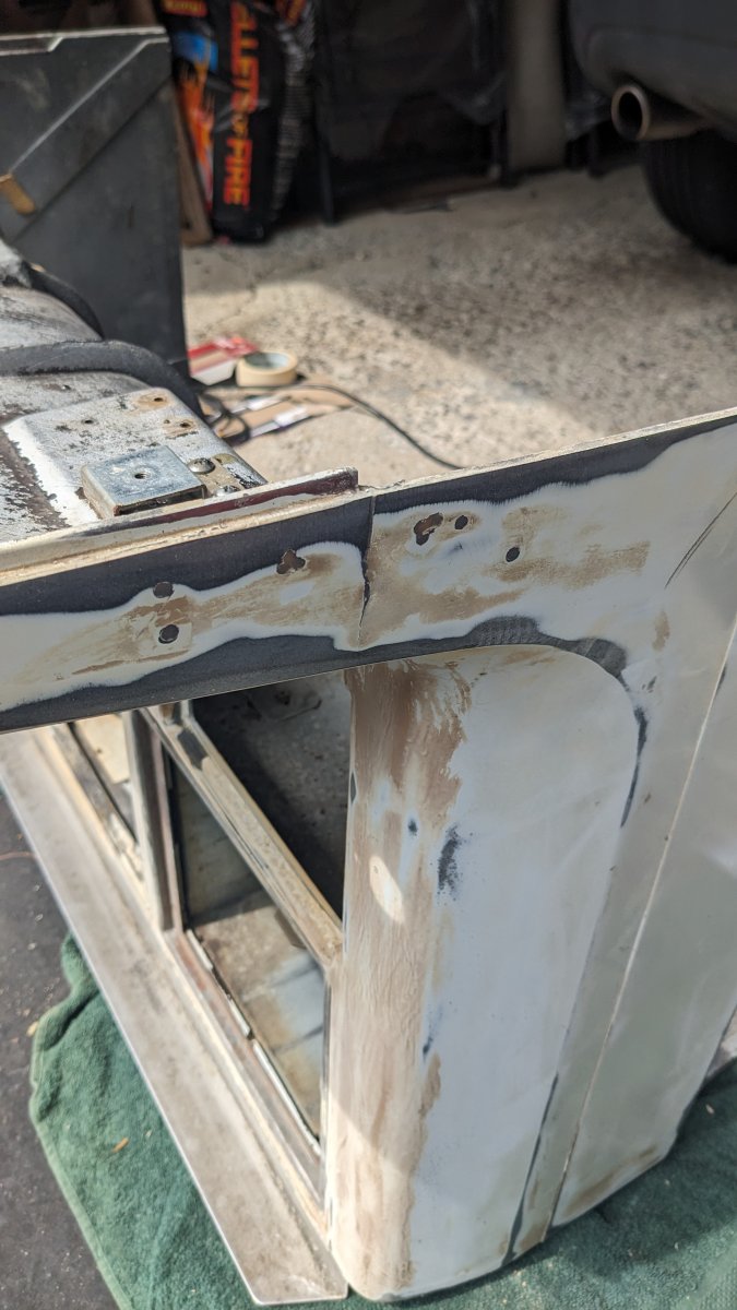

Currently I have the front metal panels in an acid bath to remove rust/the weird colored paint. will post an update once that's finished
Ok so I cleaned up the metal pieces. Removed all the rust and weird paint. They're down to bare metal and ready to be prepped for paint. Too bad I probably won't get around to painting them any time soon, but progress none the less.
I ended up acid bathing them to get to this point, just a simple solution of vinegar and salt did the job, definitely wasn't the fastest though
