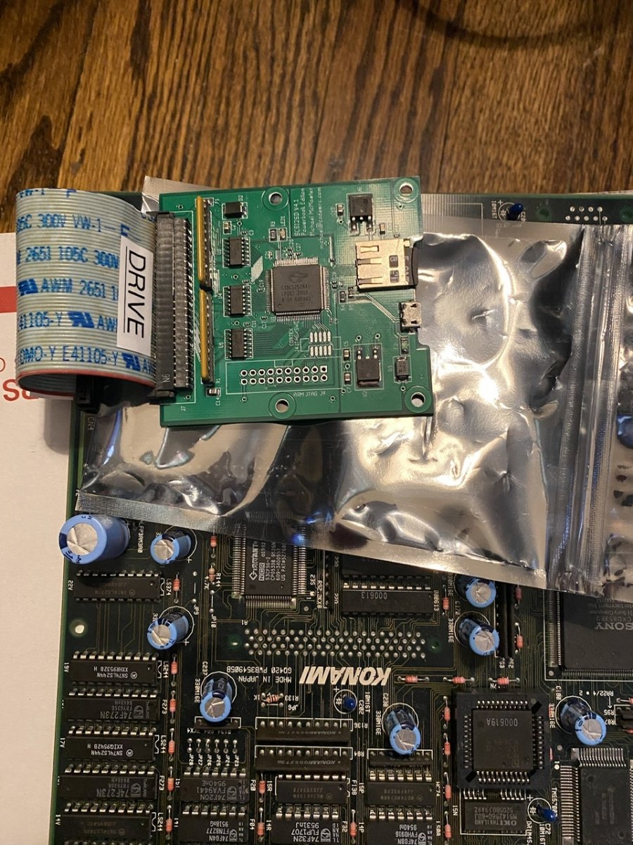

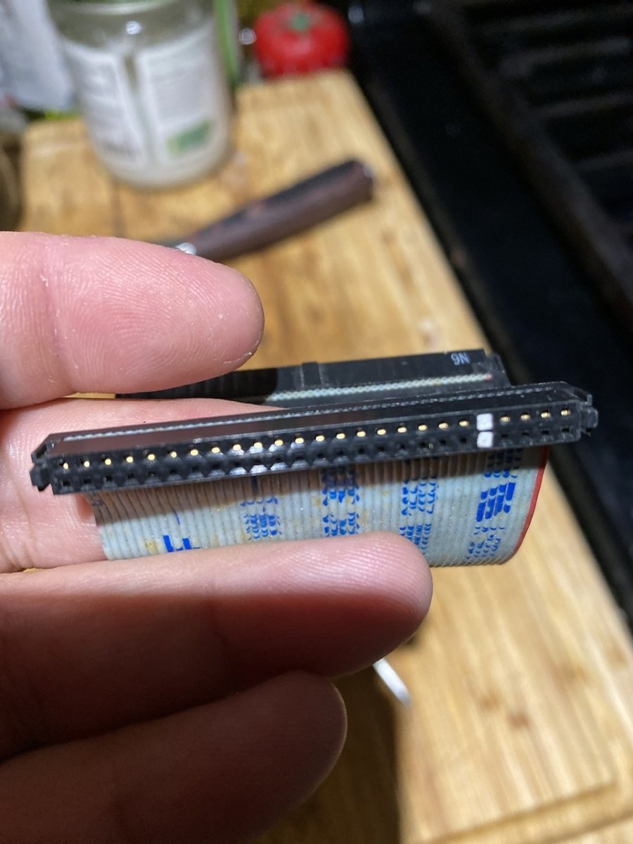

the SCSI cable that comes with Crypt Killer has pin 41 and 42 blocked
You can pull these plugs. I used a pair of very fine tweezers. The SCSI2SD adapter has all 50 pins on the board so these will need to be removed or else they won’t connect.
my SCSI cable had no pins inserted into the hard drive side of the cable. If you find pins just use a very fine bit drill bit and drill them out. Check for continuity after the fact
note : pin 41/42 on the CRYPT KILLER pcb DONT seem to go anywhere on the pcb itself but I didn’t probe super thoroughly. To be safe make sure these pins aren’t connected.
SCSI2SD settings
in the SCSI2SD utility set the device as “hard drive” and set the SCSI ID to 0 / Zero. You do not have to restrict the hard drive size down to 420MB. There seems to be no security check in the pcb in regards to the size of the hard drive.

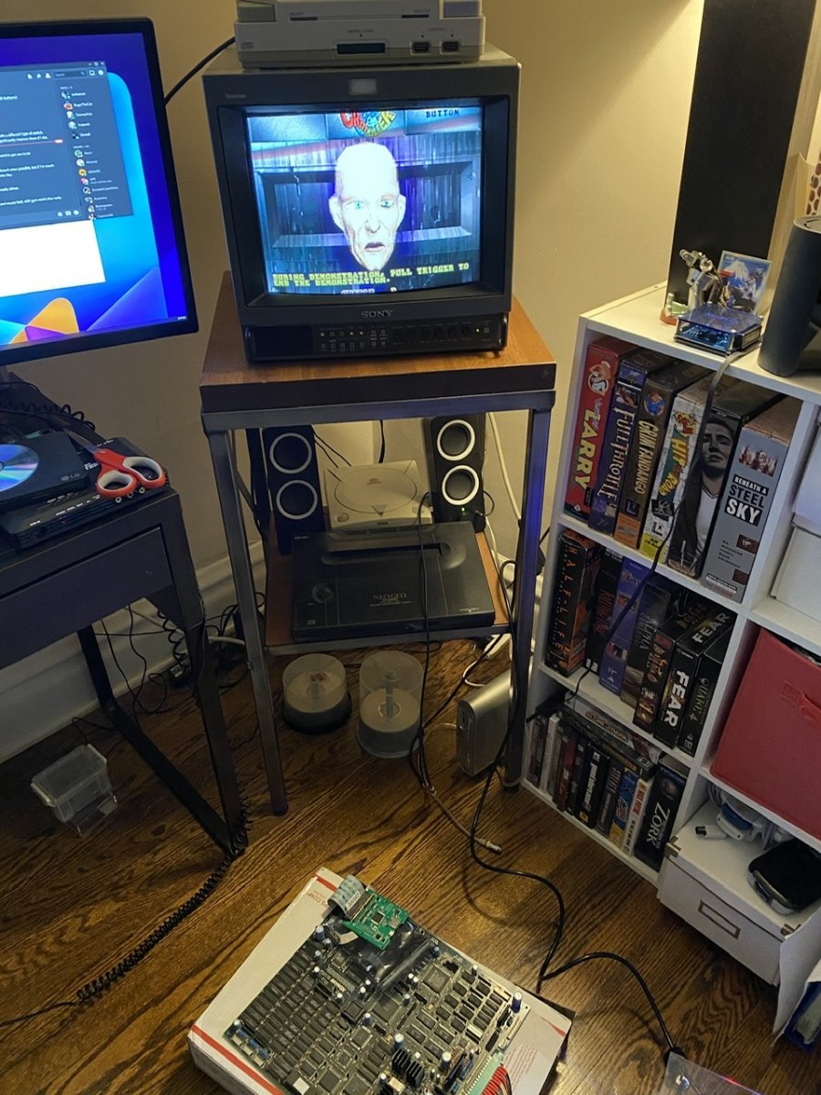

Pop the SD card into the SCSI2SD, reconnect the ribbon cable and press power! Should boot directly into the game!

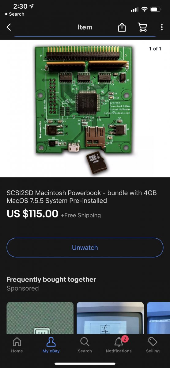

here is the specific SCSI2SD I used
