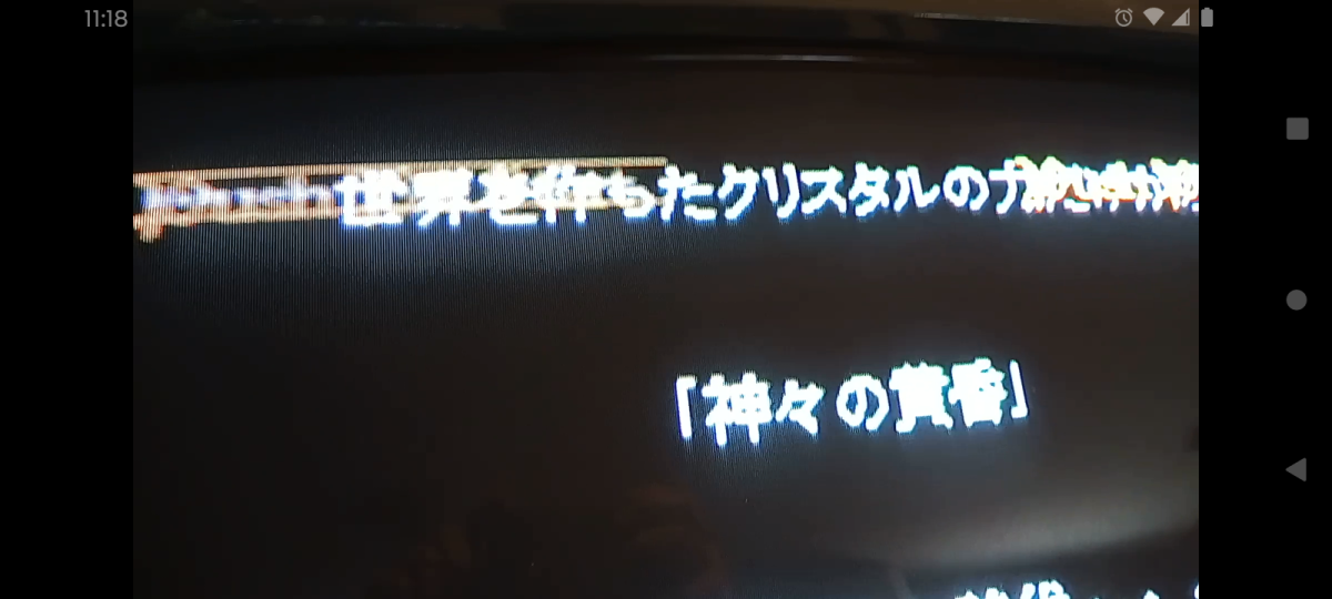

Good thought! I sent him an email today. Hopefully he can work on this board.You could send your PCB to Ken at irepairsega.com he can change caps and try to find corroded traces for you.
Appreciate the thoughts! Thankfully it looks like it has a CR2032 which has not leaked, and i don't see any evidence of corrosion.I'd start with a Recap.... I've owned 3 of these boards and they all had horrid blown out audio due to bad caps... that could also be the culprit in terms of graphical noise.
of course these boards are also prone to battery leak and the first area to get eroded after the battery circuit is the Video ram and CPU

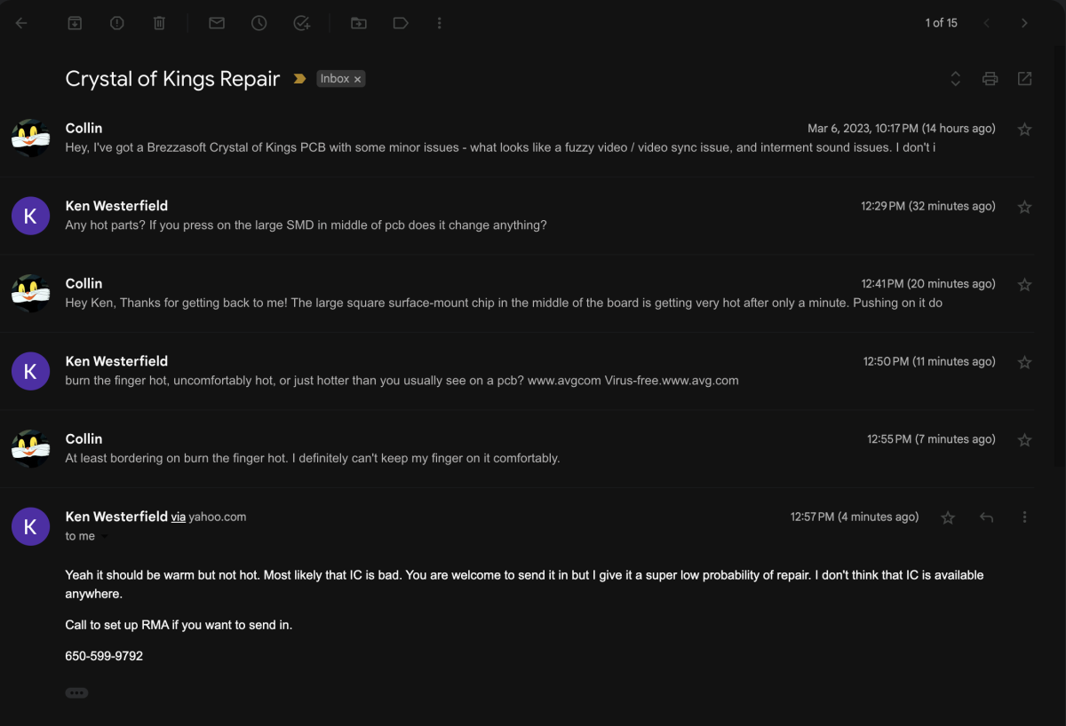

This was the first I'd learned of him working on anything other than Sega, but it seems he does. I got a response from him, which I'll share below. In short, it doesn't sound like it's repairable.
Ken gave me the OK to share his replies.
That's very nice of you! If Sheep Nova gives me the thumbs-up to send it in for potential repair, we may well take you up on that. That could at least help as a sanity-check to see if the main big square chip on mine is overheating, as Ken suspects.I live near Ken (talk to him a lot) and can at least have him look at my Crystal of Kings to compare yours to.
