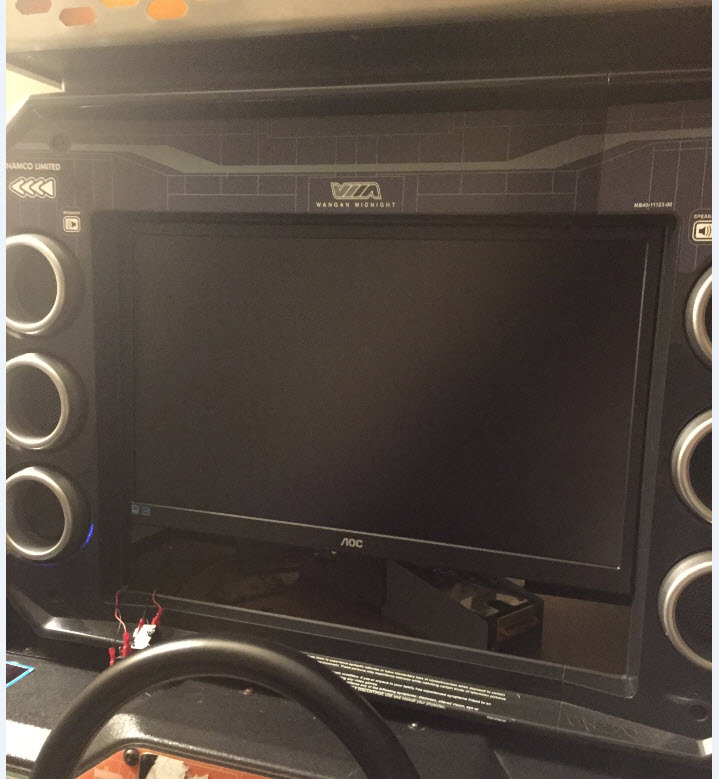

Good choice! For a minute there I thought I bought the same one you did but mine is only a 24". 32"s are harder to fit without getting widescreen. I did the same thing to my Max Tune cab since I am still working on the vertical scrolling issue on the CRT. I ended up just being ok with an LCD replacement and am working on covering up a gap at the bottom between the bottom of the monitor and the top of the steering wheel dash but the sides fit perfectly. Your application will be different but I found a monitor arm to be the best option to adjust the placement until you create a permanent mount for the monitor. I used this mount. There are cheaper alternatives but this one did the trick and you can mount it to the shelf within the cab. I could be guessing here but i think most cabs that house a CRT monitor have this shelf inside. I just forgot you're making a 'custom' cab so ignore my shelf comment, a monitor arm/mount would still be a good option.
As luck would have it, I bought a 24" AOC for $80 for some other reason but I tried it on here and the monitor fit almost perfectly within the Max Tune bezel (minus the bottom part).
