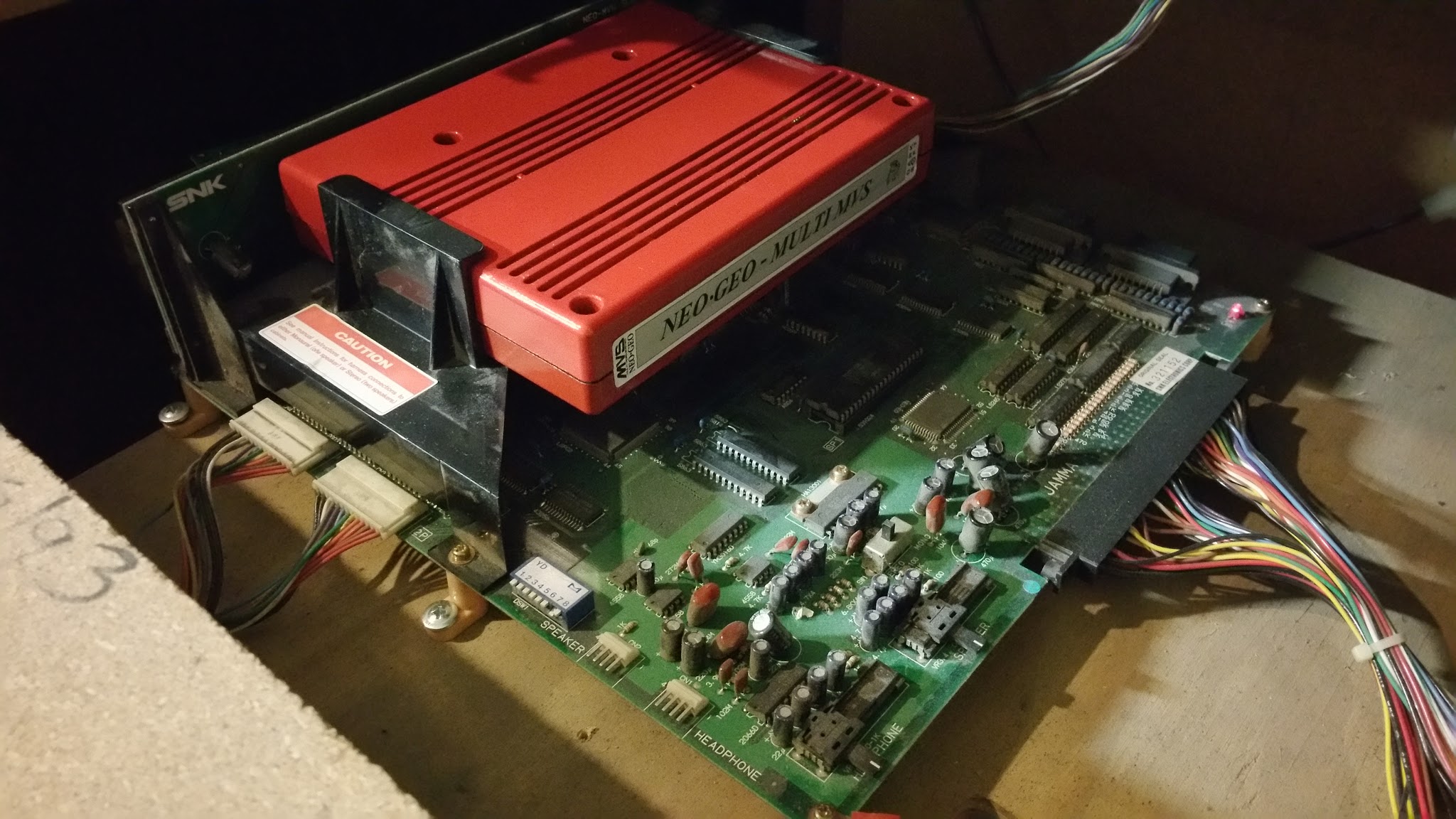

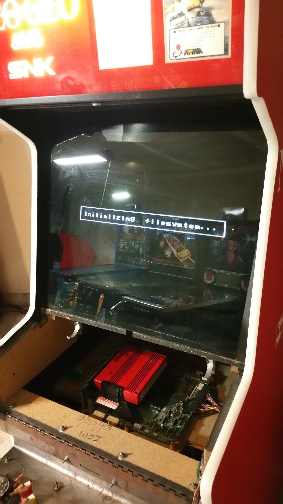

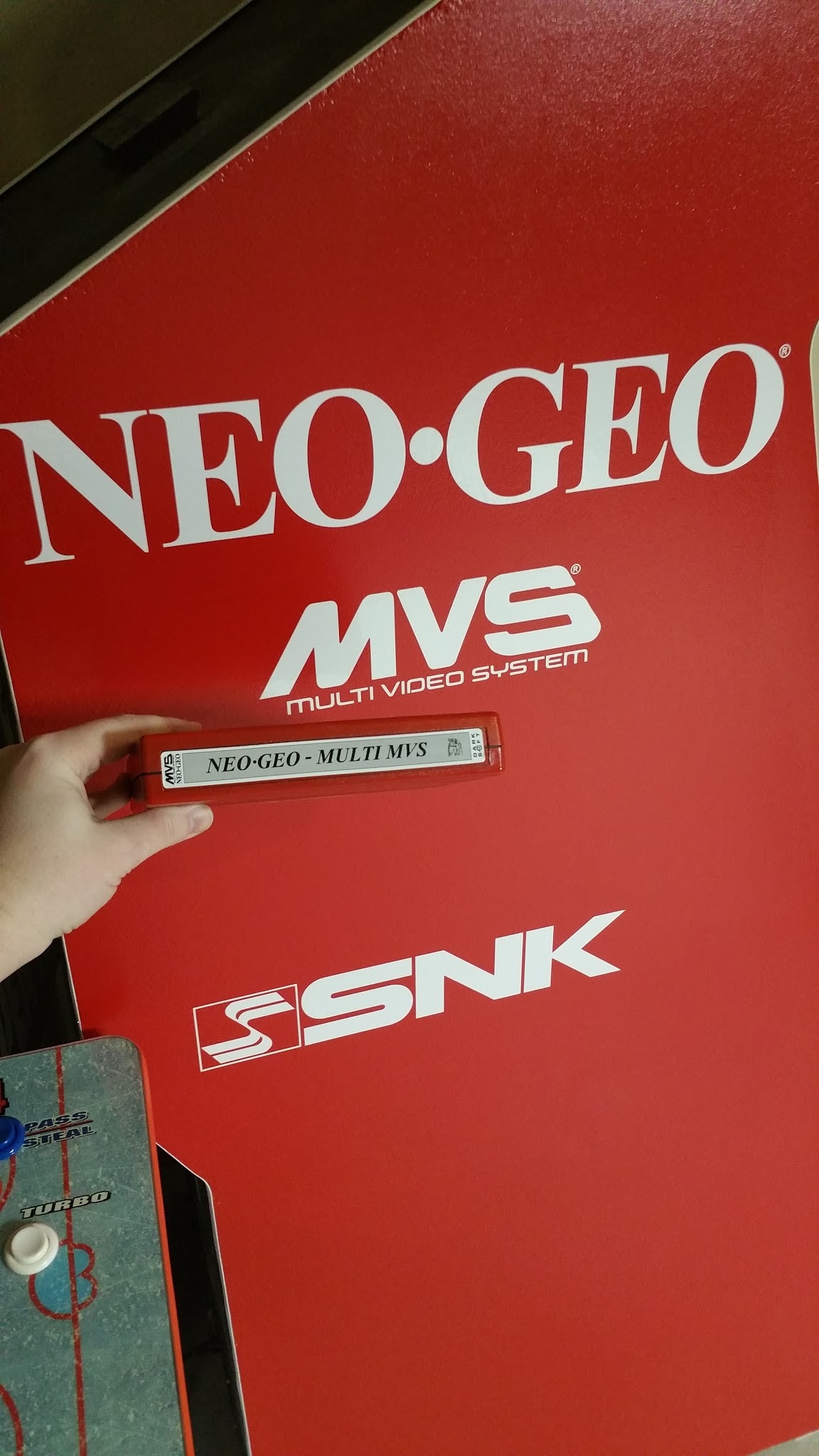

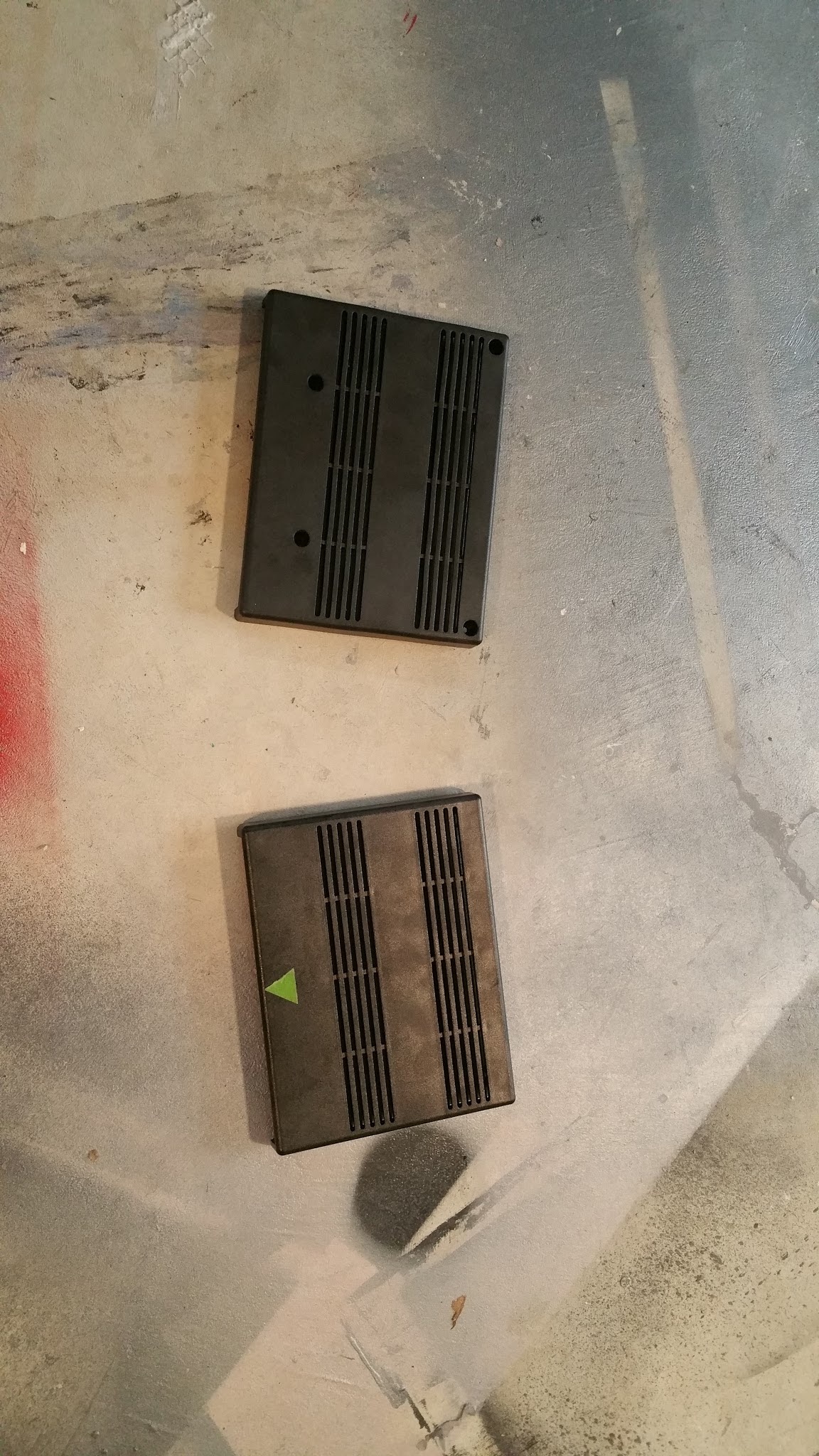

Decided to color my cart, mostly because every time I touched the thing I had grey stuff on my fingers.

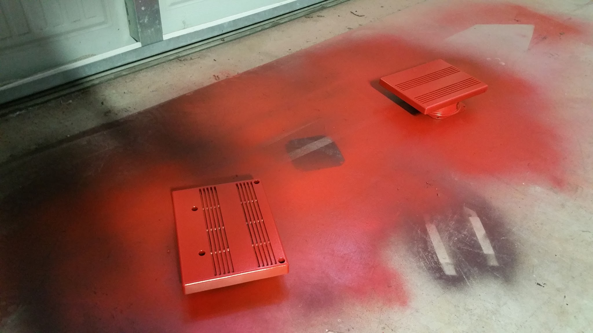

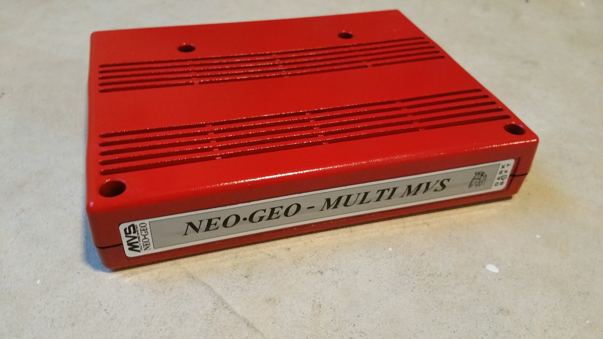

I cleared it, roughed the clear, couple layers of color, and a final layer of clear. Unfortunately I broke the fuggin SD card slot and had to send it off for repair. Prettiest paper weight on these forums though! :p

@Malenko: Wow, that color looks really great. I've seen some people do recolors before, but some of them end up having paint jobs that flake, or come off over time. I'm guessing all the coats you applied was to prevent that?
its all in the prep! You just have to go over the cart with like 320 grit to give the paint something to stick to. Do a quick first coat, let it dry for like 6 hours. Hit that with 400ish grit. Then do a final coat. If it doesn't look how you want, hit it with 400 or higher grit and paint again. When the cart looks how you want, finish with a clear coat. It locks the paint in, and adds some durability. @Mitsurugi-w got to see the cart first hand
