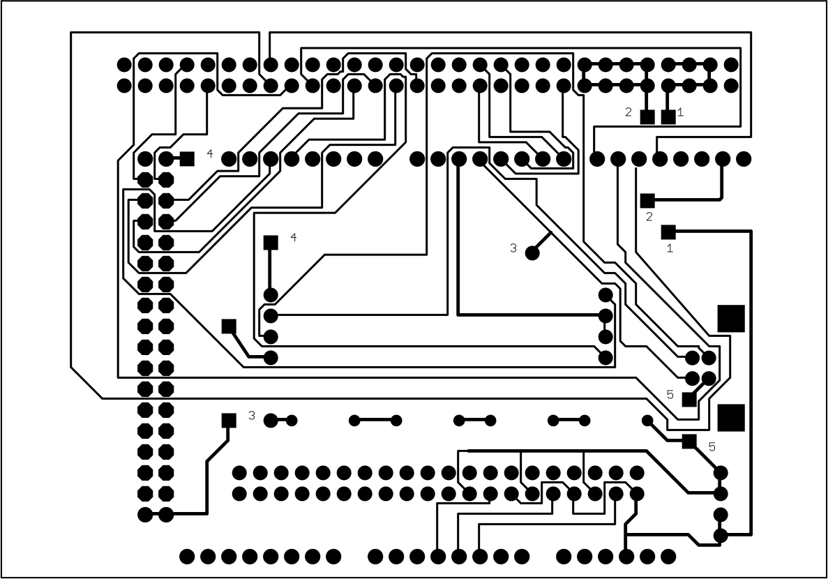

It occurred to me when I started thinking about mounting all of the headers and such for the cabinet wiring that I should be able to come up with a PCB using my CNC machine. That should make assembling this way easier! :D
So far I've got a draft finished, but won't be able to tell if I've got hole placement correct for the RS485 module until I receive it. I made this so it's single sided with only 6 connections that need to be bridged with an external wire.
At the moment it's only wired up to work exactly with OR2 controls with the additional pins needed for WMMT shifters. Once I get things figured out, it could be redesigned to accommodate more. The Arduino Mega should theoretically be able to act as a 100% pin-to-pin Type 1 I/O replacement. There are enough digital and analog I/O pins. I don't know if I'd be interested in maxing it out, though, as it won't be needed for my purposes.
This was my first time using Eagle. While not the most intuitive program, it's very powerful and I've figured out how to make it work the way I need it to and generate files I can use for CNC milling.

I've come to the conclusion that due to a combination of inadequate end mills and traces that are too narrow, that my PCB needs to be redesigned to allow for much thicker traces.
I've got a version of it that I'll test out. Since I'm currently attempting a single sided PCB, the main draw back to the new design is that it will require more external wires for manual routing. I've got it down to 12, which isn't crazy high and only double what I had in the first version of the PCB. After all the time I've spent on this, I could have just manually wired everything up on a perf board! :P
The custom PCB will be very helpful, though, since it will take care of most of the trace routing and the position of everything. Plus it's been a lot of fun learning how to use Eagle.
