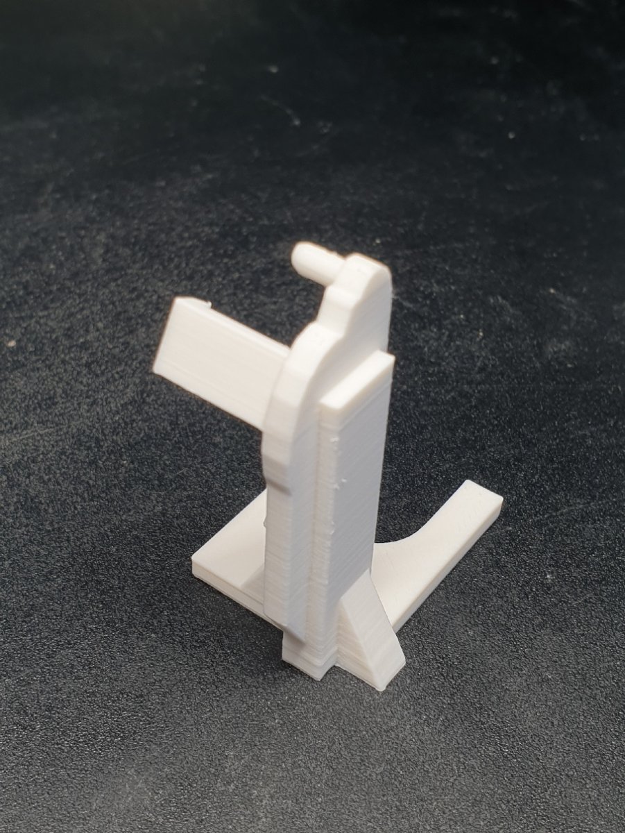

This is a microswitch mount for Cyber Lead cabs, that use the coin reject mechanism to ring in credits. This particular switch was pulled from a worn out Semitsu stick, but I think most switches should fit.
It should be installed towards the outside of the cab, or it'll hit the monitor bezel when the panel is closed. Use long wires, if you want to open the panel without disconnecting the switch first.
