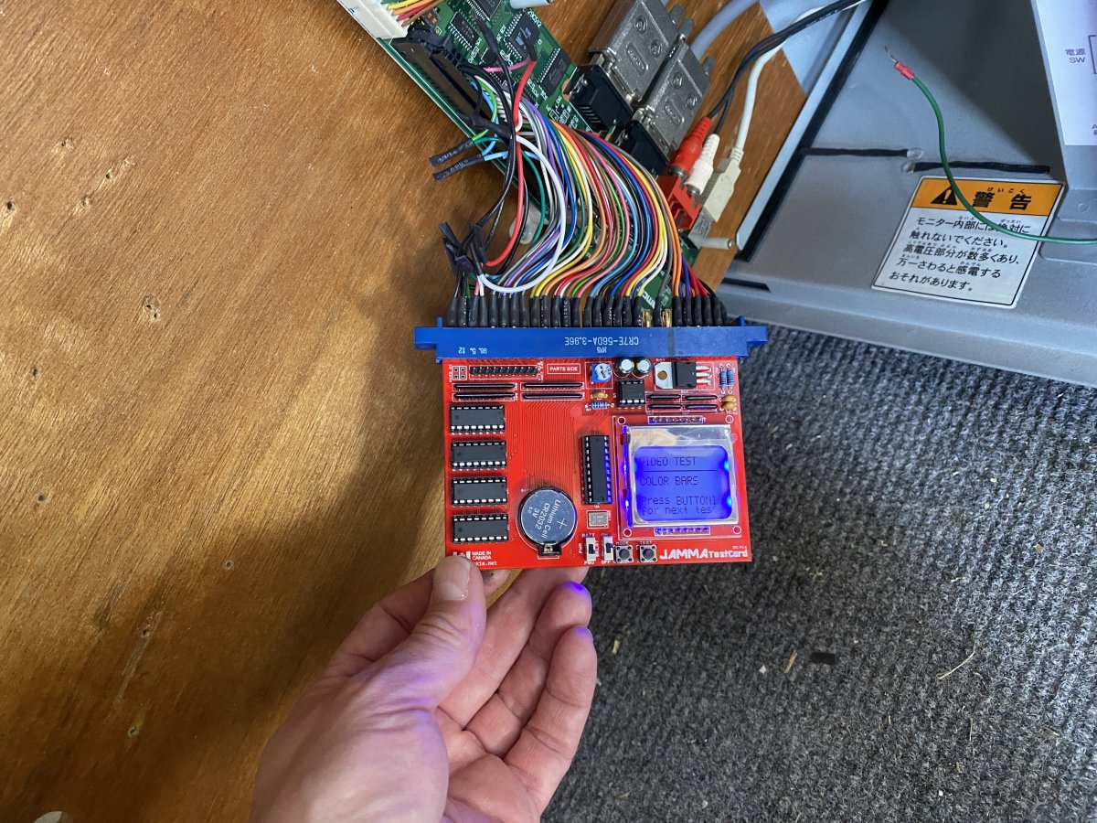

Sorry it’s a bit confusing I know. I don’t quite get why there’s a kick harness when the full 6 button signals are sent to the jvs/Jamma converter down the usb anyway. It’s obviously just now they had to design it. I’m going to be using Mistercade, but in my input testing with a Jamma test pcb which supports button 1-6 testing I’ve got various weird double button presses - the coin counter ticks over on one button, the speaker buzzes on another button press. I’ll try swapping usb cables and/or unplug the extra buttons harness.

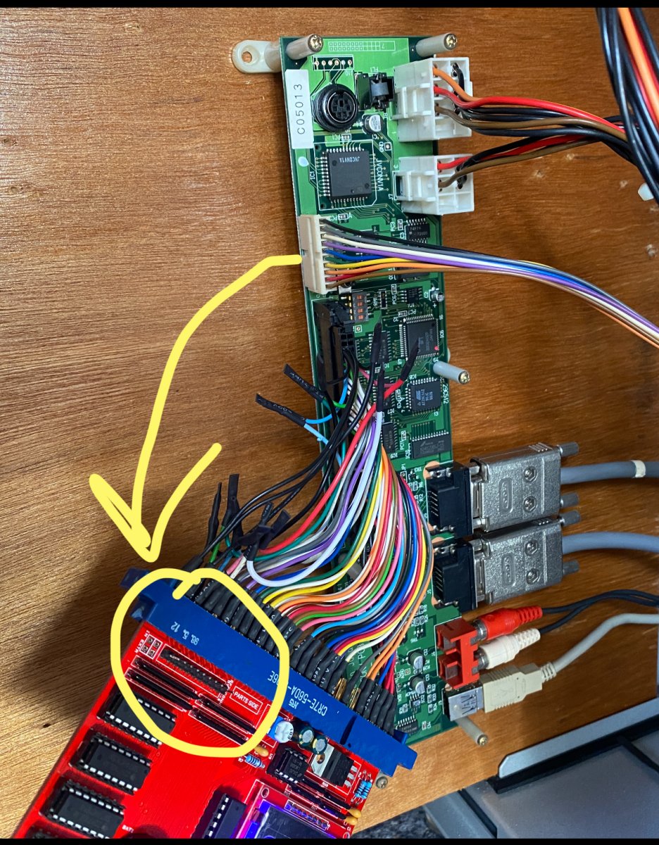

Thanks. It was all working before with Demon Front which uses three buttons. I recall the extra button harness wasn’t connected (not required). A previous owner cut a bunch of wires - button 4,5 & G and spliced them directly into the buttons - which sounds like they were using a chamma multi board maybe. But should one of those boards work on the Cyberlead if the extra button harness is plugged in? I’ve rejoined the wires and was testing with the tester in the attached pic. Working through this is helping thanks.

That JAMMA connector will absolutely not be passing all the buttons to that board. The Jamma/JVS board sends only 1-3 to the JAMMA connector, 4-6 are only on the kick harness. Since your kick harness isn't plugged into that board... I can see there's something plugged into it. Where does it go?
That kick harness connector on the board in your photo is OUTPUT ONLY. It goes to the game board. Whatever else you're connecting it to is wrong. I think we found your problem. ^__^

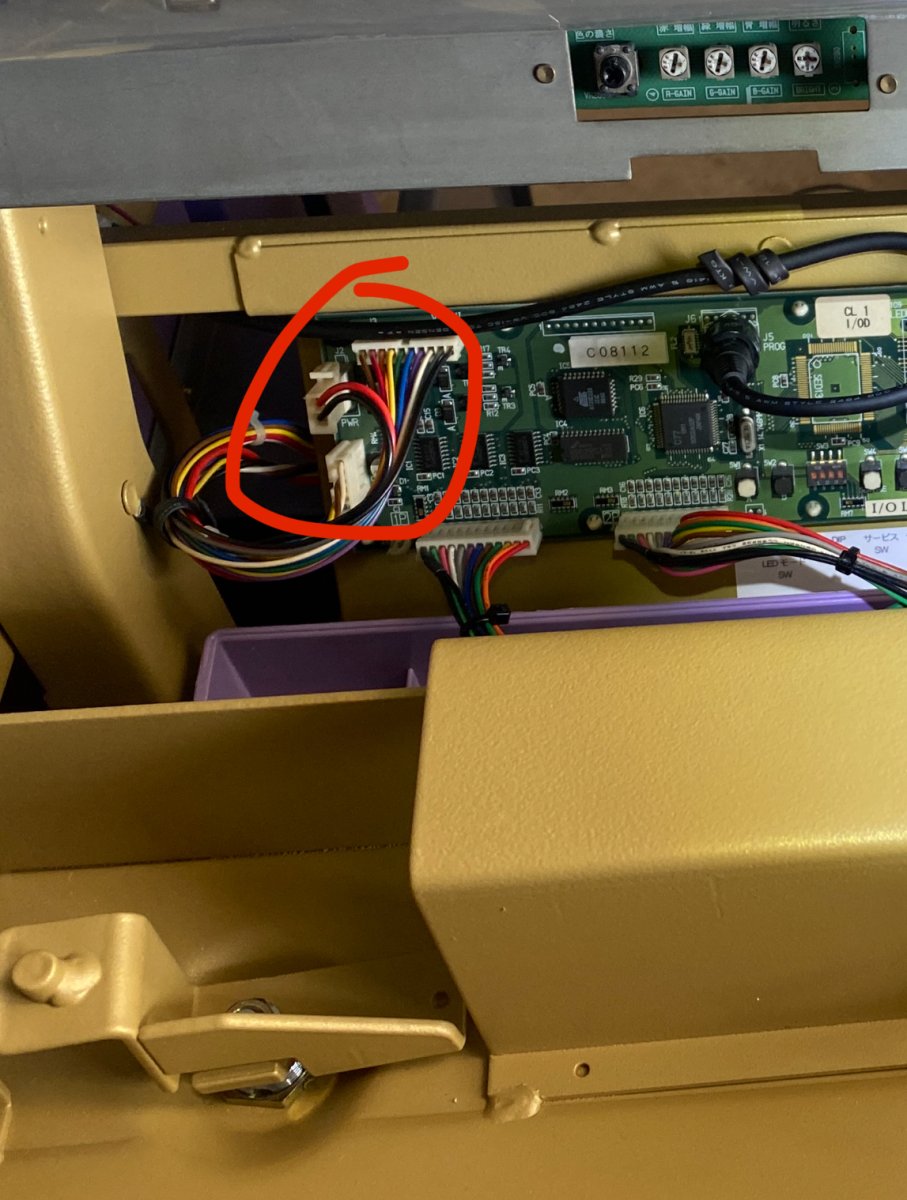

It’s going into the IO board.

That's wrong. The JVS I/O board runs all panel signals to the JAMMA adaptor board. The kick harness plug you're using connects to the JAMMA board, it doesn't go back up to the panel bay. You're treating it as an input. It's an output.
Cool thanks. I’ll change that tomorrow. So what plugs into the IO board once it’s removed? What is the purpose of that connector?

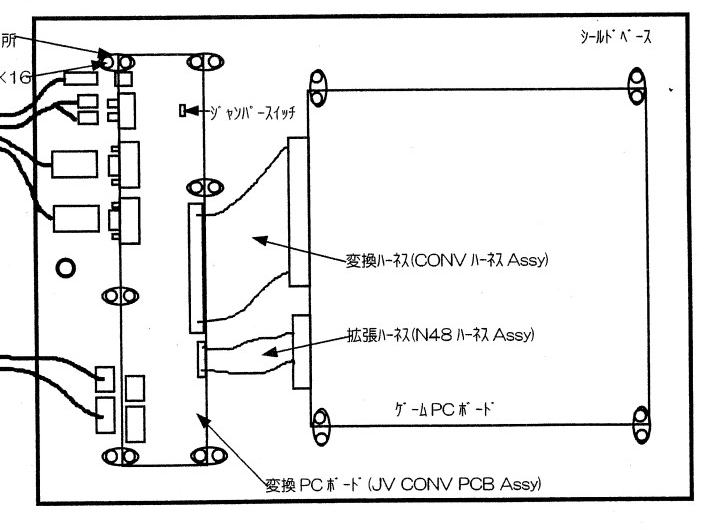

I discovered the the V MINI cable originally went to a board that shipped with the cabinet. The manual says to remove it and then put in a JVS PCB and plug everything else back in except the EL connector. So that explains the left over cable. I’m guessing they had to ship the cabinet with some very rudimentary game in it perhaps?
