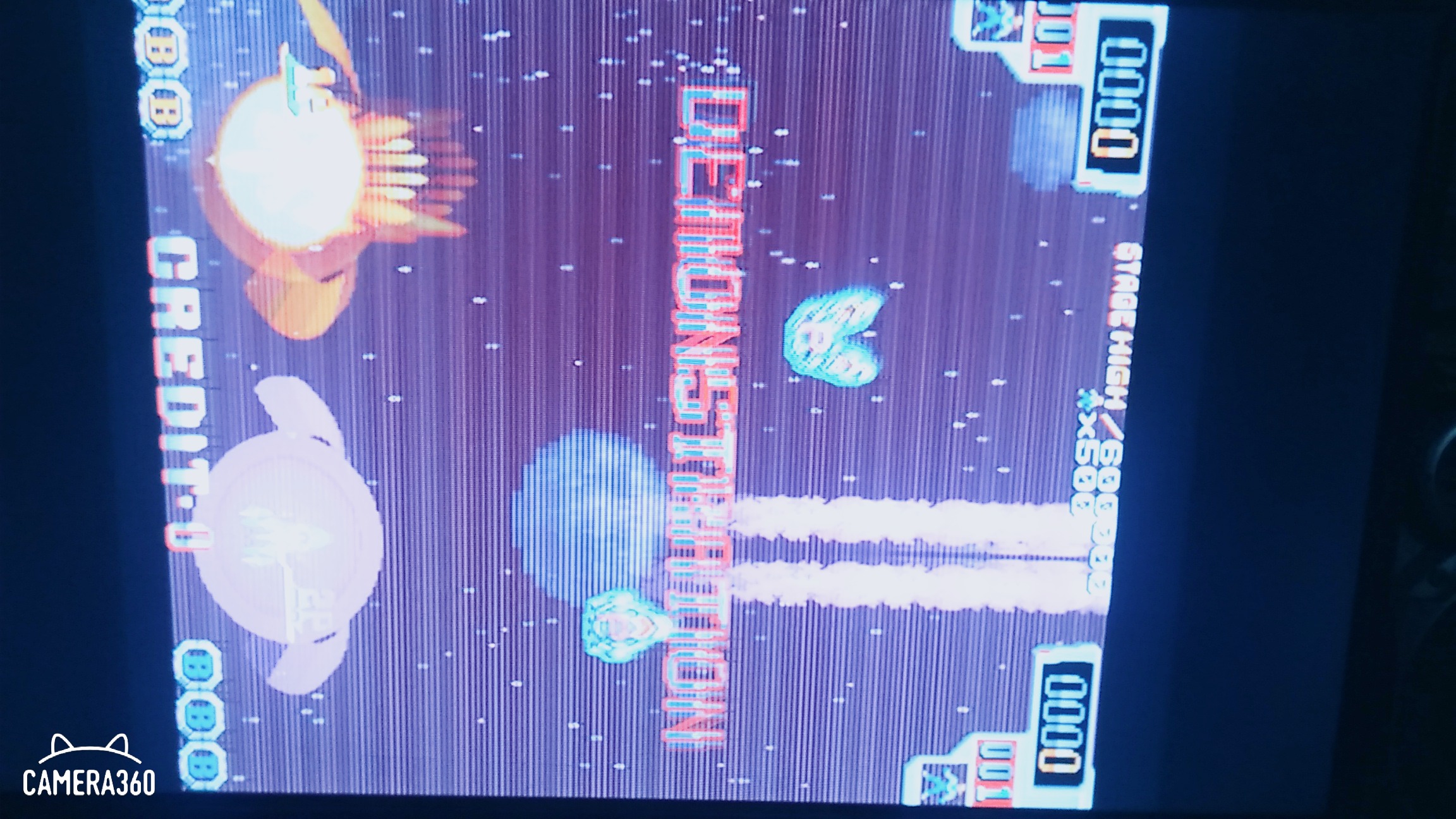

ArcSys101 Grand Master Joined Aug 28, 2016 Messages 1,581 Reaction score 619 Location Manila Philippines May 27, 2020 #1 Dangun Feveron Has Background lines Battle Bakraid Sometimes working sometimes not booting Help Attachments C360_2020-05-27-20-33-10-973.jpg 716 KB · Views: 218 C360_2020-05-27-20-33-19-418.jpg 664.2 KB · Views: 142

XtraSmiley Legendary Joined Sep 18, 2016 Messages 5,289 Reaction score 4,756 Location Washington DC May 28, 2020 #3 I'm not the expert here, but quick questions: 1. Any PCB damage? Any cut traces, broken components, bent pins, or bridged traces? 2. Was it working before? 3. Re-seat all the EPROMs. Can you post clean picture of the PCBs?

ITATTRACTS Enthusiast Joined Jan 17, 2020 Messages 126 Reaction score 129 Location Brooklyn, NY May 29, 2020 #4 I see these same lines occasionally on both of my superguns. A quick cleaning of the Jamma edge/connectors and a firm reseat usually clears it up. If you are getting funkiness in two different boards, maybe start there.

ArcSys101 Grand Master Joined Aug 28, 2016 Messages 1,581 Reaction score 619 Location Manila Philippines May 29, 2020 #5 The board is very clean Maybe im gonna give it another good cleaning in the jamma edge
rewrite Multi Boyz Litigator Immortal Multi Boyz Joined Nov 9, 2015 Messages 8,689 Reaction score 8,744 Location SoCal May 29, 2020 #6 ArcSys101 said: The board is very clean Maybe im gonna give it another good cleaning in the jamma edge Click to expand... Try cleaning the supergun JAMMA connector too. Can't hurt anyway!

djsheep Multi Boyz Overlord Immortal Multi Boyz Joined May 20, 2016 Messages 8,483 Reaction score 15,834 Location Brisbane, Australia May 29, 2020 #7 What setup are you using? From memory I had issues like this with my Boardmaster Control Box? Could also be your video cable if it’s a supergun?

ArcSys101 Grand Master Joined Aug 28, 2016 Messages 1,581 Reaction score 619 Location Manila Philippines May 29, 2020 #8 Now they have a red running in background in start up with the warning
