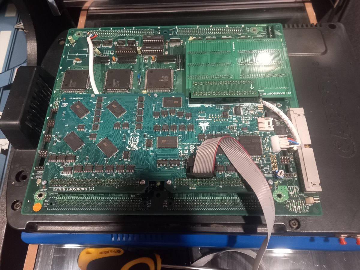

Hi everyone my names Jared i recently decided to take the plunge and buy a Darksoft cps2 multi. It seemed easy to setup i had someone experienced to solder the key writing wires as it was a bit small for me to attempt. But i cant seem to get it to work i just get a black screen no sound. Everything seems plugged in good and the game selector flashes the game i select, Ive got no clue what to do hoping there is something easy im missing i know the arcade cabs good i tested other games on it.
Any help would be great i really want to get this badboy working
Can you check your 5v and 12v readings?
Can you also check the interconnect board and make sure the pins are all the way down on the multi and sub-PCB, and the pins on the sub PCB are all the way down on the CPS-2 board.
It's worth trying Decrypted ROMs.
Do you have another CPS-2 board to test in your cab? What does the brightness your LCD selector look like?

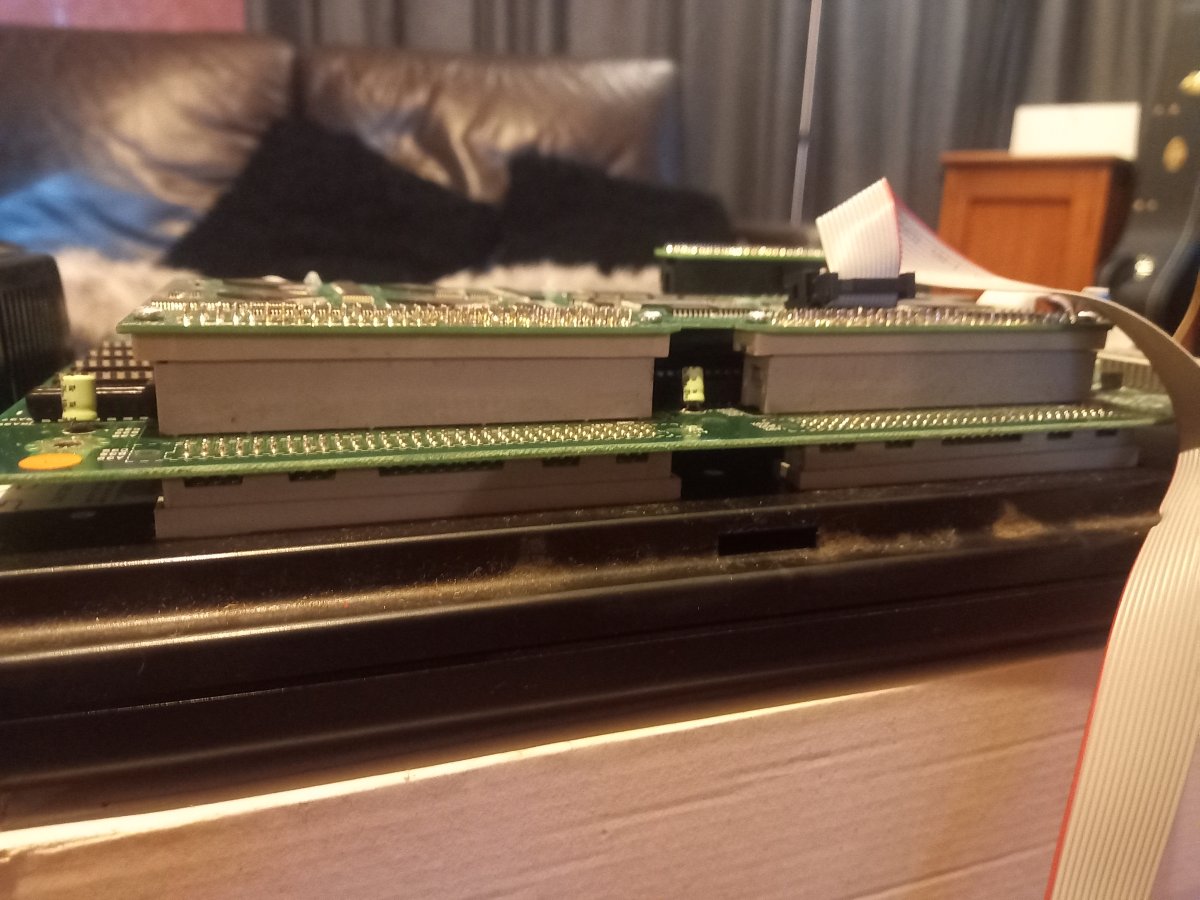

Yes, please carefully remove the multi. Taking care with the pins. Be gentle and even in your lifting and all should be fine. Make sure everything is then replaced flush and all the way down. Take care with the interconnect and sub boards and make sure they are all the way in (up and down) at each respective point.

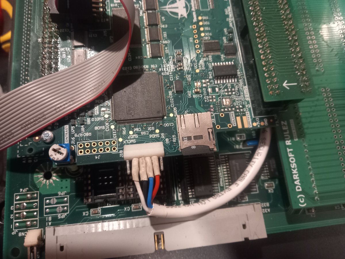

I disconnected all the boards. One of the boards had some white marking on the back of the solder not sure if thats a problem.
I reconected the boards they all seem tight and all the way down but its hard to see the small conections in the middle of the board,

I'm confused, did the key wiring not go to a socket on the game board? Or is this if you have older boards? How does the legs of the different darksoft boards look? Nothing bent by accident?
Some CPS-2 motherboards have a JST connector and you can use a key writing wire directly from the multi.
Others, such as the one in this install, you have to solder directly to the CN connector.
It's worth beeping with a multimeter between the motherboard and multi to make sure continuity is strong.

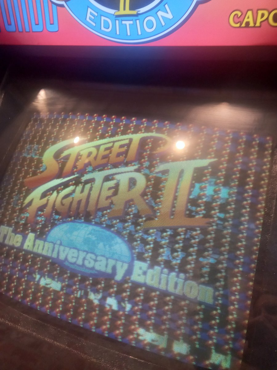

Alright definitely made some progress not sure i like what i see though. I tested continuity and all boards seem connected good i connected it to another motherboard and i got this
I tried disconnecting the boards and jamma harness a couple of times. I also left the resistor alone since its loading up games now. Any ideas?
Clean the pins on the boards.
Does pressing down on the multi to the cps-2 motherboard fix the issue?
No pushing down does not change anything. i will try cleaning the pins should i disconnect the darksoft boards and clean there pins aswell?
