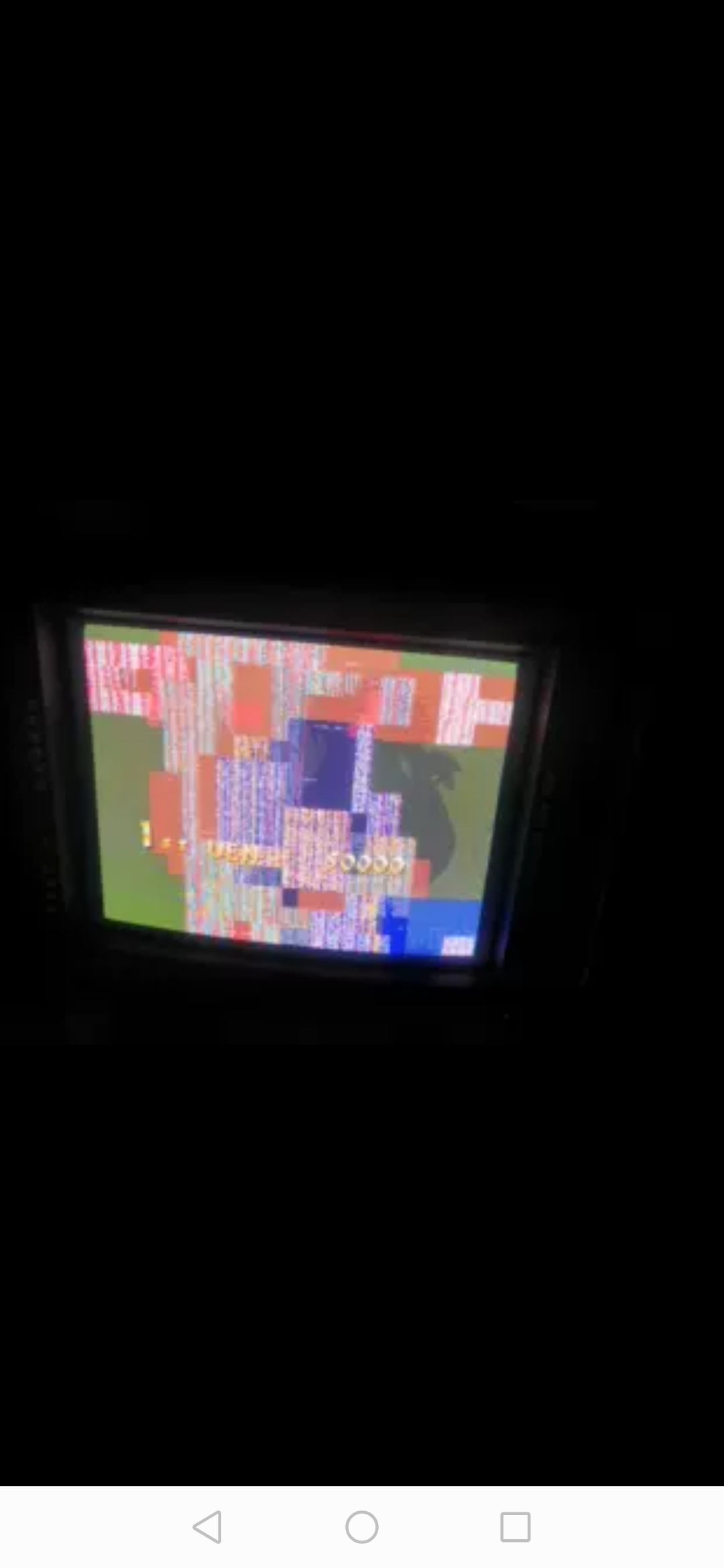

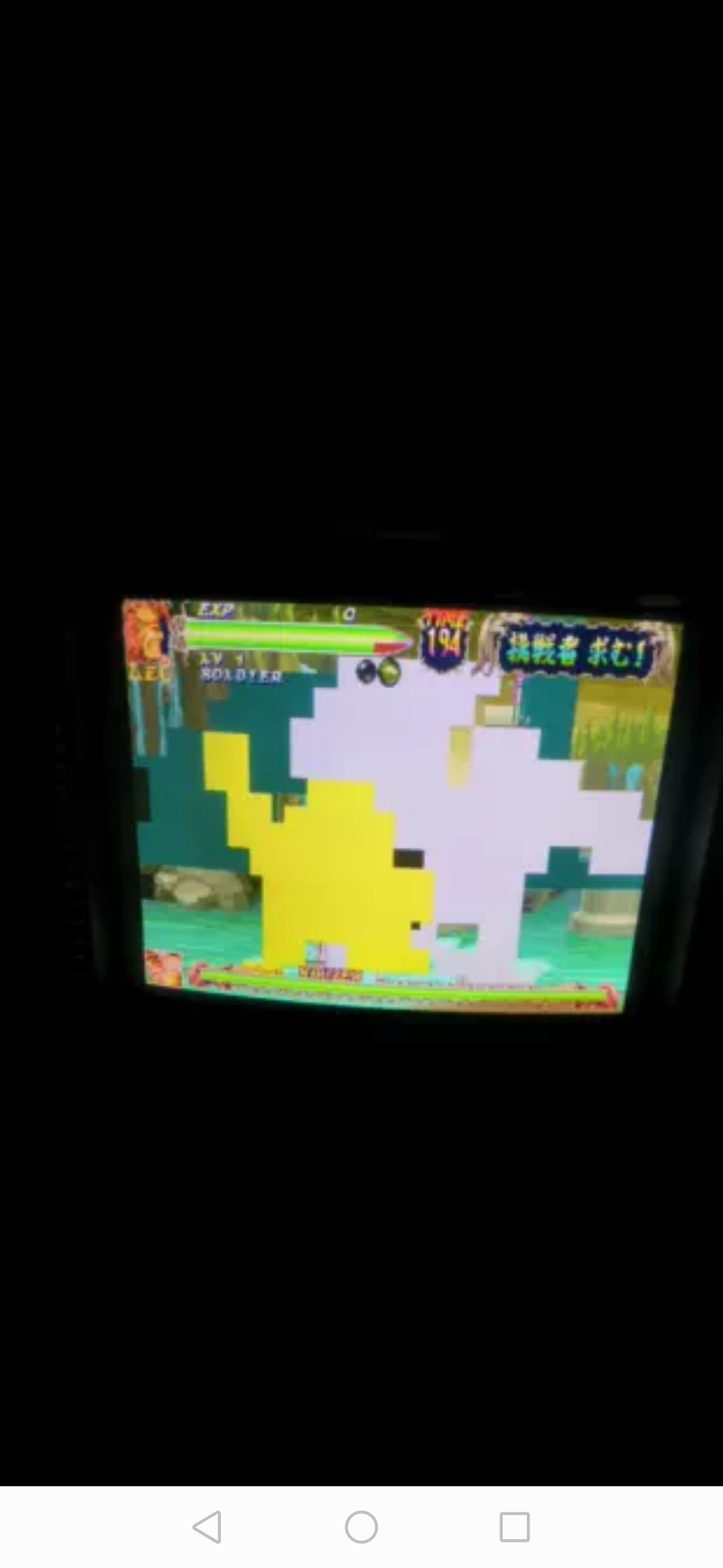

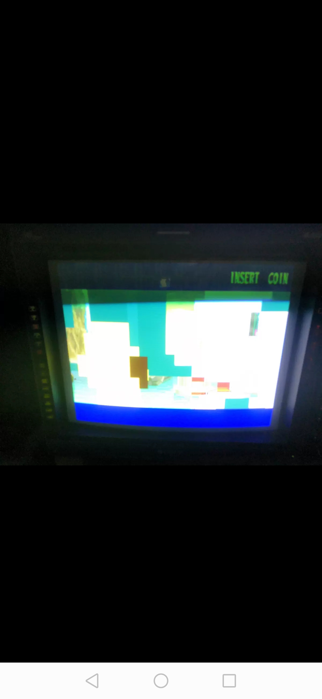

I get some problem with my super bios, sf3 4 games run normal, but warzard, jojox2 get garbage screen, what can i do now? Simms is good (checked)

Well, do you another CPS3 mobo for swap test ?
I have several sets of multi-carts and mobos, never saw this issue before.
Seems like the data on SIMM/from CD was corrupted. Can you burn a new CD for a trial ?
I think the best way is to get another set of board for swap test if you do not have a good way to isolate the root cause... :| :|
I try to run a memory check with darksoft's internal program. Something similar happened to me, it was a Flash capsule that was defective and at the time of taking temperature it produced the failure
