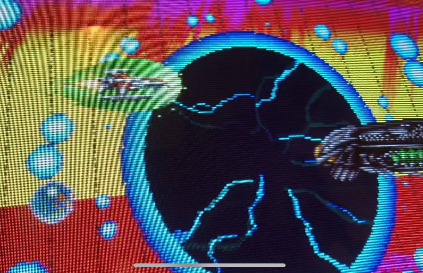

Everything works on my new Darksoft Taito F3 multi except for an annoying intermittent graphics issue that only seems to occur in certain scenes (see photo from Darius Gaiden Extra). I’ve tried reseating the board and multiple cabinets. Any thoughts?

This "tear" is a known issue with HD15/VGA sources and the sync clean value of the OSSC.
NOT related to the F3 in anyway if so.

Sorry, here's the image:
I've downloaded the fixes for Zone D background and will apply them tonight to see if it resolves the issue...

Yes, I've tested the (now region-free) EU motherboard with an original Bubble Symphony cart which works fine. The tearing issue seems to arise in scenes like the beginning of Gekirindan and Darius Gaiden Extra where extra textures are being used for special effects, so I'm not sure if these games are doing something that Bubble Symphony doesn't....

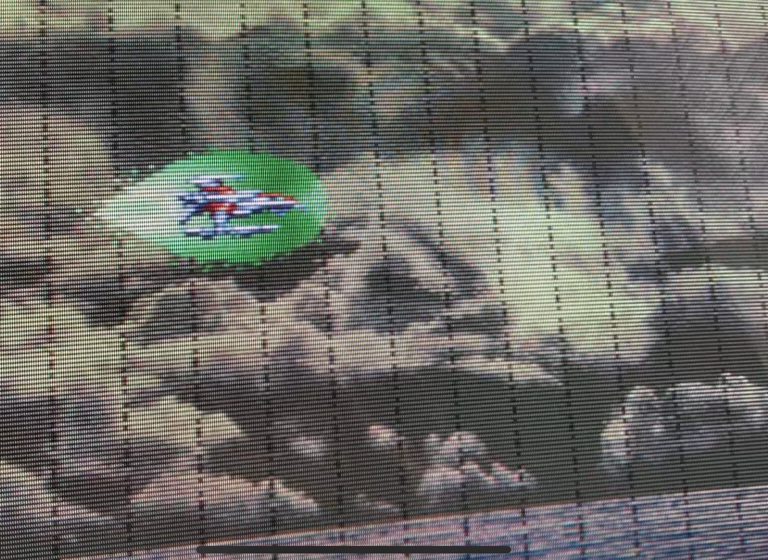

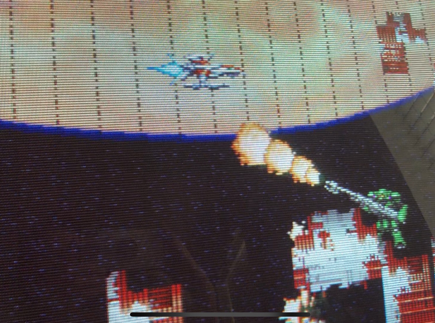

- graphics glitches in specific scenes & areas of the screen continue (see photos below). Doesn’t affect the entire screen, only specific graphic areas (see moon below).
