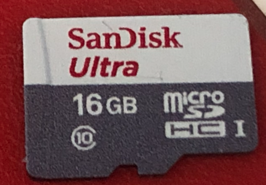

Can you post a picture or link to your microSD?

I post a photo of my brand new SD (same specs for the second 32GB).
Thank for your help

That microSD that you have is good as well. Are you using a PC or a MAC?
