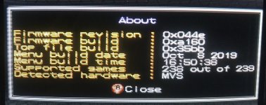

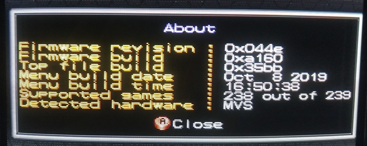

I update both menu and firmware simultaneoulsey, everything is OK. I read:
Firmware version: 0x44E
Firmware Build: 0xa160
Top File Build: 0x35bb
Menu version: Oct 8 2019
Is it correct? Someone said the Menu version is Oct 18 2019... but in my console there is "8"

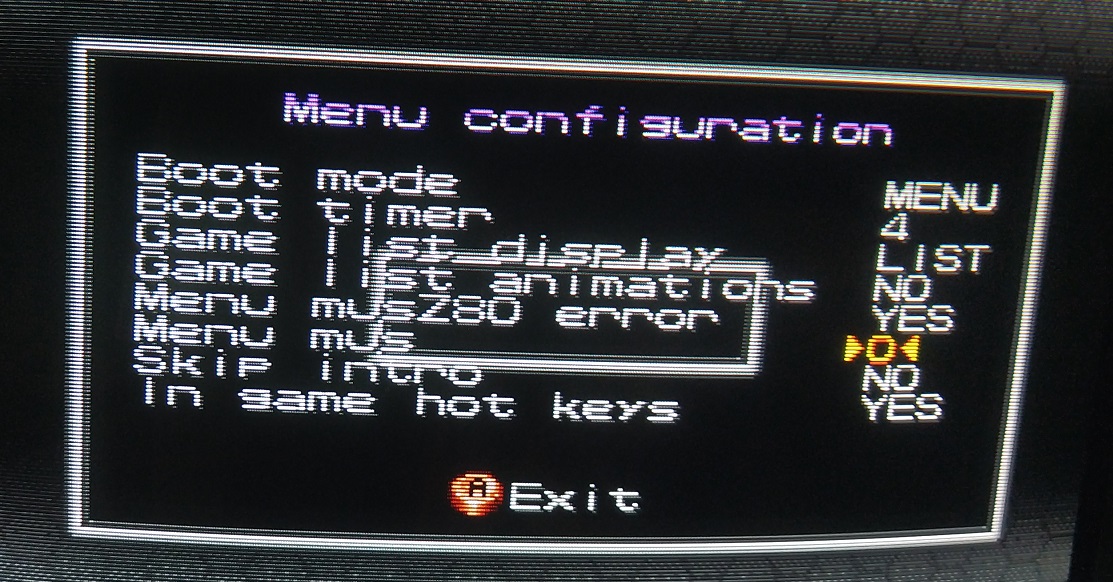

I'm afraid I did something incredibly stupid and updated my MVS cart with the AES firmware and menu.
I went back and put the latest firmware and menu for MVS but now I have no sound. Tested with a real game and my MVS still has sound. Tested on an MV1A and MV1FS.
I hope I haven't damaged my cart :/
could be a clpd file Problem.
try to use a older Version of that file or perhaps darksoft can give you one.
