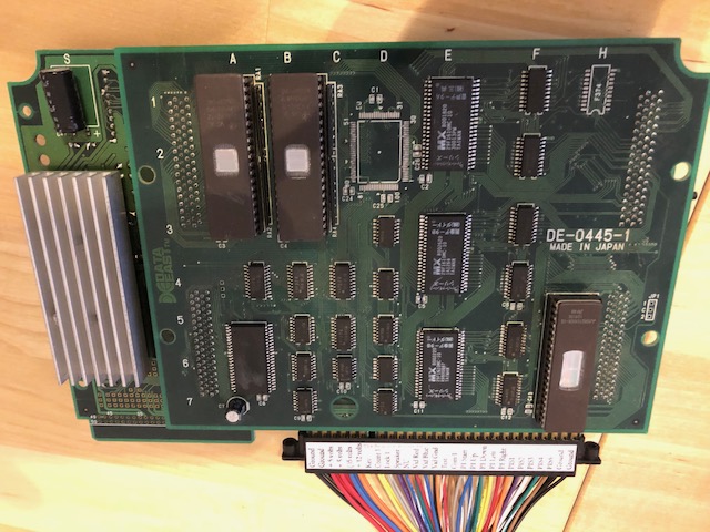

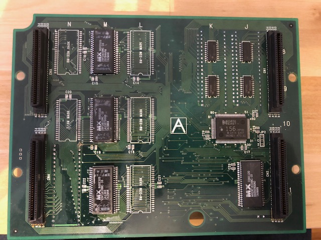

Here is what little I know from my street hoop cart. The whole assembly splits in half seemingly to a mother and rom board (Which kind of negates the name). A couple roms are socketed, in the case of street hoop you can update revisions with those roms. The rest is soldered from what I remember. I can open it for pics if that would help.

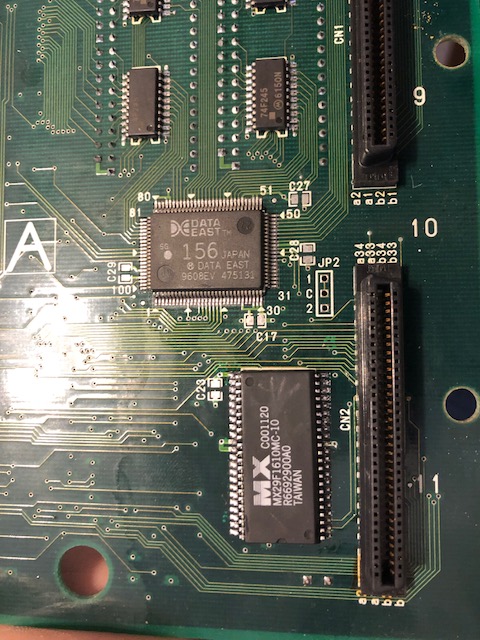

Bought a conversion MLC from Sheep - from what to Skull Fang I dont know but here are the pics.

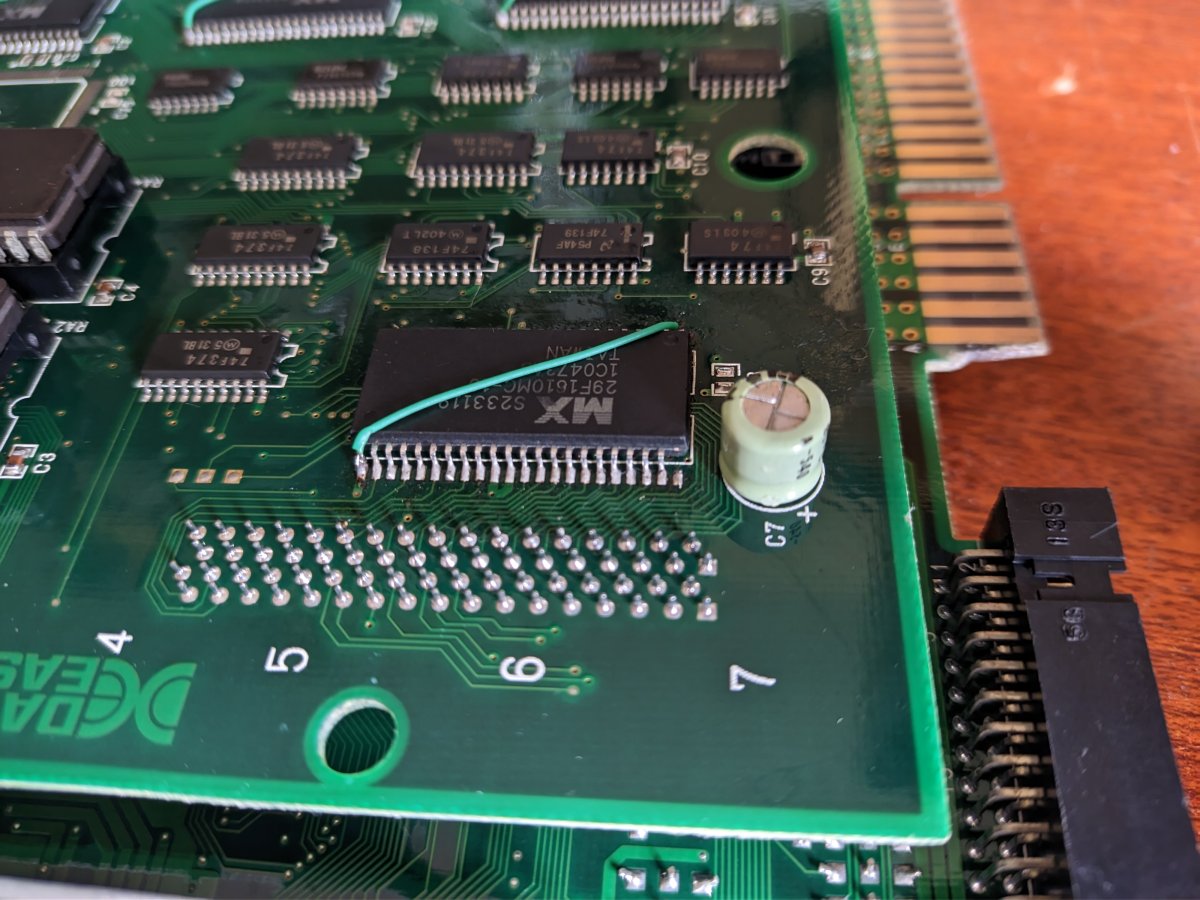

Hi again. The conversion is possible. Only a few tips. These boards doesn't have WE signals, so you must put them at hand with a cable. Remove the 146 custom, make the WE signal union (pin 1 to +5V) and also lift the pin 44 on the 2 YMZ sound memories (WP signal, is a bit crazy in this board on that zone)
