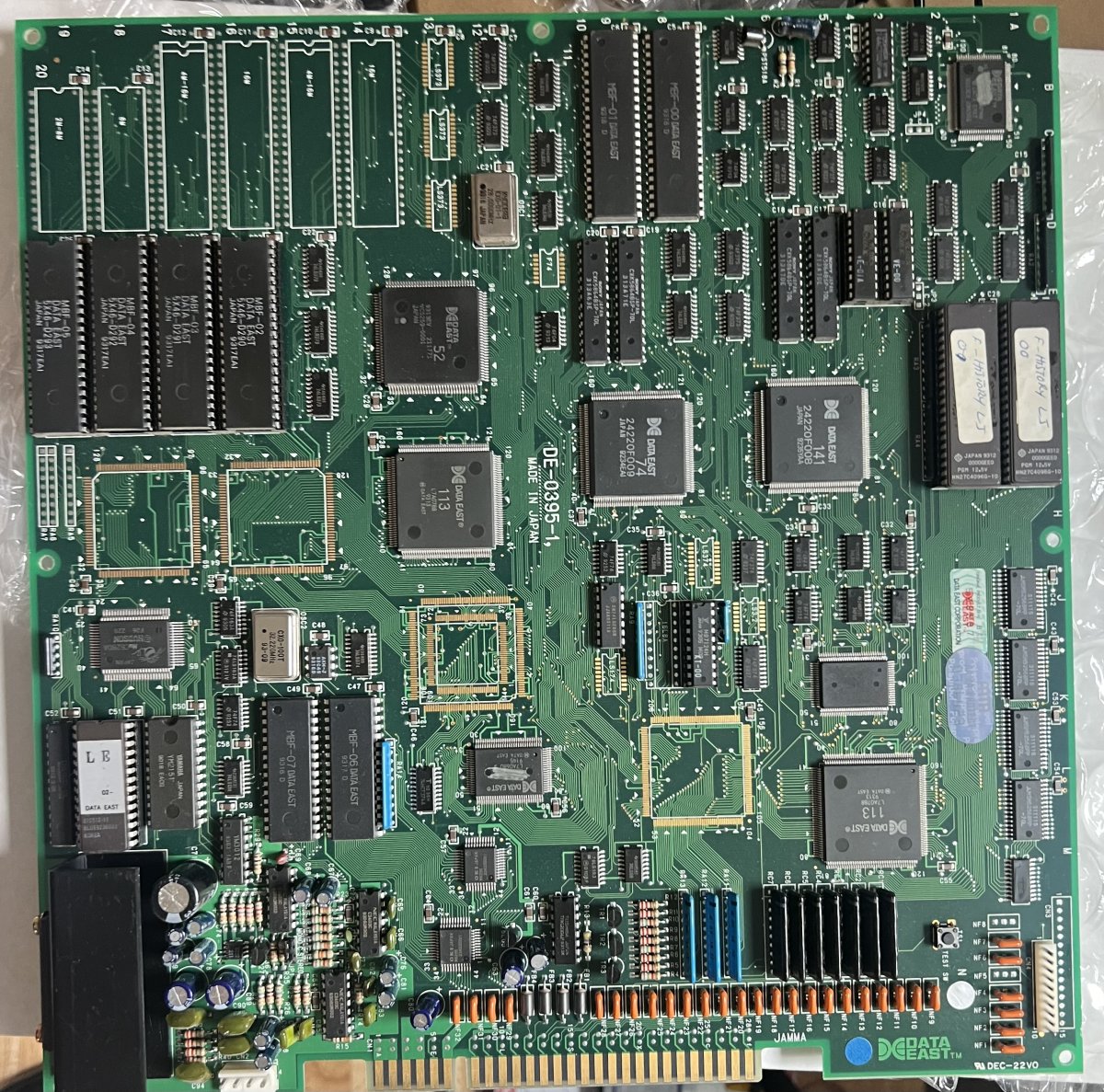

So I transferred everything from a working completely corroded DE-0397-0 board to a DE-0395 (NO COMMA) working board and I'm getting a screen that basically shows that it's not doing anything. There has to be something different on the comma board vs the non comma. Anyone have an idea?
The comma one has a comma!
But for real here’s a photo if it’s helpful. I can do higher res of any section if you need. Maybe less compression here https://imgur.com/a/NXi42U4
Thanks, but I think this will require a little more looking into hah. What specifically is the difference between the one with a comma and one without? Most likely the only way will be to compare both in person heh.
Yeah, I only have the comma one which is why I posted a photo. You said it was rare so there you go! Thought you had the no-comma one. Lmk if you want me to probe anything
