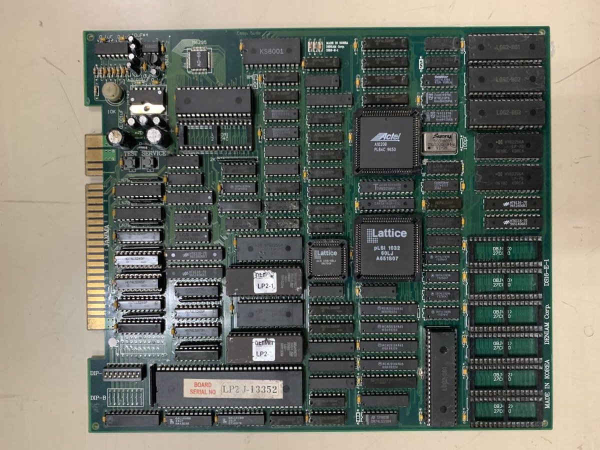

My Logic Pro 2 PCB is labelled DS16-E-1.

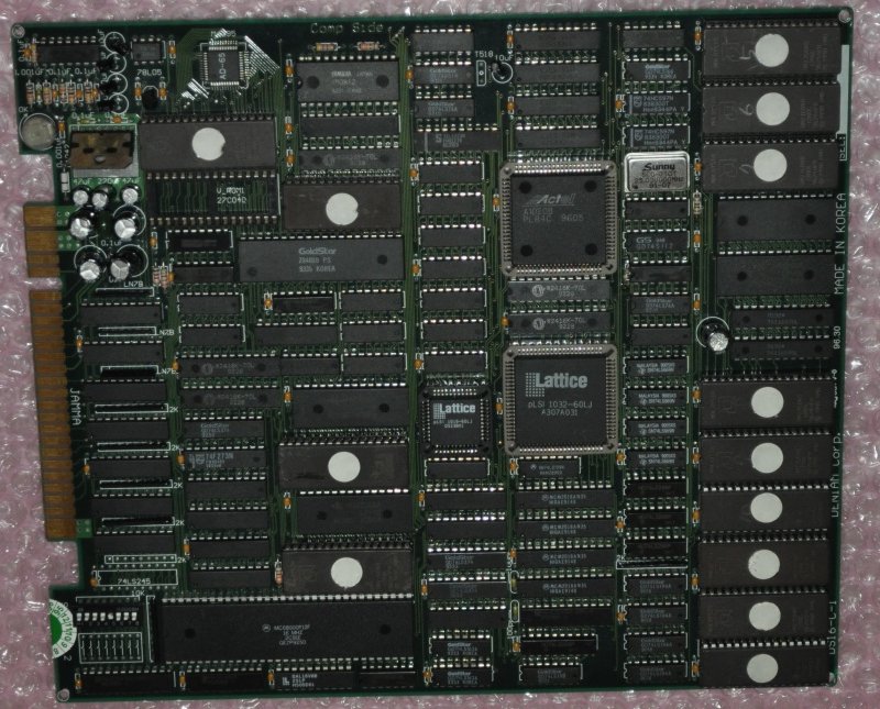

And Croquis (euro Logic Pro) is labelled DS16-C-1

MAME: "deniam-16b" = PCB: DS16-C-1
MAME: "deniam-16c" = PCB: DS16-E-1
Functionally it seems that the DS16-C-1 PCB and DS16-E-1 PCBs are pretty similar.
the older DS16-C-1 hardware includes a Z80 CPU for Audio, along with a dedicated ROM with the audio CPU code. while the DS-16-E-1 does NOT include the Z80 and the audio program is integrated into main program code.
MAME Driver seems to imply that the address map is the same across these games, and there doesn't seem to be protection that I can see, so it's likely that a ROM swap is possible so long as you're swapping to a game using the same DS16-C-1 or DS16-E-1
I've got both PCBs and will test this out at some point. but open to others who might be interested in testing and contributing.

Logic Pro 1/Croquis (DS16-C-1):
Karian Cross (DS16-C-1):
Logic Pro 2 (DS16-E-1):
