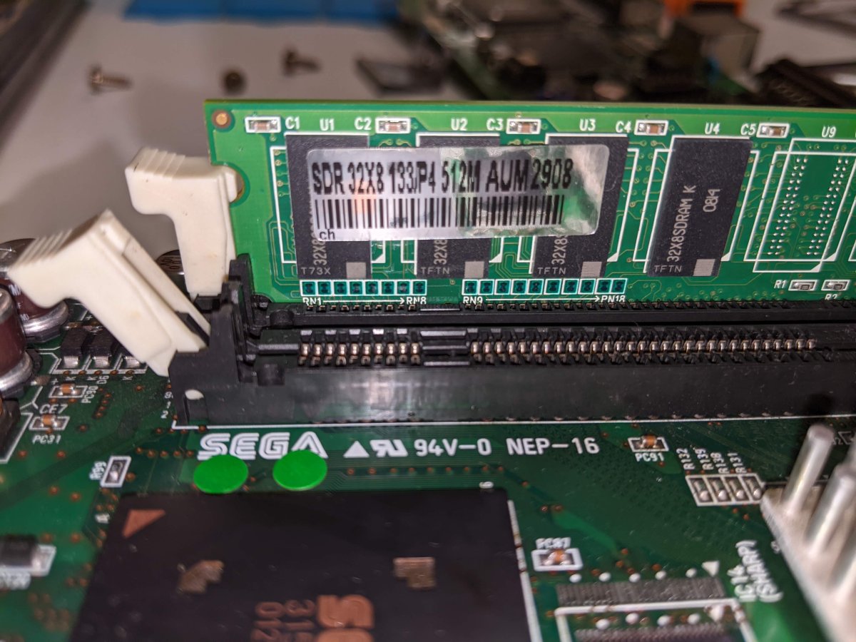

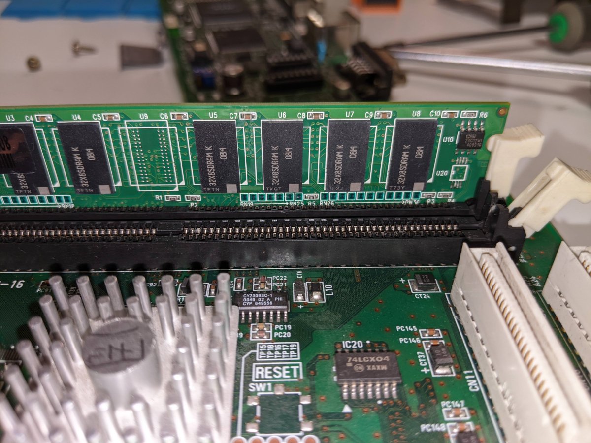

I ended up getting a new (to me) 512mb stick on eBay and it works first time every time. I didn't take note of the brand.
That's interesting about replacing the slots though.

I got the ram from this ebay listing, which is non specific: https://www.ebay.com/itm/330480793925
