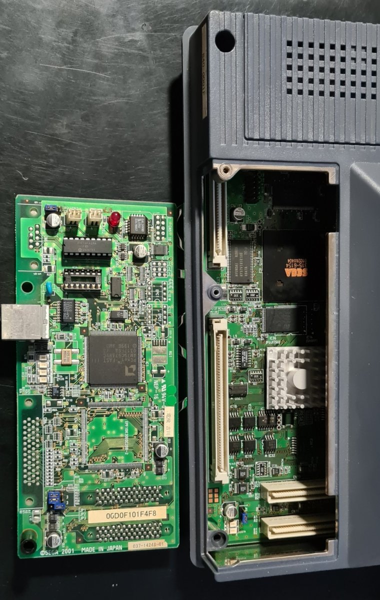

I just dropped this 4.02 binary from @Tailsnic Retroworks on a regular dimm and have it booting from CF right now:
https://segaretro.org/User:Tailsnic
It was the third dimm I tried updating. The first two black screened or Error 22'd. Both started working when I soldered the original bios back.
strange, I have updated my 4 dimm that I have, (1 SCSI, 2 only Ethernet and 1 SCSI/Ethernet) and they have worked without problem with firmware 4.02 that @Tailsnic Retroworks Snic once uploaded. even with CF adapter from arcademodbios. What hasn't worked for me has been the CF adapter from @tecfutur, which seemed very small and practical.
all dimms I have previously had firmware 1.02
