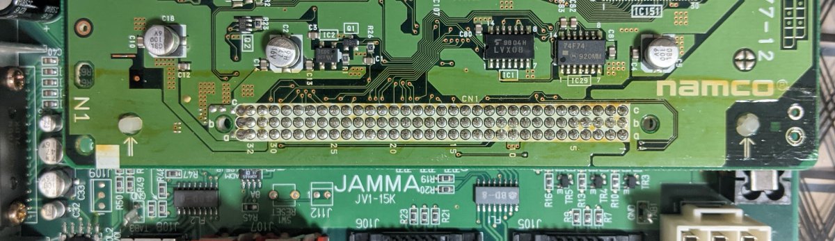

S sik- Beginner Joined Sep 5, 2021 Messages 12 Reaction score 9 Location Japan Aug 15, 2022 #1 I haven't had any issues with this Mr. Driller PCB since I got it, but I was just curious what exactly this discoloration may be from. Attachments PXL_20220815_124635354.jpg 122.5 KB · Views: 101
skate323k137 Enlightened Joined Jul 23, 2015 Messages 2,492 Reaction score 3,010 Location Michigan Aug 15, 2022 #2 Likely Flux residue from manufacturing, you can try 90+ percent iso alcohol and cotton swabs to remove it if you want, but I'm not sure if I would bother with the mess. Last edited: Aug 15, 2022
