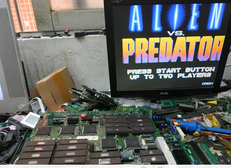

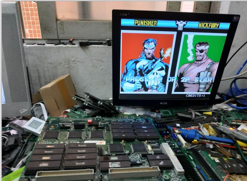

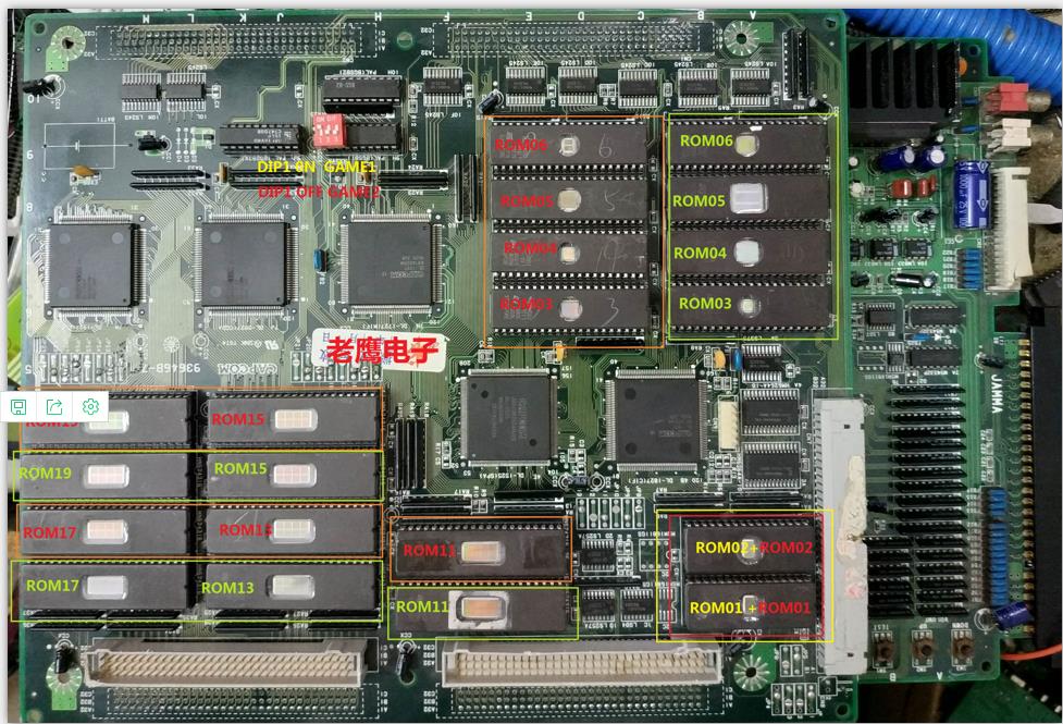

lydz Enthusiast Joined Apr 12, 2018 Messages 111 Reaction score 182 Location china Aug 24, 2018 #1 Alien vs. Predator (Japan) & The Punisher (Japan ) Attachments cps2 rom.jpg 163.1 KB · Views: 771 1.jpg 82.8 KB · Views: 440 2.jpg 94.4 KB · Views: 488
PascalP Legendary Joined Jan 17, 2016 Messages 5,669 Reaction score 3,816 Location The Netherlands Aug 24, 2018 #2 so it is 2in1 CPS2? Does the Punisher have proper Qsound? @Darksoft what do you think? Last edited: Aug 24, 2018
Darksoft Staff member Immortal Joined Jun 12, 2015 Messages 12,342 Reaction score 18,600 Location Poland Aug 24, 2018 #3 its just double sided aprons with a dip switch used to switch between games. Used very often in system with dual rom/bios, but here at a bigger scale.

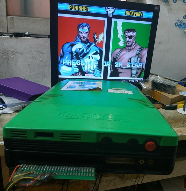

lydz Enthusiast Joined Apr 12, 2018 Messages 111 Reaction score 182 Location china Sep 3, 2018 #4 Mount the shell Attachments 1.jpg 48.8 KB · Views: 312 2.jpg 52 KB · Views: 306
