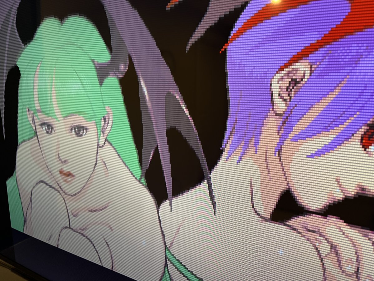

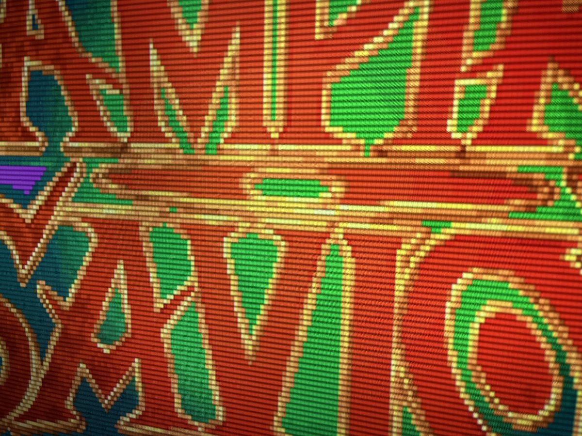

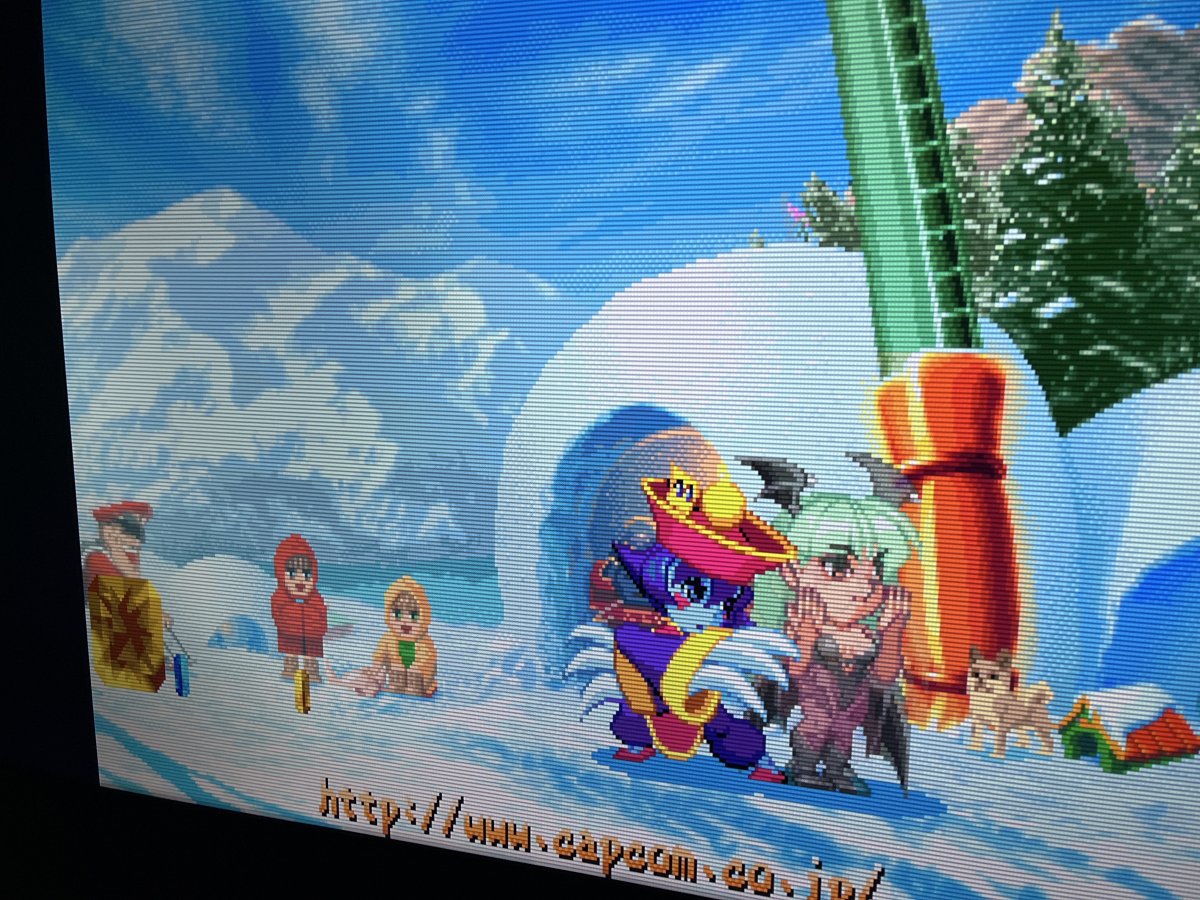

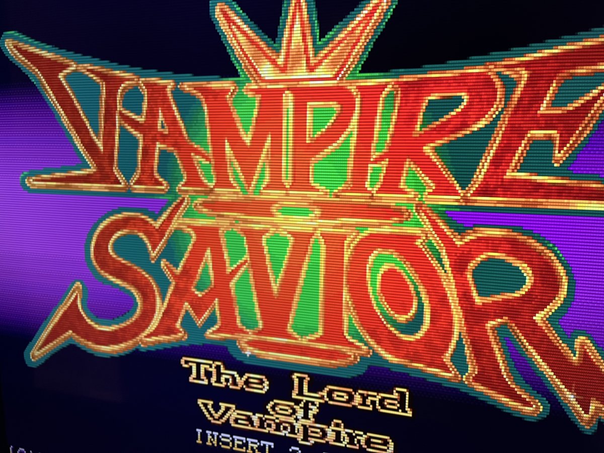

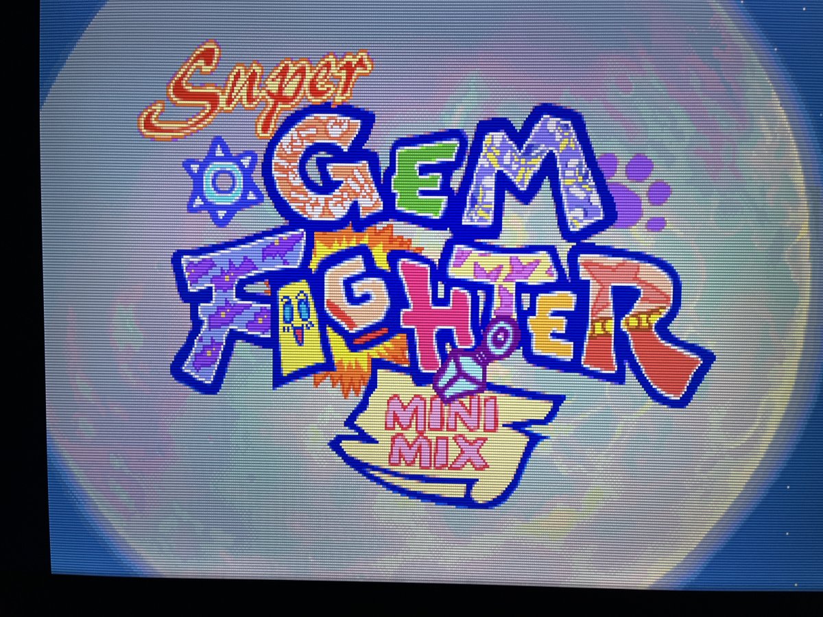

i have tried your settings and they are phenomenal. but i have a small bug, my setup is orig board MvC with phoenix edition ROMS and HAS 4.1.
As soon as there is movement on the screen, a vertical line is visible, the upper and lower half of the picture are no longer in sync.
I only get this fixed if i use a resolution other than 384x240. My TV cannot 5x 1600x1200. I only get a picture when I use 1920x1200 (1920x1080 does not work either, the picture freezes).
any suggestion? Thank in advance
here are a few pictures: (yeah i know my LG OLED is crap, have burn ins and the colors are way off :))
No idea re: your vertical line problem, but your pixels do look amazing. :D. Glad these settings mostly worked for you.
My guess is you need a Line5X capable display to get the full benefit & likely eliminate your issue.

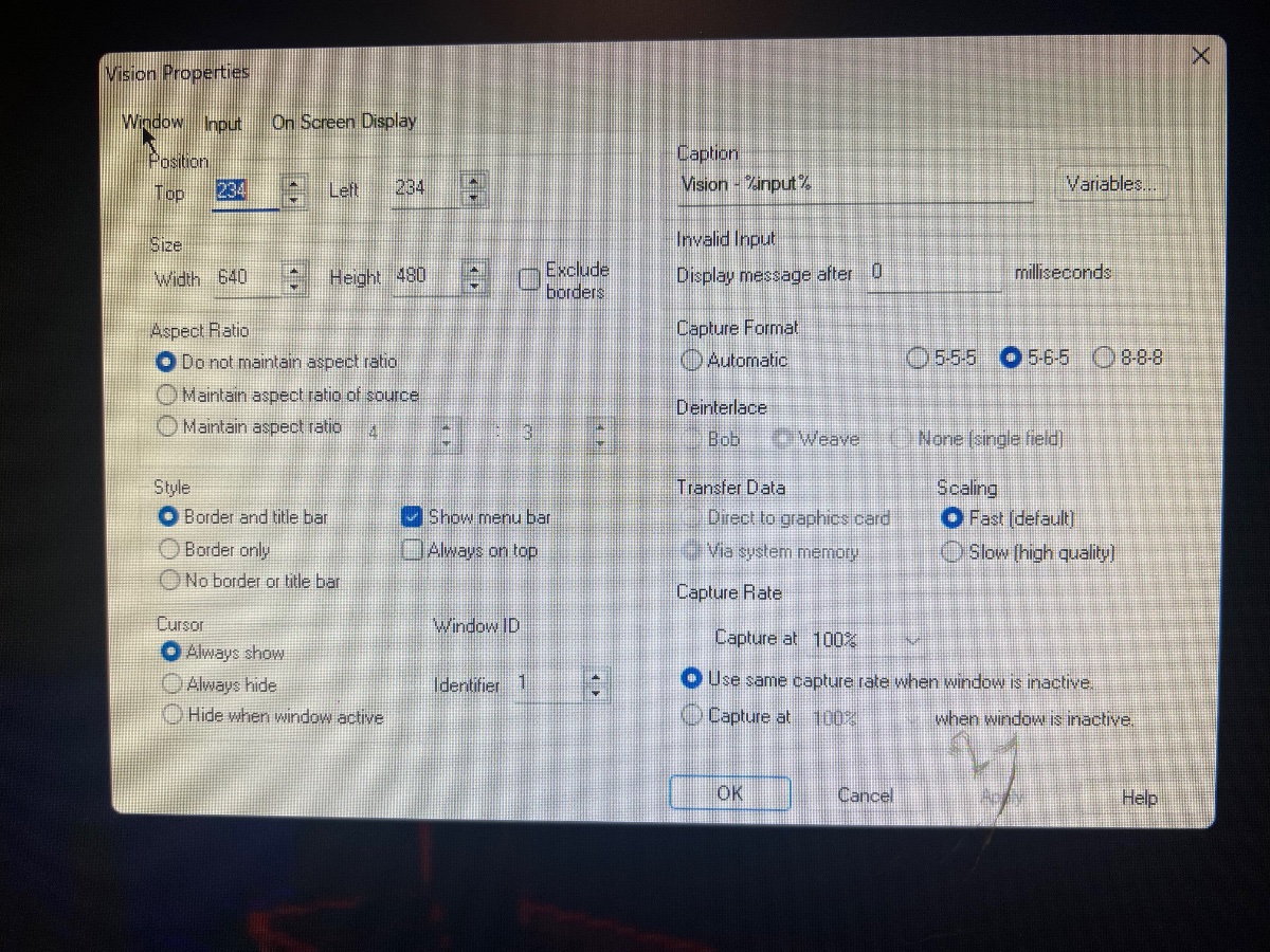

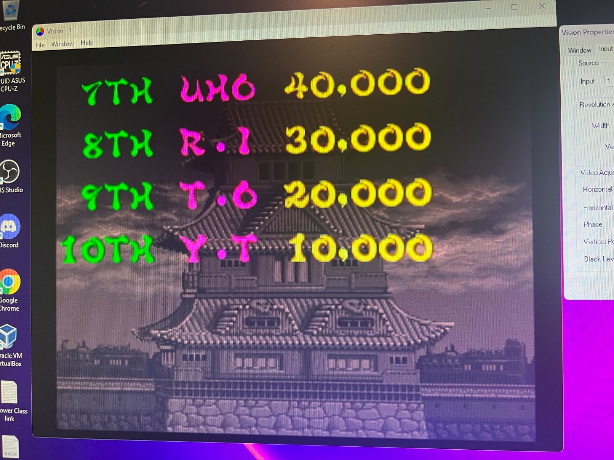

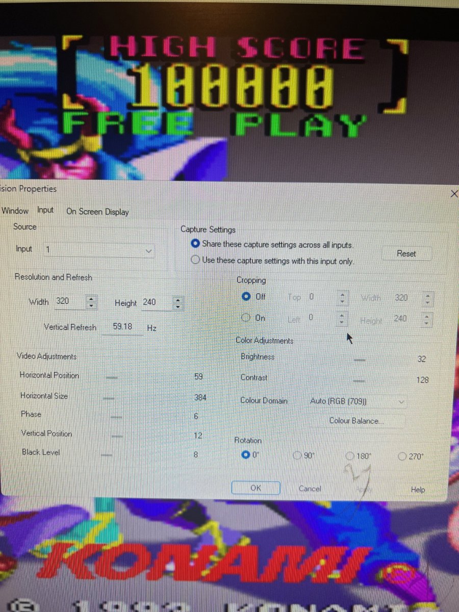

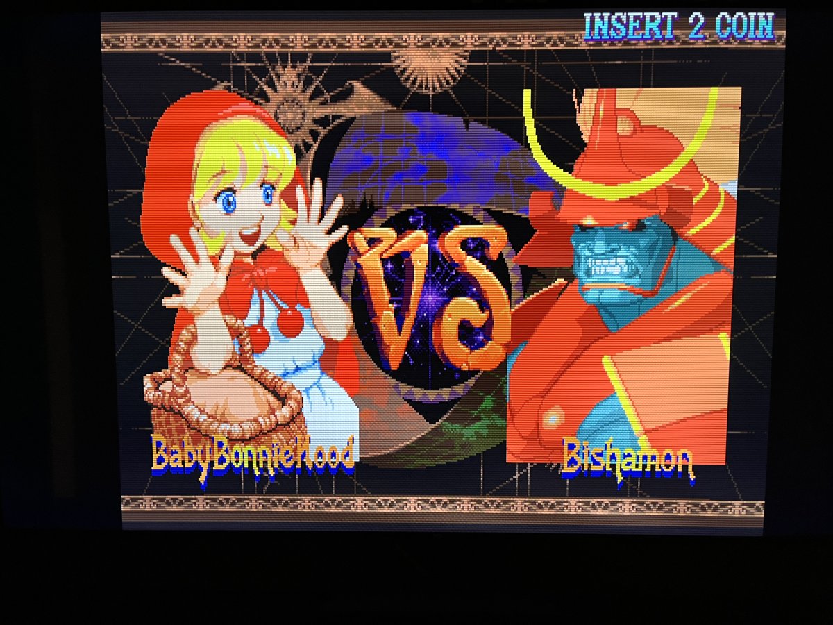

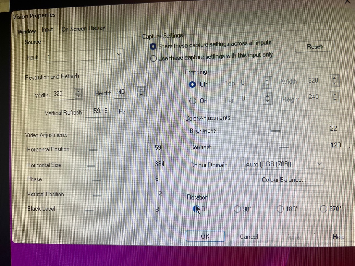

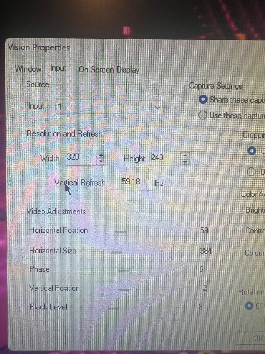

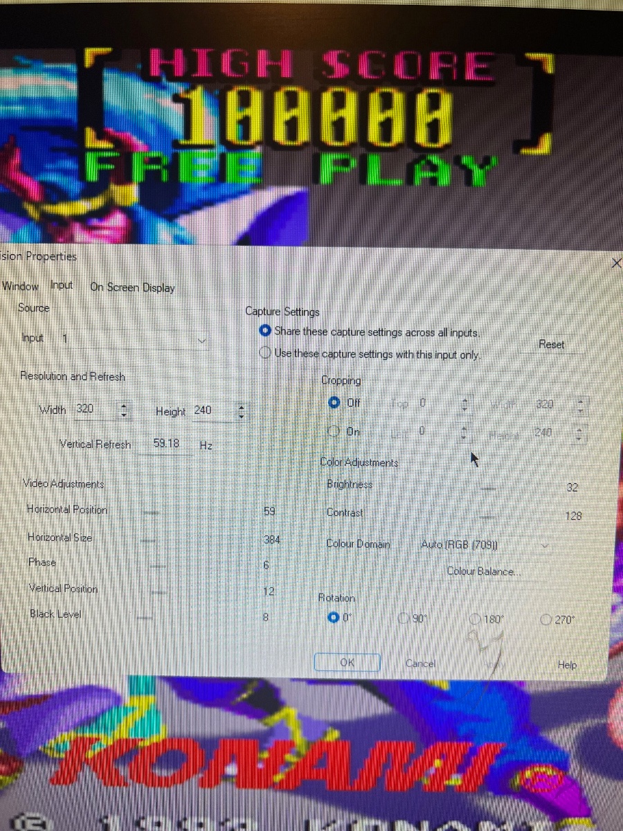

Honestly I tried and I couldn't quite figure out how to translate them into the 4k settings. Here is what I was working with, but I think your settings are better.
At first, I felt like I got it close to what you have.

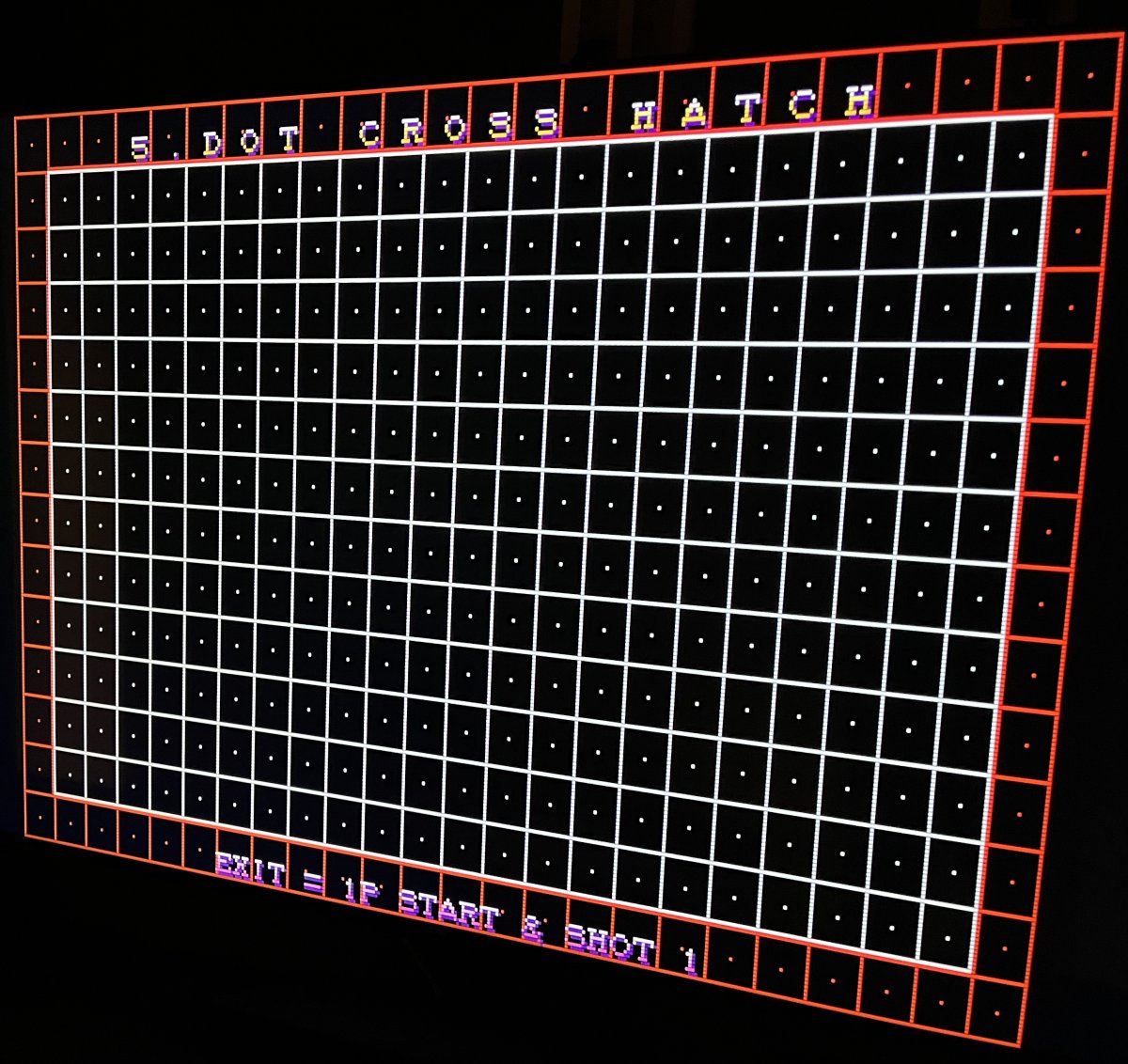

From a distance looks perfect.
Up close not bad, look how young Ryu looks!
You can even see through the damage on the health bar and it looks crisp.

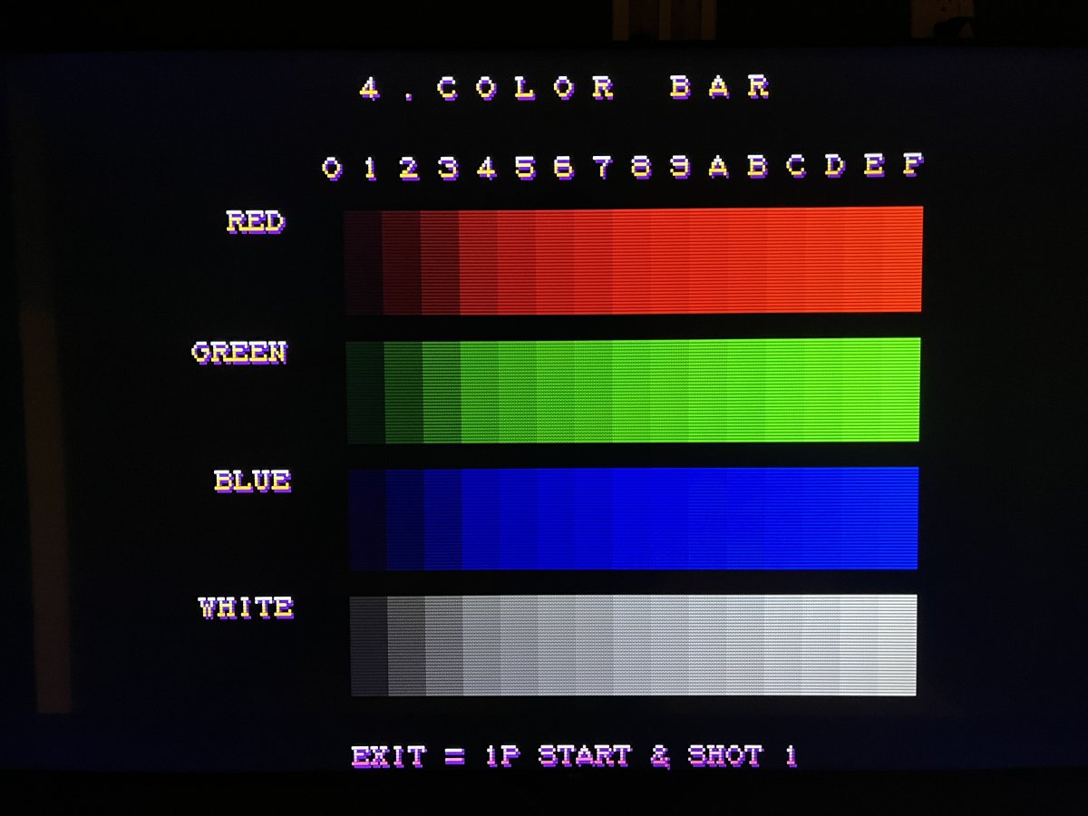

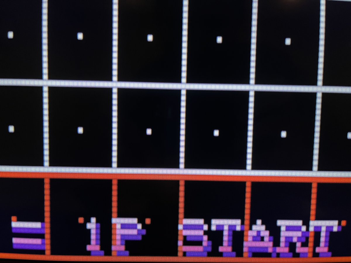

But things start breaking down on extreme zooms.
Can you see how the white bar looks sharp, but when zoomed in, the pixel count is wrong and one row is cut in half? Yeah, that's not pixel perfect, so I'm not there yet.
