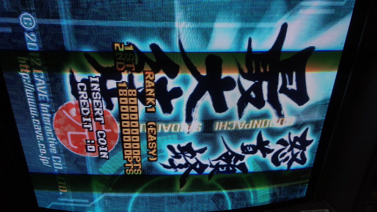

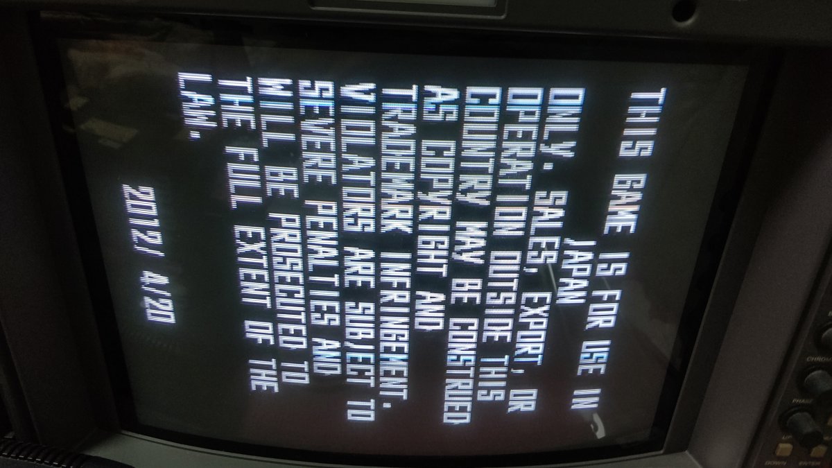

it's an original rom from SDOJ PCB to DDPDFK PCB.

This is a bootleg/conversion. I know someone with a legit SDOJ PCB with the same serial number. CAVE didn't put the same serial on two PCBs. There are 4 other features of this PCB that mark it as fake as well, but I don't want to publically list all of them because it will just aid bootleggers in the future.
Compare the serial number labels:
LinkArcade's fake PCB (note the slightly larger numbers in the serial, this is a big red flag):
The legit PCB owned by someone I know:
The person I know says he bought it from Suruga-ya. Since they post pictures of the PCBs online when they put them up for sale, it would have been easy for someone to find it and copy it for use in a conversion.

To be Fair this is a "conversion" not a "bootleg".
In the arcade realm bootleg implies non-original PCB, while a conversion is an original PCB and usually original code, just from a different game.
This is an important distinction because with a conversion (particularly one like this) there is arguably 0 difference between an original and a conversion in terms of the quality of the hardware and the accuracy of the gameplay.
Essentially, this was another official Cave game that someone reflashed to a different game.
Just to be clear
1. it's still really shitty to attempt to pass it off as an original and try to fetch the same price as an original
2. It's arguably still worth as much as the original game that was flashed over... just not the $5K being asked here.
I'd really like to know more details on how to identify bootlegs of such a rare, costly board besides the paper serial number tag.
Sound ROMs can't be re-flashed without removing them from the PCB so if there is evidence of re-work on them (like shiny new solder and flux residue) then that's a red flag. (and appears to be the case on this PCB)
Similarly the CV1K boards had a "B" variant which had half as much RAM as the "D" variant, where SDOJ was a "D" variant game and requires higher memory it's possible that chip was reworked as well to upgrade it. There are some other details too that I suspect but am not as well versed in to expound upon.
Really the CV1K games all run on identical hardware and are just flashed from the factory with different code, so aside from the "paper serial number tag." there's not a whole lot to go by, but again, as a conversion, there's not really any material difference between a conversion and an original either.
On a whole though there are few enough of these pcbs that hardcore cave collectors generally know who owns which serial number in the scene so if one pops up that has the same serial as another with a known owner that's a pretty obvious flag.
