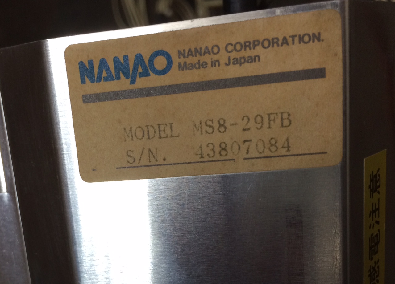

RealMFnG Legendary Joined Mar 27, 2016 Messages 5,032 Reaction score 4,558 Location NorCal Feb 19, 2019 #1 I have seen MS8's in Astro City's before. But no idea if the PSU in Astro's have isolation circuitry in them. Anyone know if MS8's require ISO transformers? This particular MS8 came out of a Tecmo Kyotaro29 project cab. Thanks!
BanishingFlatsAC Champion Joined Sep 28, 2017 Messages 1,136 Reaction score 1,317 Location Boston, MA Feb 19, 2019 #2 As long as those monitors are running on 110 (120 is fine), they do not need an iso transformer.
B brad808 Professional Joined May 1, 2016 Messages 367 Reaction score 398 Location Ontario Canada Feb 19, 2019 #3 You can see vid I made to easily tell in future if you need iso. Hopefully it helps you
RealMFnG Legendary Joined Mar 27, 2016 Messages 5,032 Reaction score 4,558 Location NorCal Feb 19, 2019 #4 That is a good video sir. Thanks! No ISO is needed for the MS8 then.
