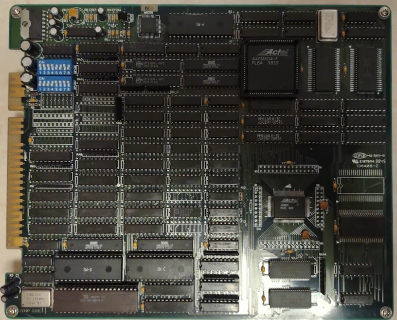

I've seen inexpensive PCBs of games that were originally on the IREM M92 platform.
They are single PCB, and all share a very similar design.
I own 2 of these PCBs, soon to own a 3rd. They work well, but there is a little jank.
I own Hook and Ninja Baseball Bat Man in this form factor. I'm not a huge fan of either game, so only very obvious differences jump out at me.
I have an In the Hunt on the way.
From what I can tell, these PCBs are of Korean origin.
My first thought was bootleg, but I find it interesting that the In the Hunt title screen says 1998 instead of 1993.
This is an image of the In the Hunt I have on the way.
In the Hunt 1998
Does anyone know anything about these and where/why they originated?
I'm just curious.
Thanks.
I've seen a few of them and my impression is that they're bootleg clones of varying quality. The worse ones sacrifice some of the music and animations from the games while the better ones retain most of those details but still run slightly slower or faster than the OG hardware.

Thanks for the reply. I'm a lot more familiar with In the Hunt than Hook or NBBM, so I'll post any differences I find.
In the Hunt bootleg arrived last week.
It's the Japanese version; so, it's actually Kaitei Daisensou.
The construction of the PCB seems pretty good.
There were some issues with it, when it arrived. Applying De-Oxit to all removable parts and sockets cleared everything up.
I usually apply de-oxit to most of my PCBs, when I first get them.
Apparently, this PCB contains 2 FPGAs (Actel A42MX09-FPQ100 and A40MX04-FPL84)
One of the removable parts is an NEC V30 processor, running at 10mhz, that is Intel 8086 compatible.
The other 2 removable parts are 2 of the game ROMs.
This PCB is pretty cool, but also a little frustrating.
Before I begin talking about gameplay, I have to state that I have NO experience with the original PCB.
My only experience with In the Hunt / Kaitei Daisensou arcade game comes from MAME and FBNEO.
While I am a fan of these games, I am not an expert.
The first thing I noticed is that the aspect ratio is slim from left to right. I am running this PCB on the Minigun Supergun to a Sony Consumer CRT. There are pretty thick bars on the left and right sides of the screen.
The Hook and Ninja Baseball Bat Man bootlegs are exactly the same.

Because this is Kaitei Daisensou, and not In the Hunt, the levels are played in this order: 1, 3, 5, 2, 4, 6.
The frustrating part - The game runs at a decent speed; until you press the fire button. Pressing the fire button causes the game to slow to Metal Slug 2 levels slowdown. The slowdown does not seem to be related to the number of sprites or objects on the screen. It's almost like a switch is thrown: fullspeed / slowdown. When the game is running slow, it runs consistently slow. The speed of the slowdown does not vary. Adding a second player, or more enemies does not impact the speed of the game; firing your weapon does.
I don't believe the slowdown is related to input reading, I believe it's related to a specific sprite appearing on the screen. This is just how it seems, to me. I need to pay closer attention.
Even with the slowdown, I still enjoy the game. That said; I'd enjoy it more without the slowdown.
I'm wondering if it's possible to change the oscillator(s) and possibly speed things up a little bit.
I'm also interested in playing this ROM in MAME. I haven't seen it anywhere. It may not be dumped.
The PCB has 2 ROMs that are socketed. They are labeled SW-B and SW-C. SW-A seems to be the same type of ROM but it is not socketed.
SW-D, SW-E, and SW-F are a different type of ROM from SW-A, SW-B, and SW-C.
I dumped SW-B and SW-C. They are 128KB in size. They closely match ith-l1j.bin and ith-h1j.bin, from the mame romset, respectively. Each file has 333 Bytes difference, in roughly the same location in the file.
If anyone has advice on overclocking something like this, or dumping the rest of the SW chips, I'm interested in what you have to say.
If anyone is thinking about buying one of these, now there's some information about them. I couldn't find anything before I made the purchase.
