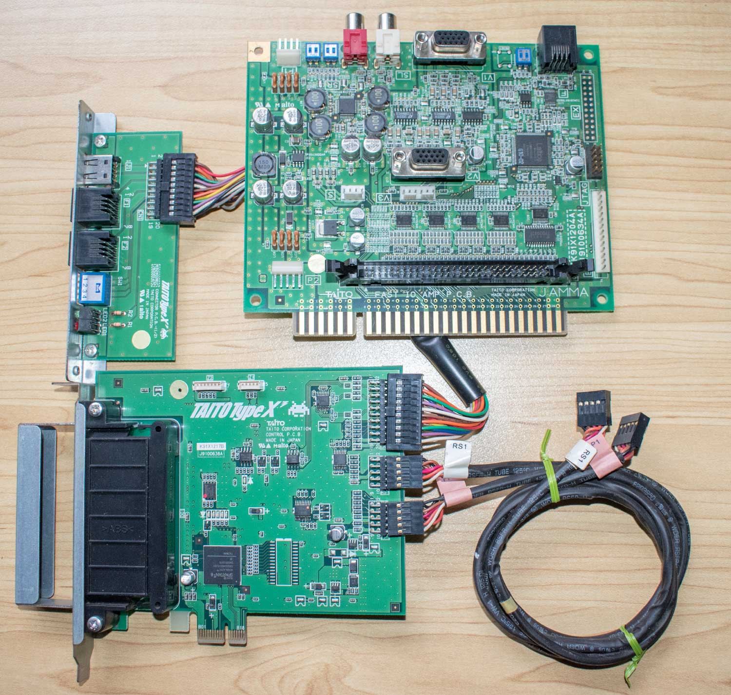

Does this IO work with Taito Type X 2 / Niko Multi?
Cookie
Oct 8, 2019
85
234
123 Sesame Street
EDIT: Yes, this IO does work with the NIko TTX2 multi.You
It doesn't have the drivers for this piece of hardware installed inside the image.
You will need the attached 32 bit drivers on the hdd to make it work. You'll need to unlock nikos multi to install the driver and that's it. It will work with FASTIO only, NOT JVS.

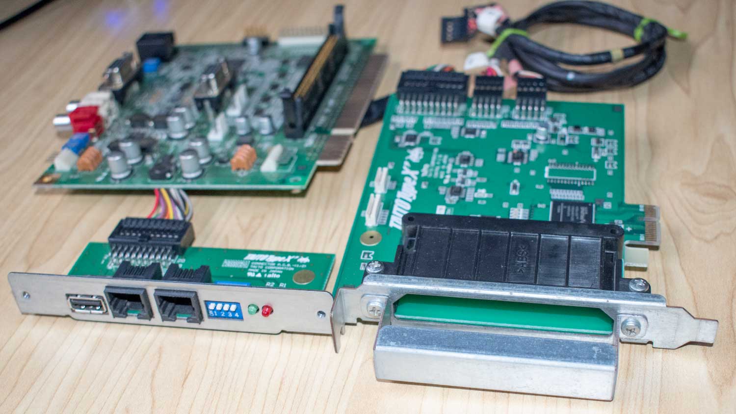

- Type X 3 PCI-e card
- Type X 3 IO daughter card
- Fast IO JAMMA card
So basically, it's a FAST IO JAMMA card with the FAST IO controller boards from a Type X 3.
From everything I read on other threads, the TTX3 boards don't work for general TTX2 systems, so if I plugged this in with my original SF4 Ultra HDD and dongle, it wouldn't work.
But I read there is a way to make it work on the NIKO multi for TTX2. I just can't find info how.
I know the JAMMA board will work on TTX2 but it generally needs a TTX2 PCI-e FAST IO card which i don't have, i only have the TTX3 fast IO PCI-e cards.
Can anyone give me a definitive answer on this? Will I be able to make this IO setup work in my TTX2? Or do I have expensive paperweights? If yes, can anyone point me to a thread maybe where it's detailed?
EDIT: Drivers found.
View attachment TTX3_idmac_drivers_64bit.7z
View attachment TTX3_idmac_drivers_32bit.7z
Thanks in advance :)
