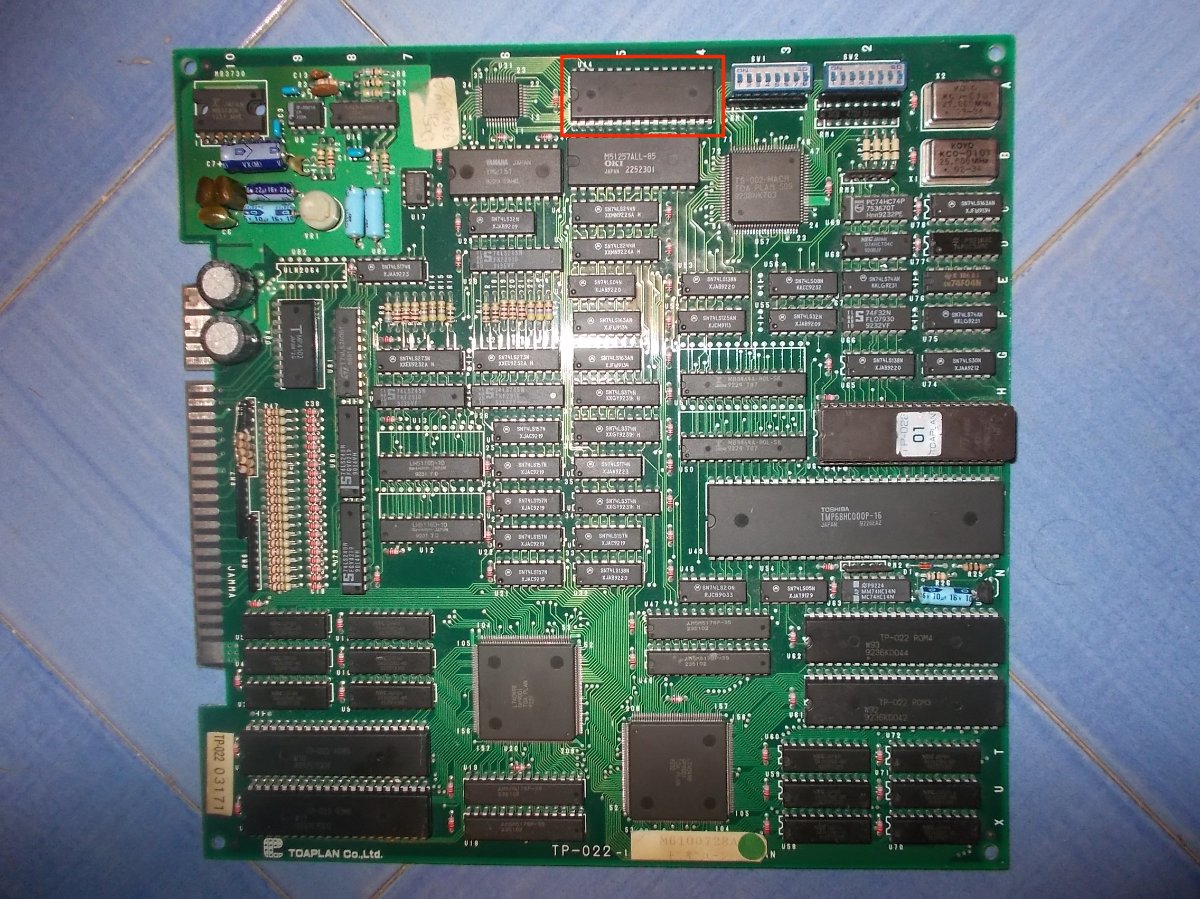

Hey, i have strange audio problems with my Dogyuun:
After coming back from the repair i still have missing sounds with my Reijin Supergun setup
Sounds 1-7 work but then 8-13 are missing, 14 works again etc...
Rest plays fine, including the game itself.
My modder says it worked fine (and i believe him)
He used the Supergun Mak Strike v3
Any ideas?
If he really tested those sounds and worked well for him and the board did not get damaged during transport, then I'd check the +5V on the Jamma. I don't think that this game needs -5V but worth checking. My guts tell me that he tested it but not as much in detail as to notice that some tunes work and some dont.
The symptoms you describe make me think one of the address lines for the ROM that stores the sound samples isn't functioning. Could be a broken trace or corrupted ROM. The ROM is labeled "22" and is located at position A5 on the board - check it for broken traces.
