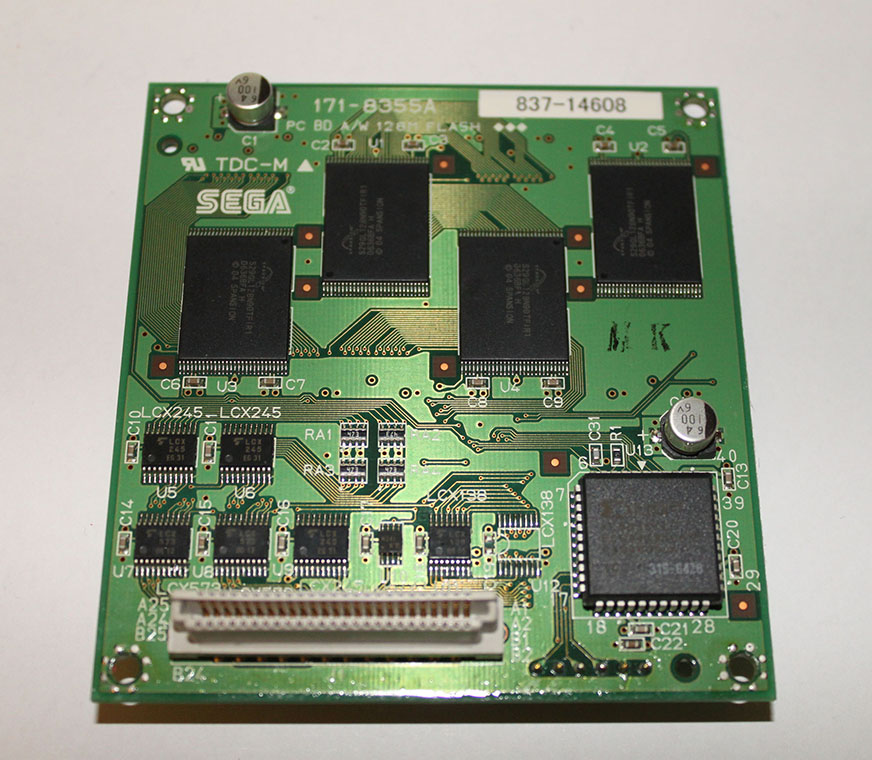

without a label the case is a dead giveaway. Original cases are completely smooth under the label, bootleg cases have a big ugly circular defect in the center from a vent hole in the molding process. If you have a cart in your hands you can feel this through the label too.
Also most bootlegs have square label corners instead of rounded like the original and most are also missing the holographic sticker. not all originals have the holo sticker though and some bootlegs do have high quality rounded corners and replica holo stickers (but it seems pretty rare).
It's super easy to tell a bootleg PCB if you get PCB picks too, bootlegs generally look like bootlegs with jankey soldering and chip numbers scratched off, chinese stickers etc.
Bootleg PCB:
Originals usually have "Sammy" or "SEGA" silkscreened on the PCB and the chips and use really fine pitched ROM chips. the PCB quality and design is similar to other NAOMI era stuff; it's pretty distinct:

Here's a collage of the 3 pics I have. Looks like an original PCB with repro shell and sticker...

I went and looked through my folder of bootleg cart photos and see now the serial number in the photo above is the same as the original run of bootleg cartridges. Might even guess the seller is just playing a bait and switch and djsheep will get a bootleg cart pcb too.
2. It is a repro shell, originals dont have a sprue on the top label area
3. Nah, the sammy roms are one-time programmable chips.
