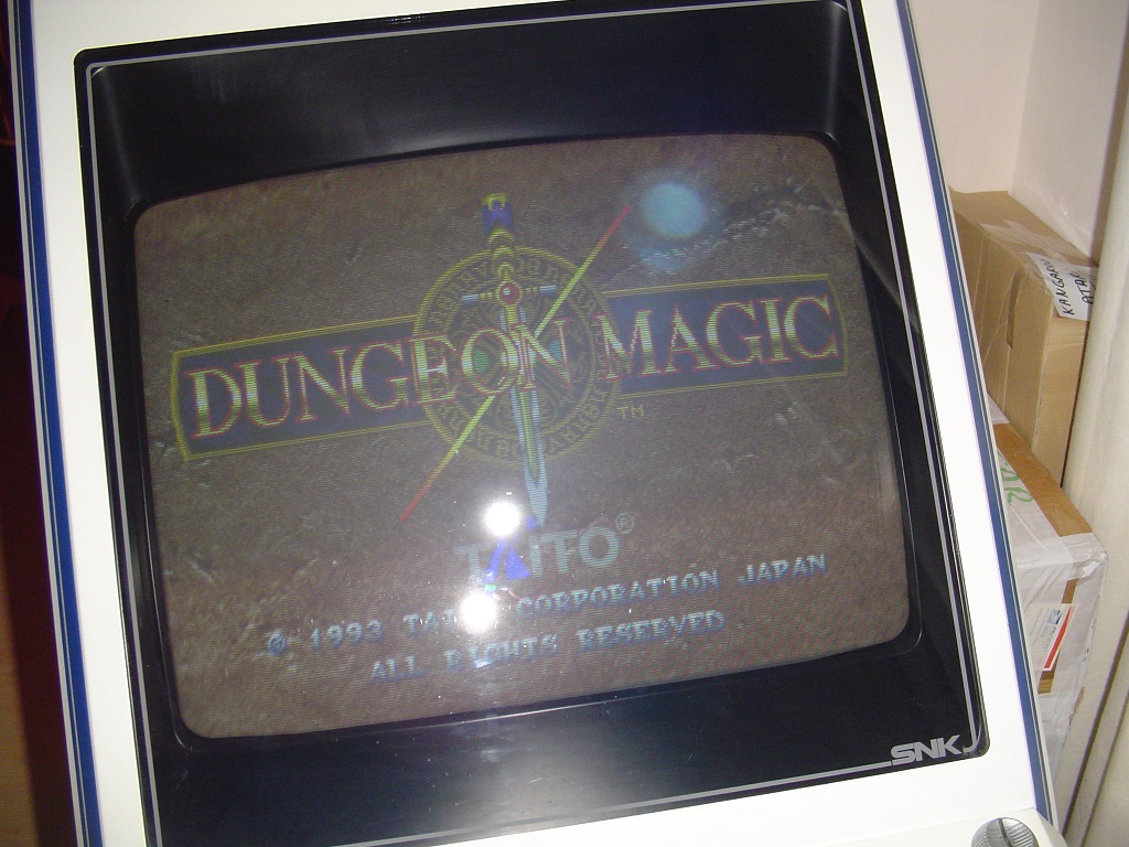

-title screen now says "dungeon magic" and no more "lightbringer"

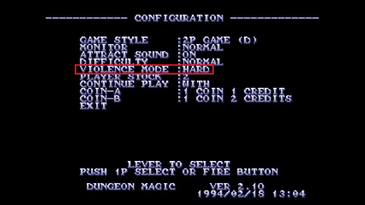

-a new line appears (in dungeon magic) in the option / dip setting: "VIOLENCE MODE". :evil:
to have blood, simple put the violence mode on "HARD"
