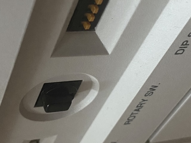

You have the old version of the hex wheel
There is a new one on the updated dev kits that don’t have the stock out wheel . See picture
To be honest I think the best is just to get a new wheel and repair the board. I have a few dev kits here and the market is to small to go that route of making a new pcb. But if you really want to go that way you have 2 options
Solder everything of the pcb and scan it or draw the lines in cat and design the pcb.
Maybe if you google the katana manual you can find the layout and parts of the pcb
or you can send me the parts and for a little fee i fix it for you.

no, I have the version with the black cap on the encoder wheel :)
I replaced the encoder wheel with an identical version but with a longer shank.
But the imprint of the rod is not compatible with the original cap.
I am going to depopulate the pcb, to scan it.
if after somebody complete what is missing.
But another region selection solution would be an extra project:love:
